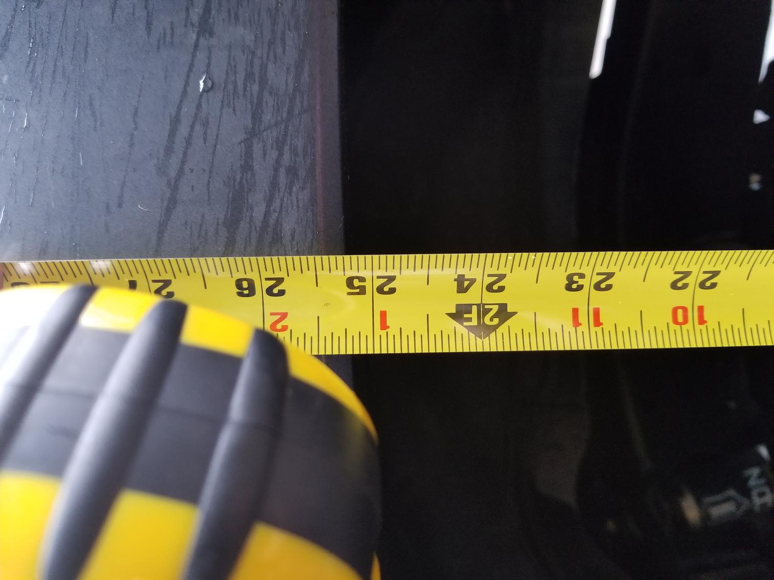

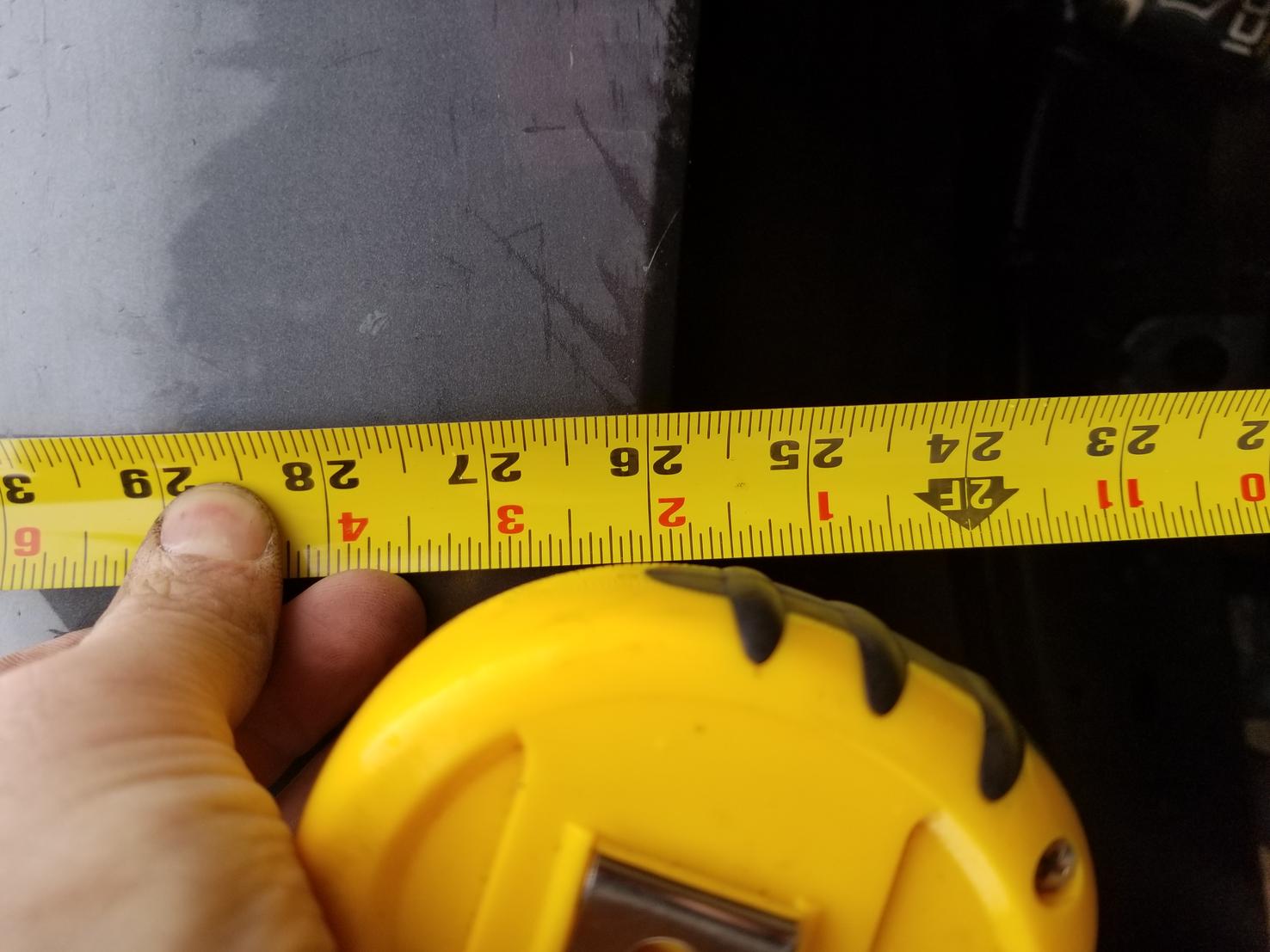

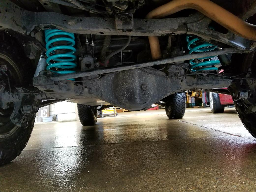

Just installed my 59-577V springs. I had Radflo 2" with 1/2" spacer on passenger side and 1" on drivers (to help with lean and give me slightly more lift). I also have a 1/2" body lift.
I sat at exactly 24.5" on both driver and passenger rear with that set up.
I now sit at 25 3/16" on drivers and 26" on the passenger side. This is with a 10mm OME trim spacer on the drivers side to help with lean.
Springs ride great! I like them much better than the Radflo 220lb springs. They were not super fun to install because they are very tall when uncompressed. I disconnected the sway bar links, lower shock mount and the upper links to get them installed with no spring compressors.
I am going to drive it for a week or two until my Radflo long travel shocks show up, then depending how it settles I'll toss in a bigger spacer on the drivers to get it level.

That's great, looking good. Yep, that's the same method I've seen other people doing too for these long coils.
How's the axle sitting side to side with that much lift. Let me know if you need a rear panhard rod, we have those too.
I will look, I got the springs in and never checked side to side. How much is the panhard bar?

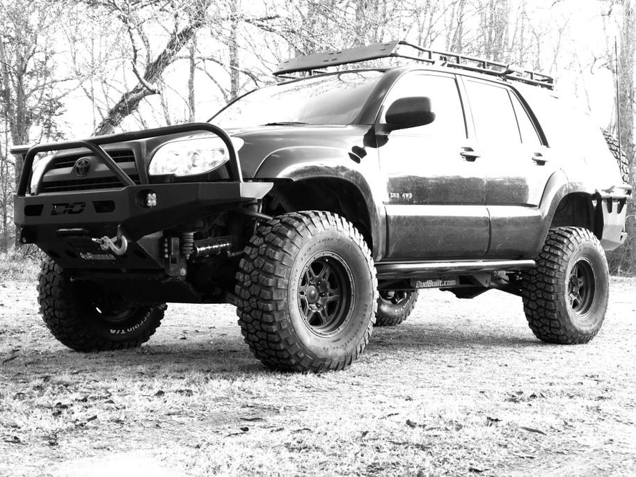

I'm currently investigating this, as it definitely shouldn't be as described here.
Here's another 4th Gen with the same 701V installed and 600-800LBS of rear weight, maintaining good fender clearance and lift height.
