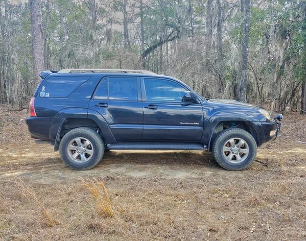

I'll add a shot of my setup for reference here. I have a 4wd V8 model. I went with the C59-302 in the front with the C59-505 in the rear. Unfortunately, I never took any before or after measurements. I thought about doing the 599's in the back to keep things a little more level, but I decided to go a little taller to keep from squatting with a load. I'll add that I don't mind some rake, and I totally despise a squatted look whether done on purpose (dumb) or loaded down (avoidable). Thanks to Mike for good communication with my order. Amazon was showing more stock than what was available, so he gave me the option to go with another color if I wanted. I was in no hurry and told him to wait until the teals came in, which ended up happening at least a week earlier than expected.
what shocks you running?
Billy 5100's. The ride feels great, by the way. I went from an XREAS setup (still functioning after 218K) and I definitely feel like it's an improvement. Firm without being harsh, yet still pretty compliant when things get bumpy.
Edit: I also went with 2nd gen rear sway bar end links. They're about an inch longer than stock, so I think that helps keep the swaybar from being bound up with the extra height in the rear.

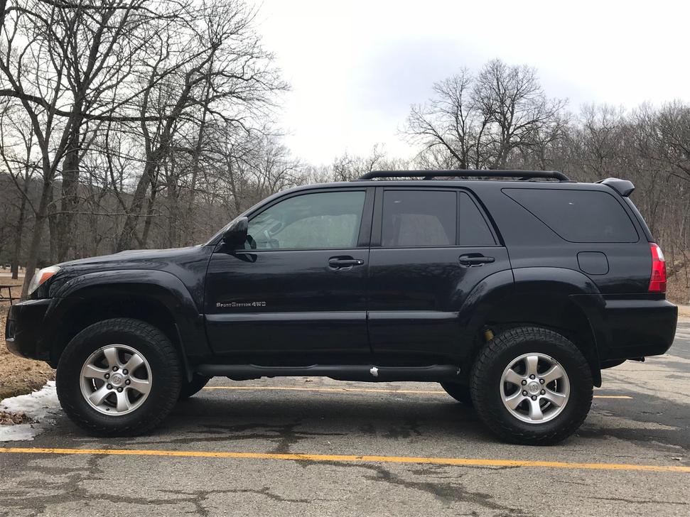

I had my setup installed for a few hundred miles now. Overall, I'm generally happy. Mike was great to work with and answered all my questions. The fit/finish/quality is top notch.
I ended up with the:
C59-302 front springs
GS59-221 front struts
C59-505 rear springs
GS59-637 rear shocks
Dobinson's installed my front struts and coils before shipping and I dropped them off at my local mechanic for install. A day later, I had my truck back with the new lift. As a point of reference, I've got a 2006 V6 sport with 142,000 miles and a Daystar lift. The XREAS was in need of replacement so out it went along with the spacer lift.
To me, the height is right on where I want it. Handling is excellent. The lean around corners has been virtually eliminated. I will say, I might have a poor point of reference since this is my first lifted vehicle but the ride leaves something to be desired. Obviously, this is very subjective but in town things are pretty firm. Mike and I have discussed that the angle of the stock UCA's leads to some stiffness in the front but the rear is where I feel things more. Unloaded, it tends to bounce around quite a bit and on our frost heaved roads its uncovered every knock and rattle my car has. Maybe I'm a good candidate for the softer valved shocks or need to add some weight to the back to settle things down.
replacing the rear sway bay links with the longer 2nd gen links.This will allow the rear coil to extend. Now the taller coil is being preloaded by the shorter sway bar link andi think thats whats affecting the ride in the rear.
