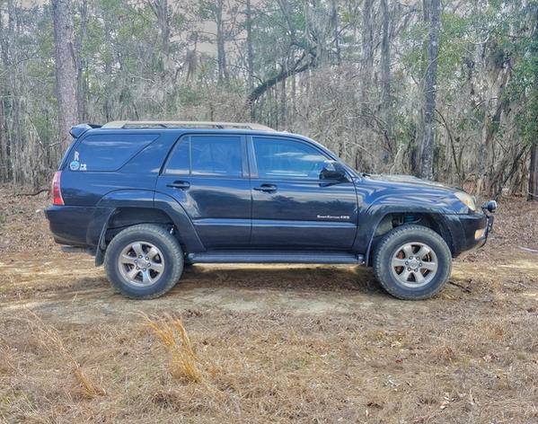

Without any constant weight, I'd suggest these parts
C59-300
GS59-221
C59-505
GS59-705
505's with a bit of rake is a good idea, for when you load up or tow. And the GS59-705 will provide a softer on-road ride, especially since you're running empty.
And also, lots of guys running the C59-302's have a V8, so they need the extra coil height to support the extra weight. This photo attached would be the closest I have saved with about the same lift that these parts would give you.

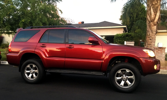

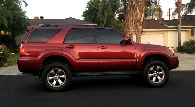

old set up:
front: FJ springs/shocks DS 1 inch: 36.5 (may have been higher since the shocks were blown and saging)
rear: FJ springs 4R shocks DS 1.5 inch: 38.25
new set up:
billy 5100 set at 0
front: 302: 37.5
rear: 505: 38.5
thanks mike for the help and set up. slightly higher than i wanted in the front but i am ok with it. been driving around for a week now and the springs are starting to settle in. firm but not overly harsh.
i love the stance. its level to me since i base my level on the running board, having a reverse rake running board doesnt look right to me. the pictures dont look level (my son took them, i'll post more up later)
