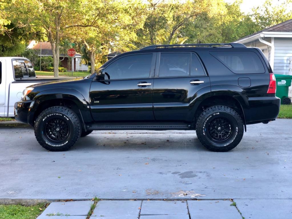

Just received these photos from a local customer [MENTION=144930]Prestige458[/MENTION] that I've been working with for a few weeks to get his 2006 4th Gen 2WD SR5 V6 lifted to exactly the stance he wanted. The 2WD does use different front coils, so we had to look at some coil options and do some math to get him to the correct height. "As close to level as possible" was his desire, and here's what we got for him.
Part numbers:
C59-134 front coils
GS59-221 front struts
C59-599 rear coils
GS59-705 rear shocks
Resulting in 2.5" front and 1.0" rear.
Part numbers:
C59-134 front coils
C59-599 rear coils

Thanks for the post Mike. I love how it rides and the lift is perfect. Thank you for everything. I will be posting some more pics when I get a chance. Thinking of getting it dirty this weekend

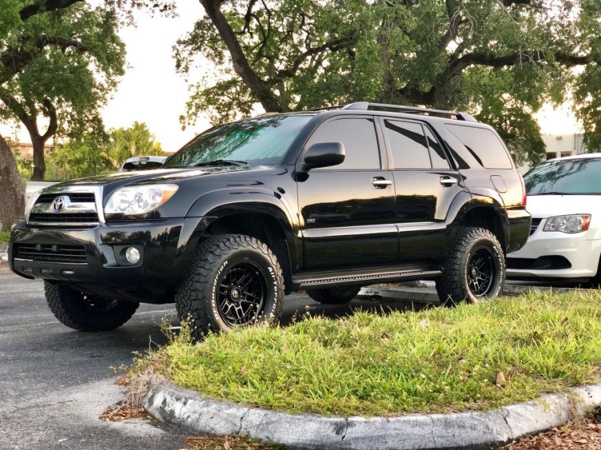

Thanks for all your help Mike. I finally got the setup installed and it came out awesome.
Height as measured from the center of the wheel straight up to the fender.
Stock
FL: (did not measure)
FR: 18.5"
RL: (did not measure)
RR: 21.5"
Dobinsons
FL: 21.5"
FR: 21.5"
RL: 24.25"
RR: 23.75"
Just installed 265/70/17 BFG KO2 tires.
Thanks again Mike@Dobinsons.

Finally getting to posting picture of my before and after, in the excitement of installing I forgot to take measurements or install step images, I'm extremely happy with the end result and the feel of my setup.
