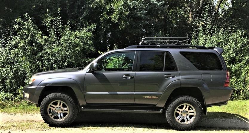

Finally got it right !
finally got it right !
