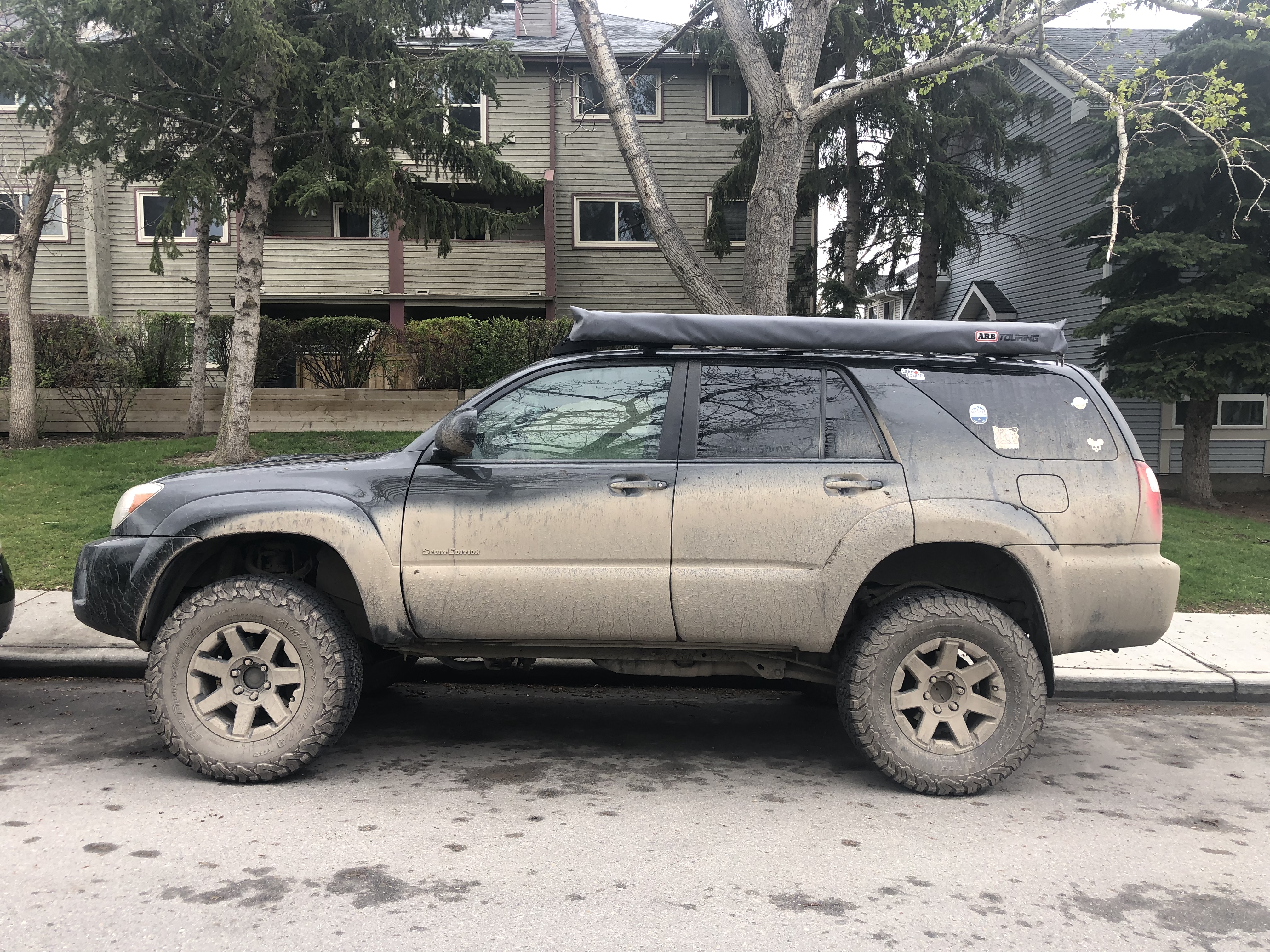

Going from XREAS (100,000 miles) w/ Daystar 2.5"/1.5" spacer lift and 265/70R17 tires to Dobinsons C59-677V rear coils with 285/70R17 tires I gained 2.9-3" hub to Fender and 3.5-4.5" ground to fender.

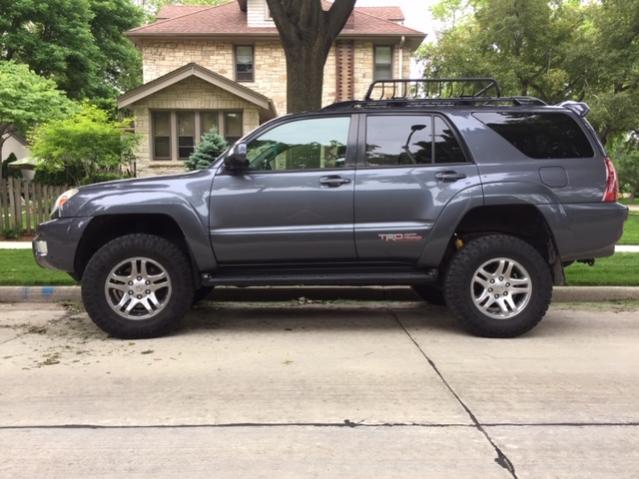

need your thoughts, will rear settle a little ? should I consider C59-505 or does it look fine the way it is ? Current set up is C59-302 up front and C59-325 in rear
Was this right after installation? It does look a bit taller, not yet settled.
