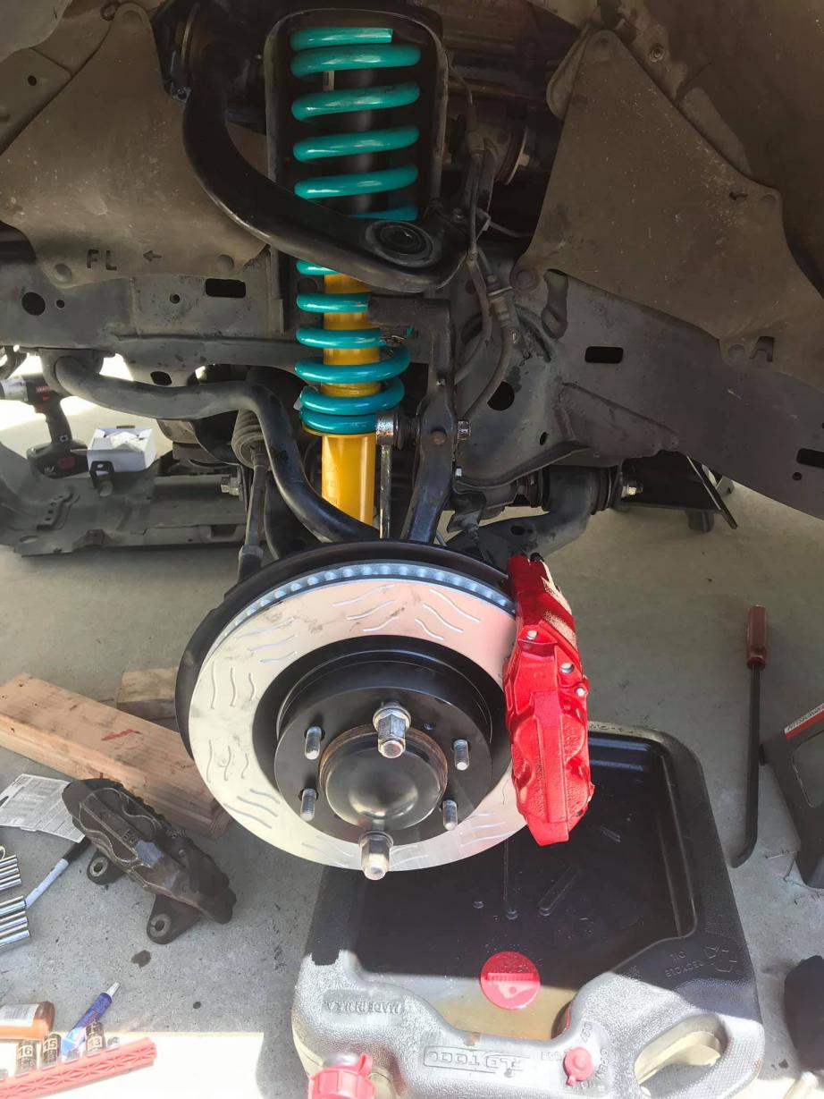

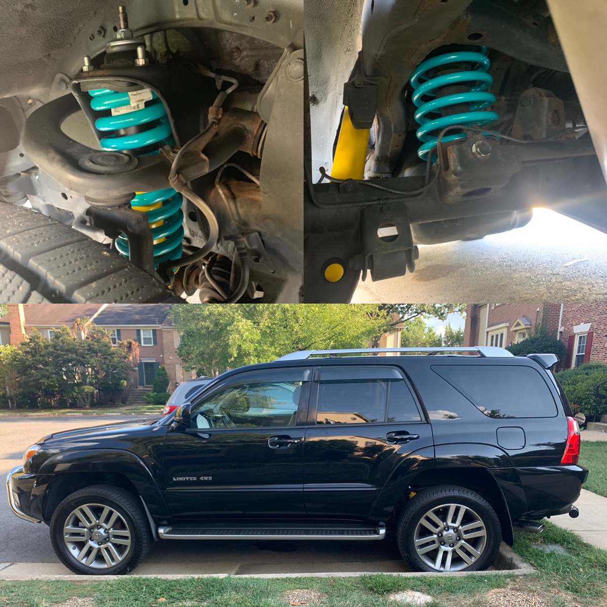

What did you pair the 323s with in the front? Pics?
I’ve got an 07 v6 4wd. I’m running the 323’s in the rear with Bilstein 4600’s. In the front I have KYB strut plus and a 1/4” spacer.
Passenger rear ground to fender is 37” with about a 1/2” - 1/4” driver lean depending on how full the gas tank is.
Front ground to fender is 35” both sides.
