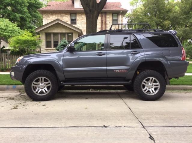

Just installed a Dobinsons lift kit on my 2005 SR5 V6 4WD and am thoroughly impressed! I have had 5 Toyota trucks, most of them lifted, and this suspension has the best feel. Slightly firmer than stock but it still soaks up bumps on the road very comfortably. I achieved the exact stance and amount of lift that I was hoping for.
Front: C59-300/GS59-221 (with 5mm driver spacer installed)
Rear: C59-505/GS59-705
Wheels: Fifteen52 Turbomac HD 17x8.5, Bronze
Tires: Kuhmo Road Venture AT51 265/65/17
Cheers to Mike for great customer service and a great product.

The lift difference between the C59-505 and C59-325 is around 1/2 in ? I would like to raise front than lower rear if possible
My current lift fender to ground in front is 37 in and rear is 40.5 in does this seem right ?? springs are seated correctly
