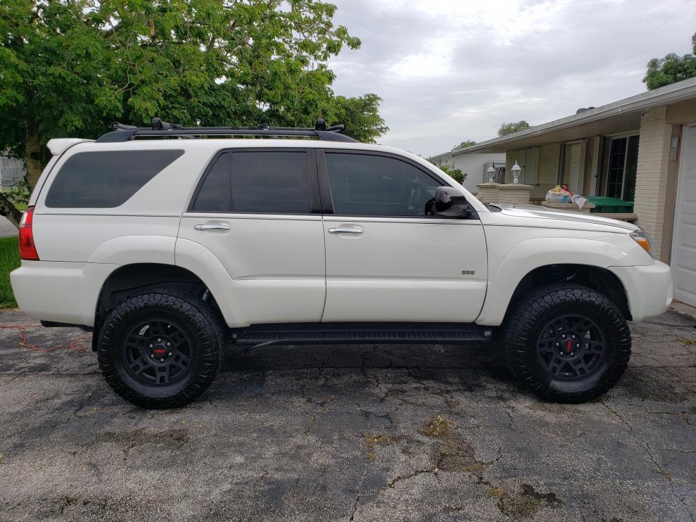

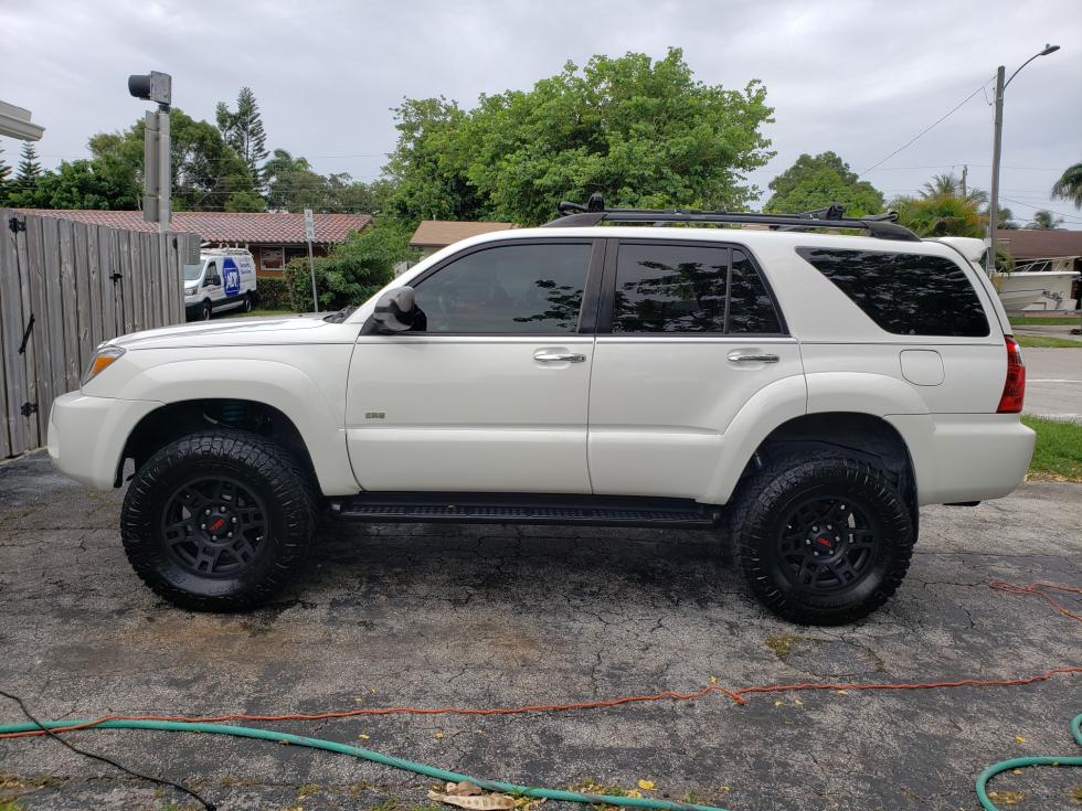

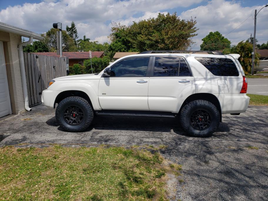

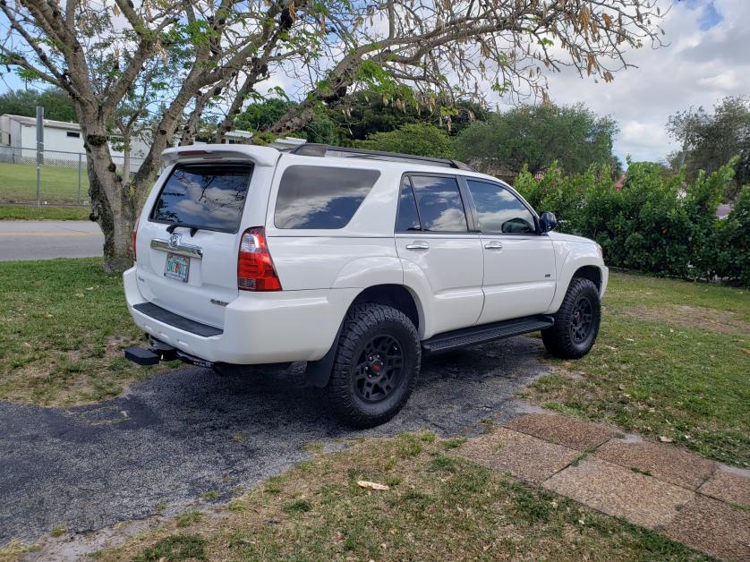

Hey mike its Gabriel (ozzie305) I decided to post some pics of my lift on here since I basically have all Dobinson products. For anyone interested in my lift. The car is a 2008 4 runner v6 2wd. So my lift numbers would differ from alot of you guys. My car currently has Toyota TRD pro wheels oem. With 285/70/17 Nitto Ridge grapplers. I also have spider trax 1.25 wheel spacers all around. Upfront I have bilstein 5100 with c59300 coil. I currently have it at the second clip. My hub to fender height upfront is 23". Also I have the Dobinson upper control arms installed. At the Rear I have the bilstein 5100 shocks with c59-677v. In the rear I measured about 24.5 to 25. Its hard to measure exactly with the spider trax so my numbers could be off slightly. I should be raising the car upfront very soon since Im not liking the rake. I want some slight rake but not this much.
Has anyone used the Dobinson 300 coils and bilstein 5100 on the third clip ? would it be safe? Am I better off buying different springs. At the moment Im not sure what direction to take. Im perfectly happy with the rear . Thats the look I was going for.
First 2 pics are how it currently sits.
Last two was before.. Front had dobinson c59300 with bilsteins at stock level and rear coils were bilstein 1.8" coils with the bilstein shocks. I was unhappy with the slight negative rake I got.

Do you have stock measurements? With the 300 being a 2" lift and the first notch a 0.85", you've exceeded the max lift the 5100 has been designed for. How does this set up ride?
My struts upfront were shot to begin with so my stock measurements wouldn't really be a good starting point but it was 18 inches wheel to hub. The car rides exactly the same from when I had it on the stock setting and the 300 coils ( 2 inch lift). That wheel to hub measurements were 22 1/2 df and 22 1/4 pf. So I gained about 1/2 inch to 3/4 moving it up to second clip. Being at 23 now. Another angle I was considering was maybe getting a 1/2 inch strut spacer. Im almost there lol just 1/2 to 1inch away from moving on to other projects on the car lol .
