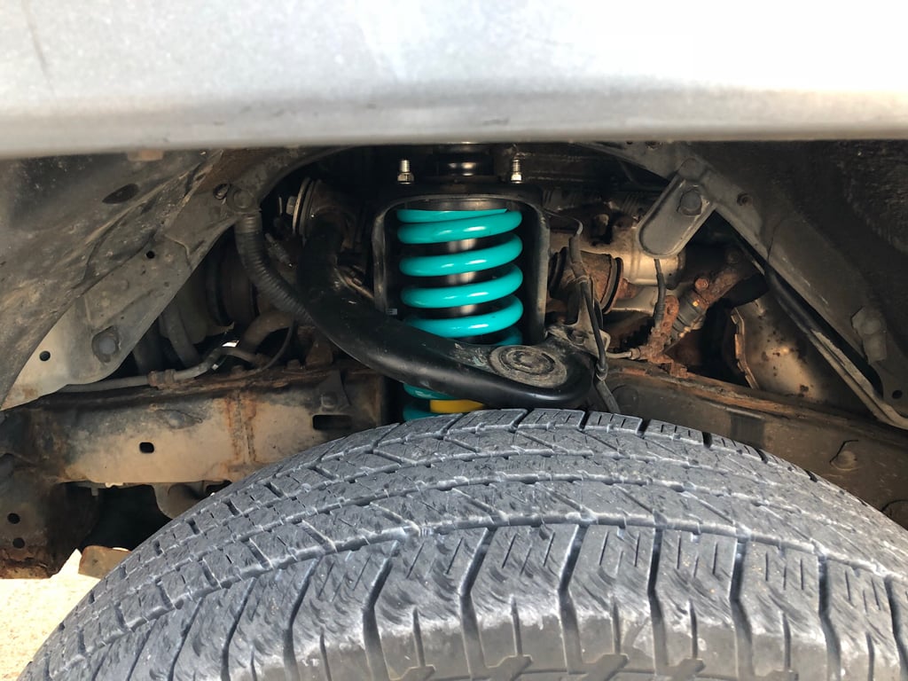

I finally got around to finishing up my Dobinsons suspension swap. I did the rear end about three weeks ago and seeing the 4Runner is trapped in the garage by scaffolding (upgrading the house to stucco), and I swapped the front this morning. My set-up is 3" front and 3" rear and I have SPC UCAs. I'm trying to figure out what I should set the UCAs at as far as caster goes. They were at the "zero" setting which in +2* with ok alignment numbers (3.2* driver and 2.7* passenger) and I bumped them up to +3.75* thinking that would move my caster angle to the high side of the spec. My goal is to get the 285's as far from the body mount as possible and I've heard that higher caster can do that. Any suggestions?

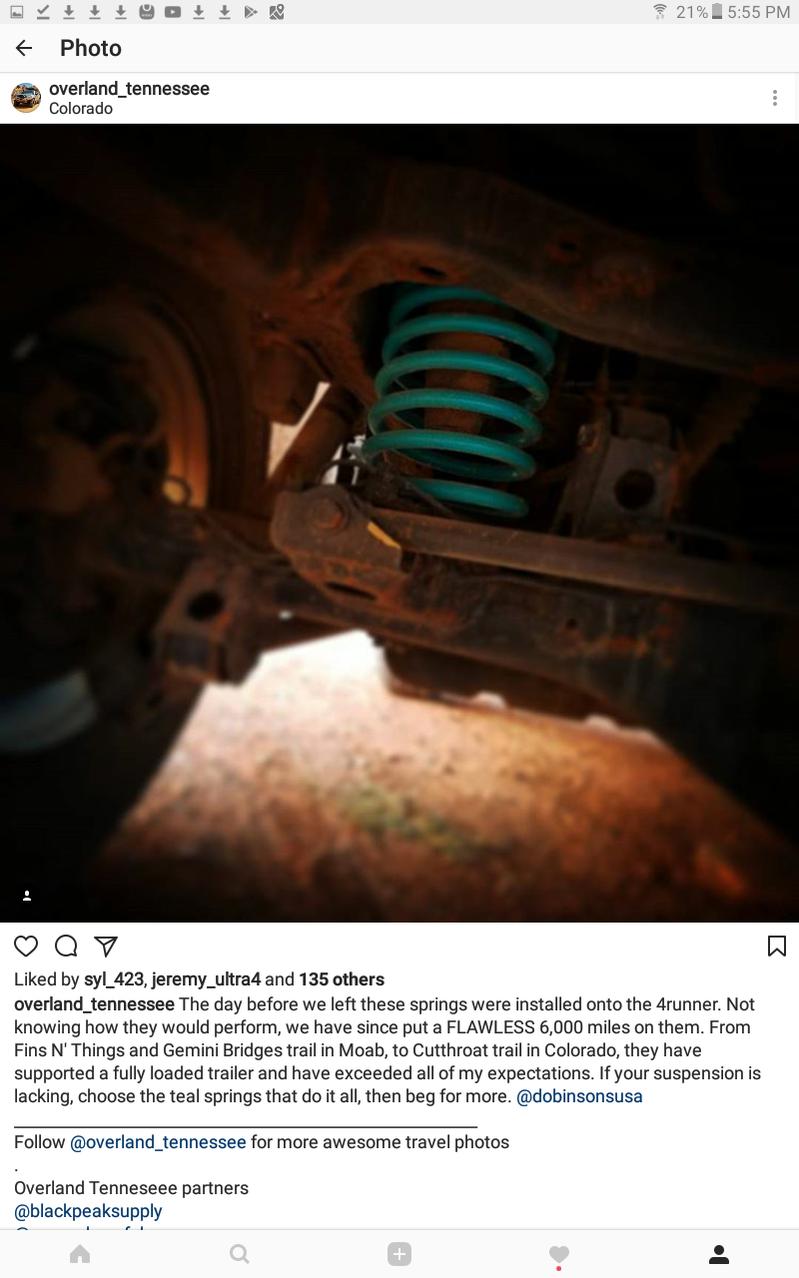

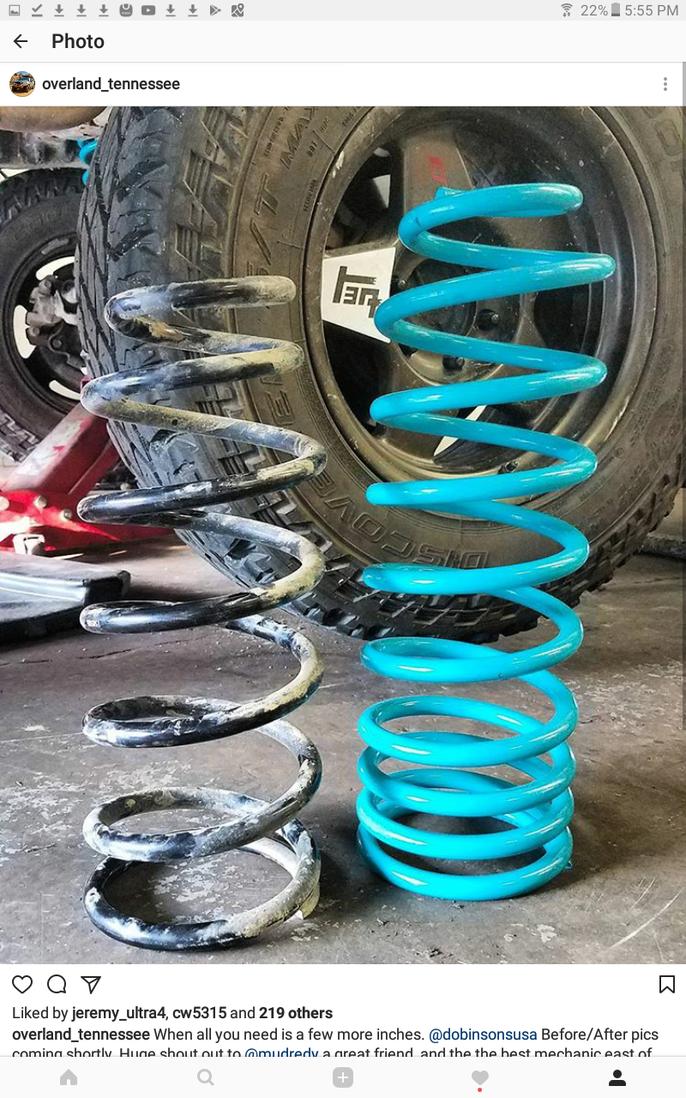

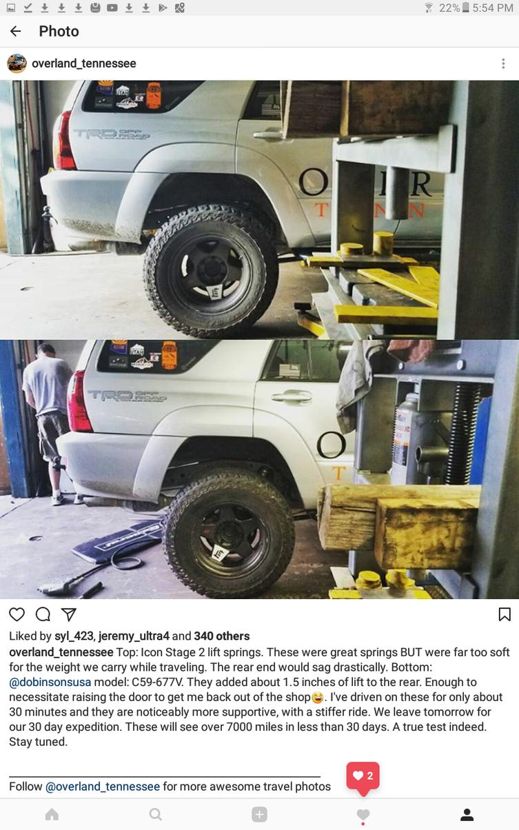

Just saw this and I am running the 677V rears was previously running the standard ICONs that are supplied with their stage 2 kit. The 677s are quite noticeably stiffer, but it brings back the factory rake look, which allows me to carry my gear in the back. I just completed an 8000 mile trip across America with them, and am extremely happy with their performance. I was hauling a 2300lb trailer the entire duration and the springs were phenomenal.No sag, very supportive... Here are some pics of the 677s beside my icons and the lift difference as well... These weren't just driven around on roads either. They survived SteelBender, Gemini Bridges, and Fins N Things in Moab, and Cutthroat trail in Colorado without issue.

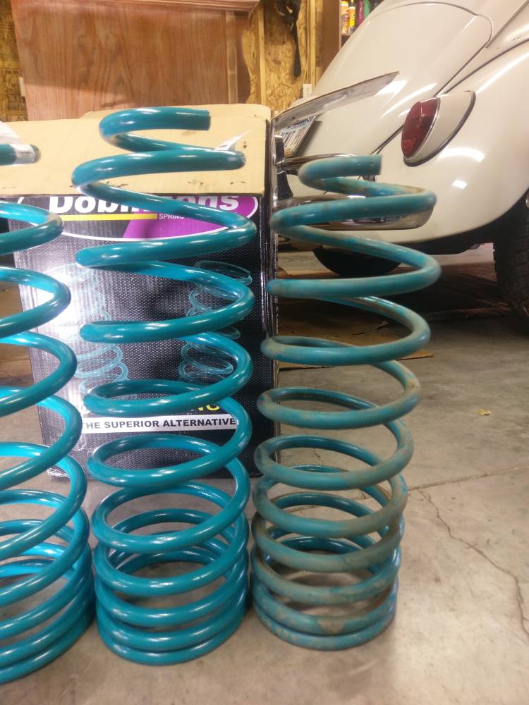

So I had been thinking the 599's. But after seeing Boostedka's measurements, i went and measured mine to contrast compare. I actually don't want to lift the rear much more than it is currently, just bring my front up to the height I want(straight/level cv's). Granted my suspension is all shot, that's why I'm rebuilding it, but Driver's ~35 1/8", Passenger's ~36".
So I guess that puts me with the -323, yea? Anybody used these, have measurements? And will my lean come back, with the new springs?

Someone just bought some 323's from me yesterday, but it's been so busy, I don't remember what vehicle he's planning to put them on.
323's would be 15mm or so lower than 599's so if you're just looking for fresh new springs with little to no lift height, those 323's would work well. Don't forget to consider any accessory weight you have.
With the 4th gens, the leaning could still be an issue, so hold onto any spacers you have, or plan on getting one for the low side. I just checked all the options again, and we don't have a short height offset coil for these. The C59-723 is the "shortest" offset height coil we have, but those would give about 35mm of lift over stock height.
