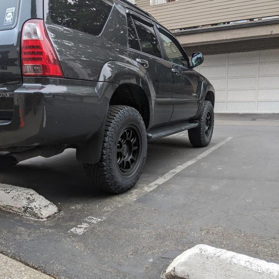

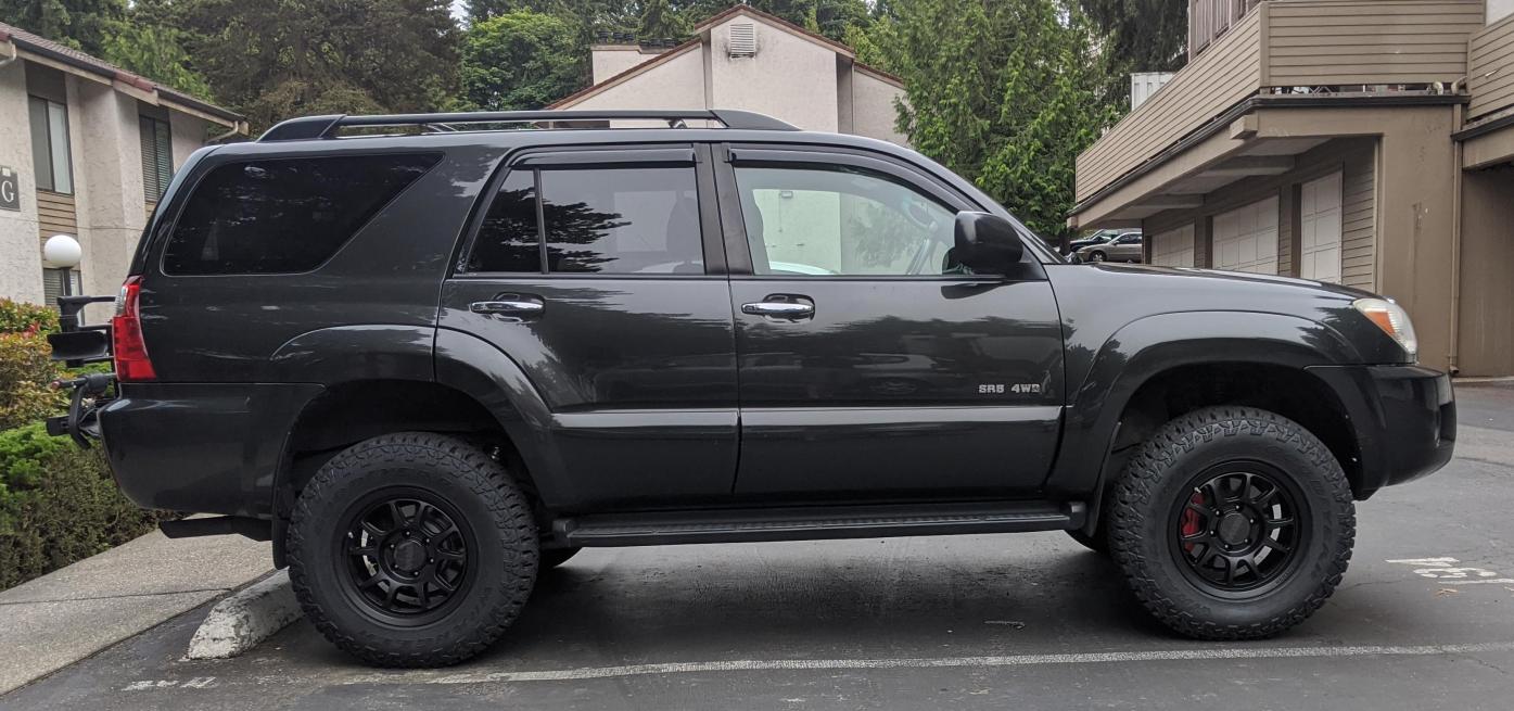

Finally installed wheels, tires and lift. I went with the C59-302 and C59-505 on bilstein 5100's. Tires are 265/70r17. Fronts are roughly 22.5", drivers rear is 22.5" and passenger rear is a little over 23". Im really surprised with the difference from my daystar 2" front leveling kit. Fronts were at 20.5". I even measured each assembly prior to install and they were exactly the same length. I kind of think I shouldve went with the C59-300 and C59-599, but Im very happy with the ride quality.
[MENTION=153419]Ebolavirus6[/MENTION] sure everyone has a different opinion and yours is ultimately what matters but....I think it looks great with the 302/505 combo!
