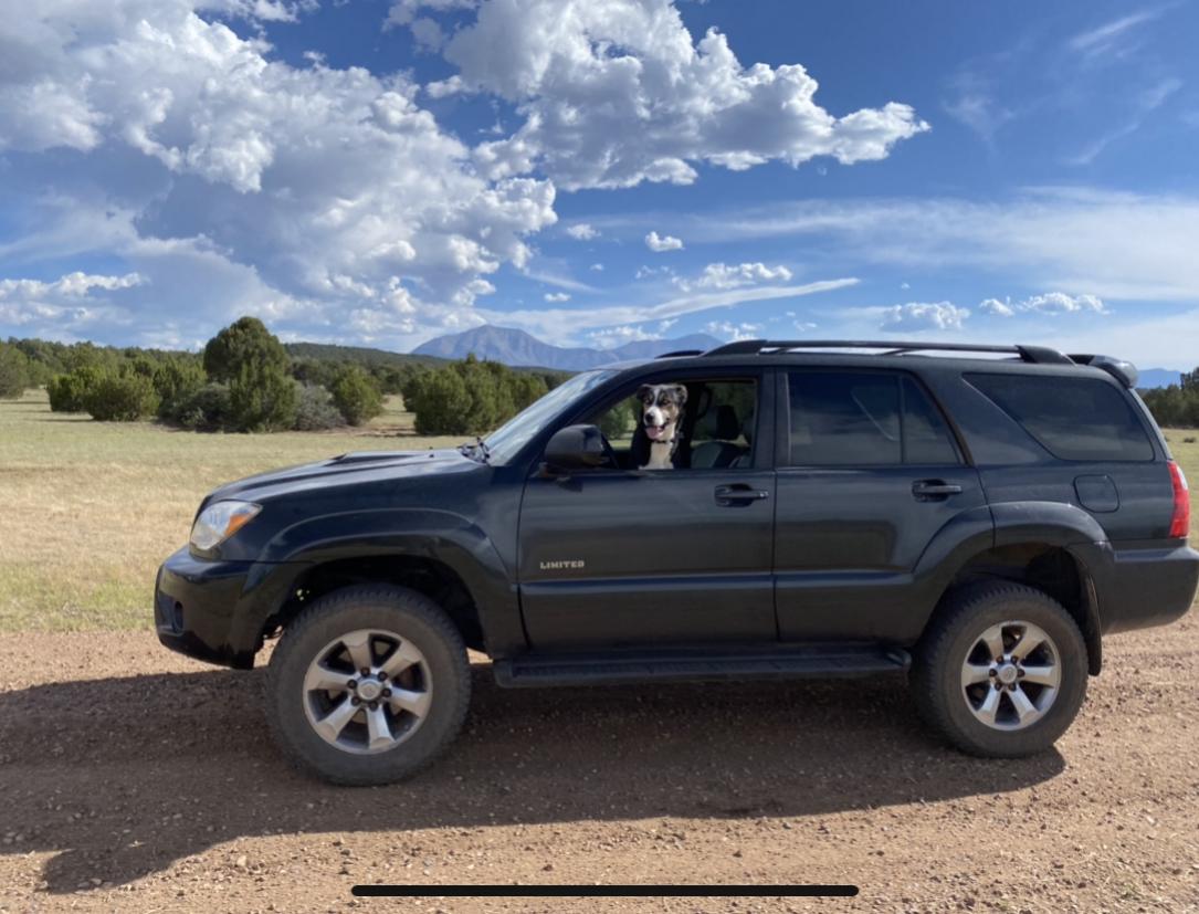

Installed everything today. I used the school auto shop where I teach and the install was pretty straight forward. But I also had the shop teacher there to help. So far I cruised around on the highway and some dirt roads. The handling is much improved so far.
We installed the following:
Front:
-c59-302
-GS59-221
-1/4” driver side spacer
Rear:
-C59-327
-GS59-701
Front measurements are 22” and rear are 24”
I also lifted my trailer today and I’m happy I left the rake. When hooked up, things are pretty level.
