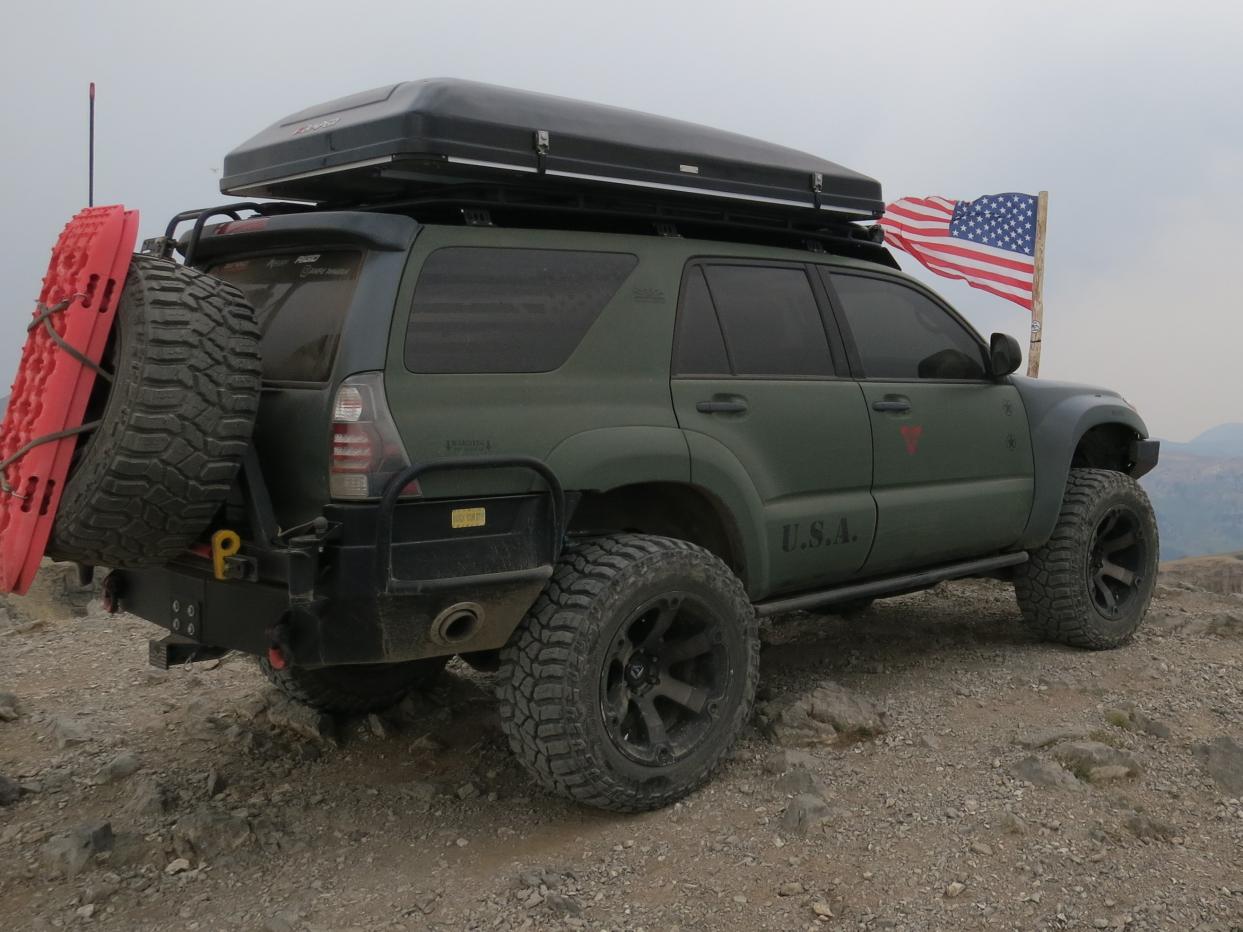

I have the 701v rear springs and with the roof top tent, drawer system, fridge and camping gear...according to this pic, am I sagging in the rear just a bit? I feel like I need more lift or something.

Doesn't look bad to me. Same wheels as mine too!!
You can either add 2 x 15mm spacers, one on top of each coil to add some lift if you're happy with the ride and spring rate, or you can change out to the heaviest C59-749V's.

Yeah, they should come up at least 1/2" I'd say.

If you want max lift and load support, the 749V is the way to go.
