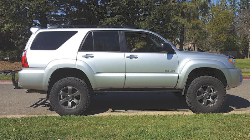

Thanks for all your help Mike. I finally got the setup installed and it came out awesome.
Height as measured from the center of the wheel straight up to the fender.
Stock
FL: (did not measure)
FR: 18.5"
RL: (did not measure)
RR: 21.5"
Dobinsons
FL: 21.5"
FR: 21.5"
RL: 24.25"
RR: 23.75"
Just installed 265/70/17 BFG KO2 tires.
Thanks again Mike@Dobinsons.

Just want to shout out to Mike for helping with my lift setup back in January. Six months on, many trips later, and the suspensions have been fantastic on and off road. Extremely glad I went with Dobinsons.
Front Coils: C59-300
Front Struts: GS59-221
Rear Coils: C59-325
Rear Shocks: GS59-705
