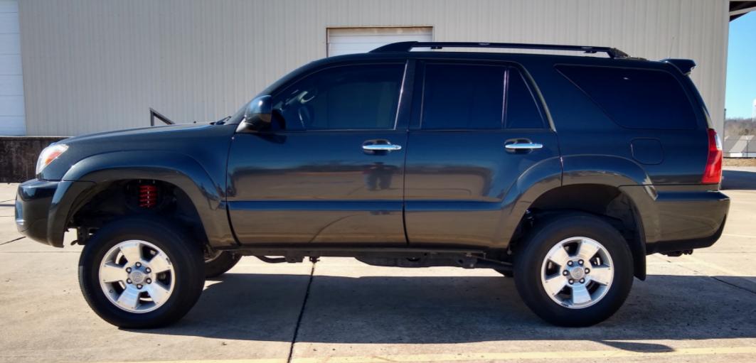

Okay, so I ordered the IMS system for an 07 v8 4WD 4runner (100k miles) and got it yesterday and decided to install it the same day because I'm impatient. I got the 314's with the 226mm seat height. for the rear, I ended up with the 675v instead of the 677v with long-travel shocks, I did this due to the longer wait and also because I thought it may have been too tall since I only cary about 100 lbs in the rear right now with a regular spare. The install took some time as apparently, I'm a little rusty.. All is well, drives good, but the front is definitely a little stiff (not too stiff though) since I don't have my bumper/winch combo installed yet.
Here's my dilemma, I know it needs to settle but I got almost 6" of lift in the front and about 3" in the rear which means it's sitting nose-high by about an inch or so (looks more than an inch). How much should I expect the front to settle? Should I get the 677v's even if it does settle + the bumper/winch for a proper rake? I was hoping for at least an inch rake at a minimum so I have room for the extra camping and traveling gear, plus I tow a boat from time to time and wanted it to be as level as possible when I do.

Measurements below, hub to fender as of last night after a 20-mile trip.
It's not quite 6" but it's close! I know I had some sagging though, I guess being in the 24" ish area is to be expected without settling and no weight. measurements were taken with a full gas tank.
Driver front
Pre: 18 7/8"
Post: 24 1/2"
Pass front
Pre: 19"
Post: 24 5/8"
Driver rear
Pre: 20 3/4"
Post: 23 1/2"
Passenger rear
Pre: 21 1/8"
Post: 23 7/8"

WOW, that is high up front!! hahaha. 20" front and 22" rear is the baseline that we go off for lift height, so you're at 4.5" and 4-5/8" of lift up front. You need to have the front weight on there, or take them off and go back to stock until you get it.
Rear is 2-5/8" and 1.5", got some leaning, but with the front so jacked, that will mess up the rear too.

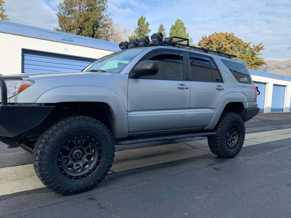

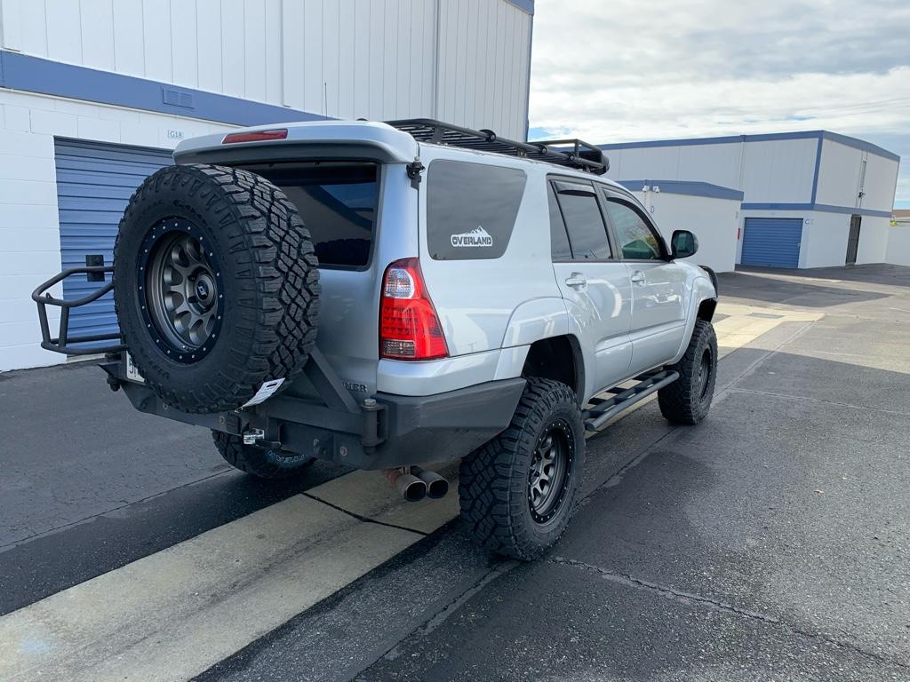

Measurements: Front is 23.5 hub to fender and Rear 24" hub to fender
Constant Weight:
Radflo 2.5 Coilovers with Radflo 2.5 Long Travel
Plate Steel Front Bumper with Winch
Plate Steel Rear Bumper with Dual Swing Out
Full Set Skids including Gas Tank
Rocksliders
Roof Rack (Mounted RTT for Overland Trips Only)
Rear Storage with Fridge

OK, so you're at 3.5" front lift now and about 2" in the rear.
You'll need to change to MRA59-A220 since they're a little longer and better suited to the taller lift you're looking for. The 701V rear coils may end up being a little taller in the rear than you are now.
Everything else looks good

The last time I was doing research on rear springs you quote the follow.
"The 701V with a solid 3" of lift should put you at 25" hub to fender in the rear."
So the 701v will add 1 inch more lift to the rear with 600-800lbs, what if I went with the 677v with 400-600lbs? Will the extra weight level it down below 1 inch? Thx
That would be the only next possible step down option and still a long travel coil, but it won't be a full 1" lower most likely. Dobinsons doesn't make 2" rated long travel coils, they're all based around the 3" mark when weight is on them.
For the weight you're carrying, the 701V is the best spring to handle all that, it's just taller than what you want.
All the 2" rear coils are linear rate and can't be used with long travel shocks, they'll fall out.
