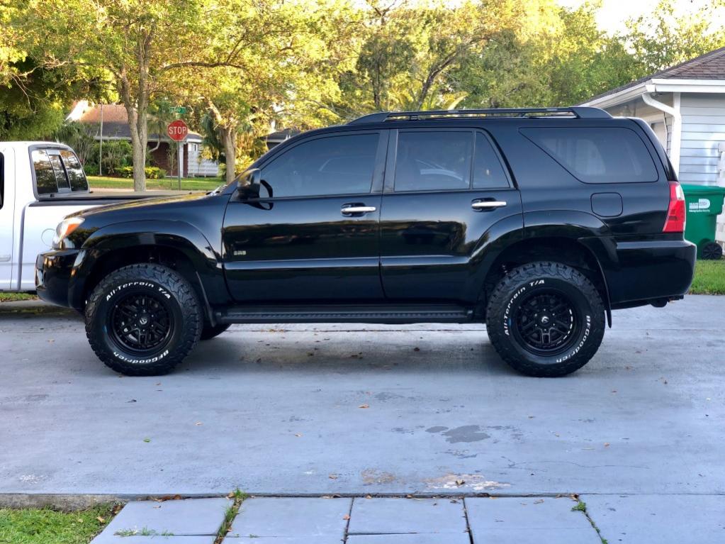

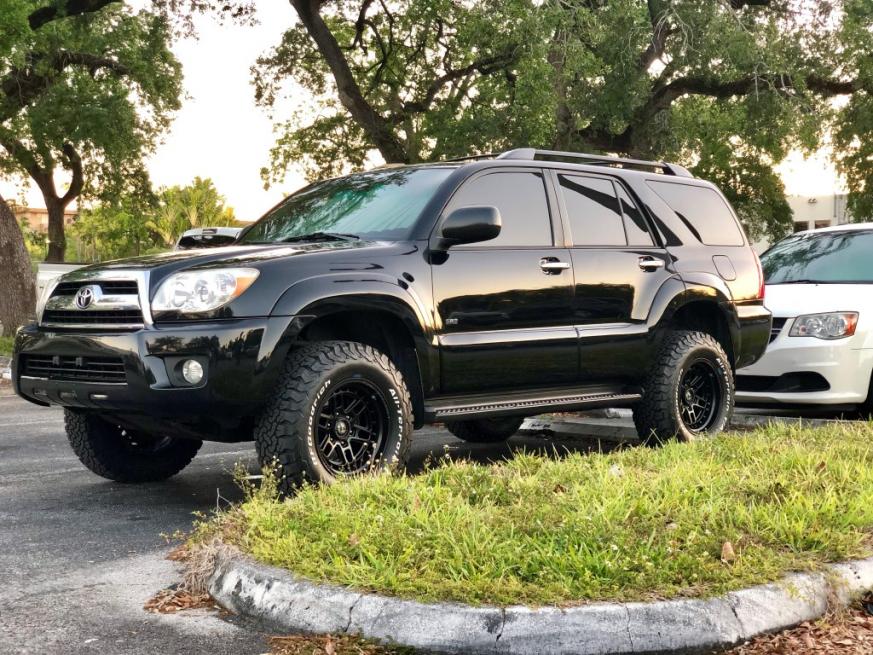

I do really like the stance of the black 4th gen that's been posted here a few times, but that may be slightly taller than I'm looking, but I'm not opposed to that, just trying to keep similar to OE drivability and not too tall for the Mrs's and the littlest of dudes to get in.

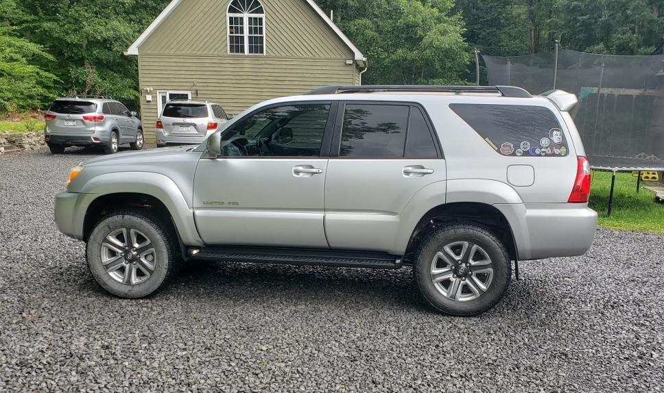

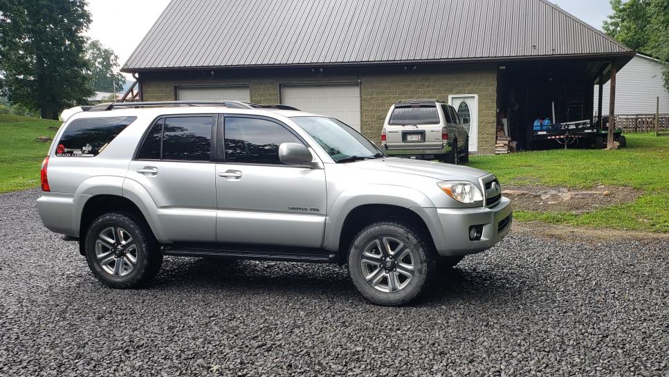

I looked at my saved photos, and these are the only ones that are at that lift height that I have saved. 2" front and 1" rear. This was immediately after the install, so it hadn't settled yet.

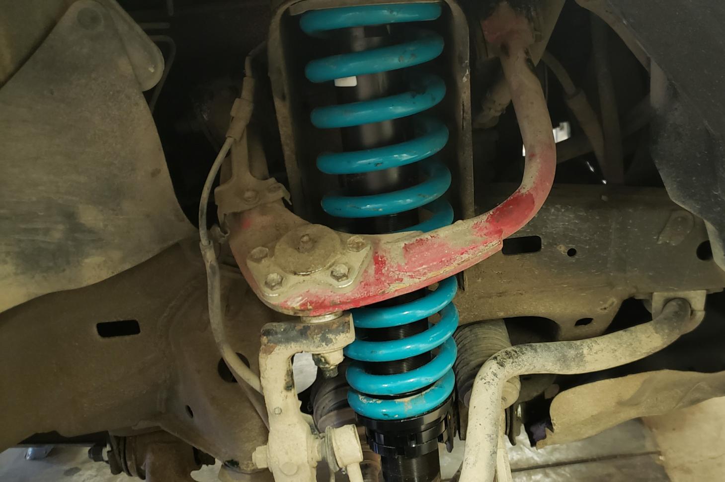

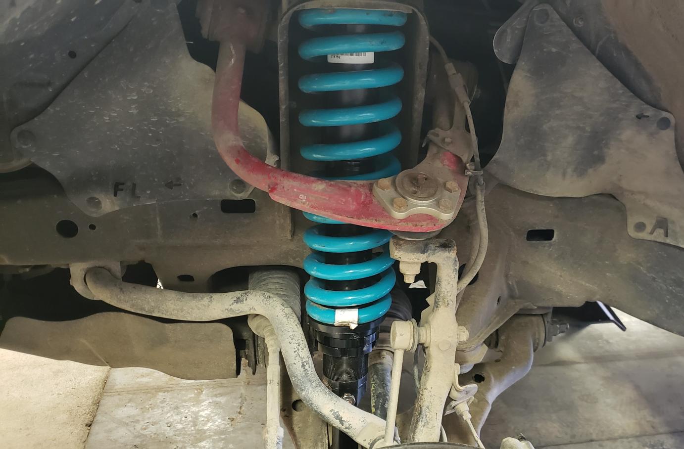

Finally got around to putting my new ims shocks on. (ims59-50220 front and the 50705 rear). They replaced bilstein 5100s with about 80-90k mi on them and its a major improvement. I drive about 15 miles of dirt/gravel everyday to get to work along with 15-20 miles of single lane, curvy back road and this truck has never driven this good. It handles the washboards and washed out, rutted dirt roads so much better than the 5100s ever did and is much more stable on the curvy, single lane road. Ive had the c59-300 front and 323 rear springs for a few years now and really like them as well.
That's great to hear!! I've never had anyone switch from 5100's to Dobinsons and not really like the ride quality improvement.
The truck looks great too, the mild lift front and rear is perfect!!

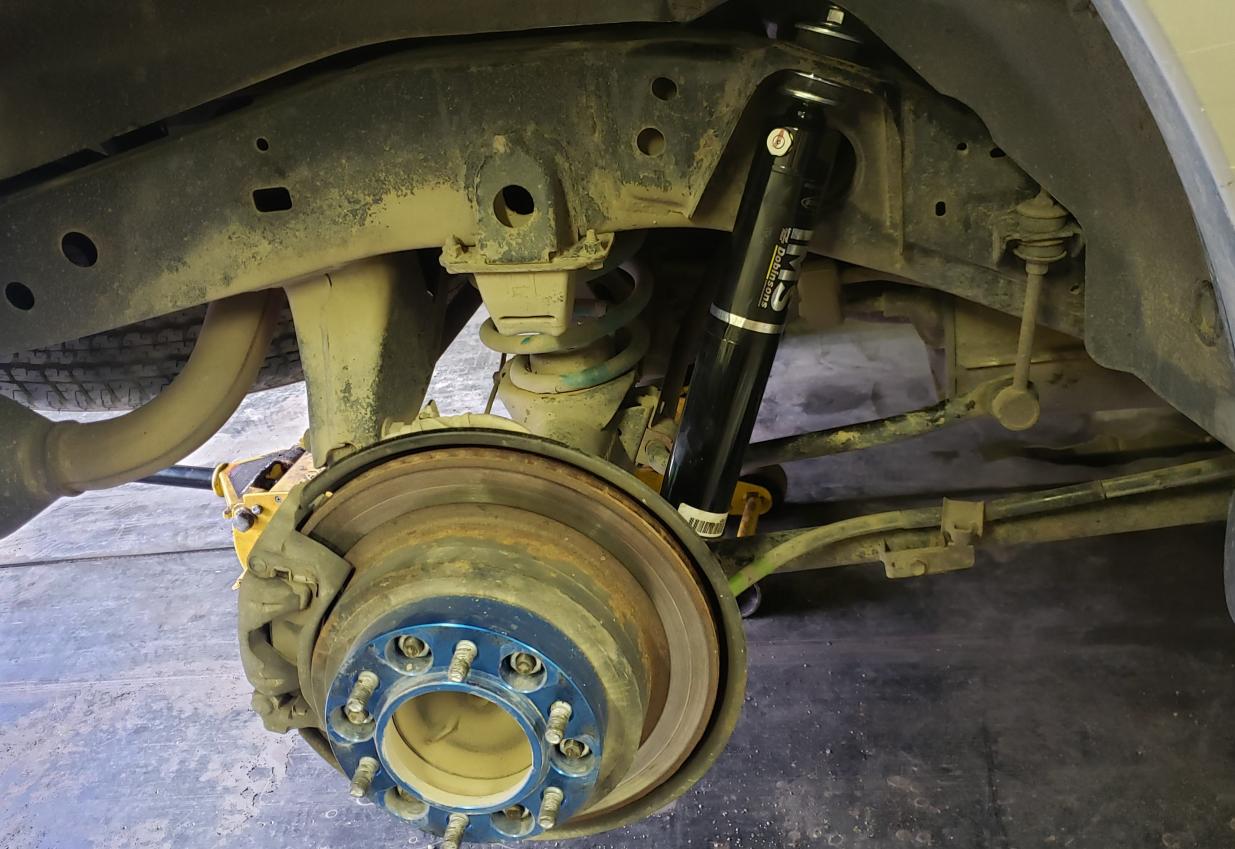

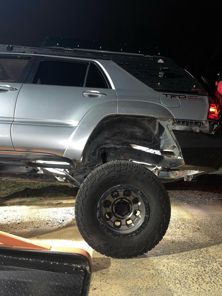

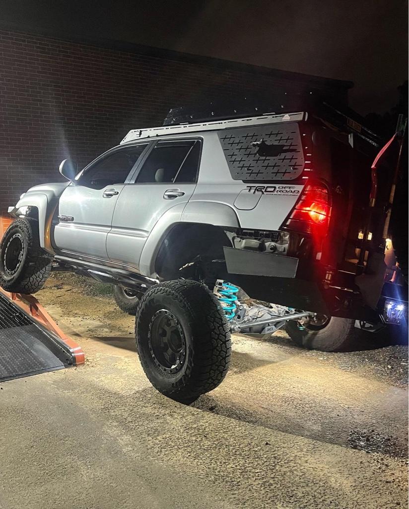

In case anyone else needs some Long Travel inspiration for the rear :) easily picked up at least 2 inches of down travel and an inch of up travel over my last setup. Now to sort out my bump stop situation and I’ll be good to go.
Just curious.. is there a measurement of how much shock tube should be exposed at full bump ? My bump stops won’t work since I have my axle slid back almost 2 inches so I have to weld new mounts and wanted to make sure I get them as close to full compression as possible without bottoming out the shock but also not losing any up travel
