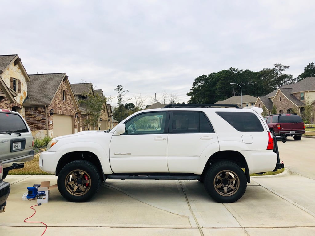

my set had some major driver lean about an inch on my 4th gen. So when I moved the coils over to my FJ, I added a 1/2" cornfed spacer and it dialed out any lean I would have had.
I don't have a shot of the rear but this is how the driver side looked like on my former 4th gen. I have the 677v rear coils, i should have stuck with the 701v at the time. My rear end sags with 300-400lb loads.
