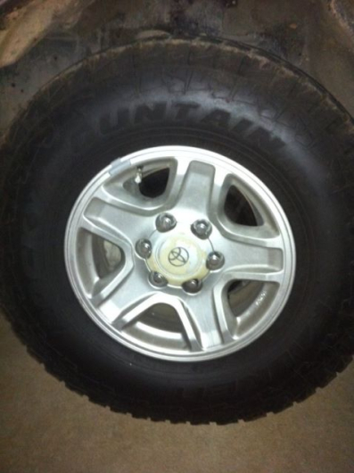

The first "mod" I did was to ditch the 265/60's, and get a more aggressive, slightly bigger tire. I went and got the Falken Rocky Mountains. Great tire, awesome traction, great wear, IMHO. Glad I made that choice. Next set will be the same tires, in a 285.

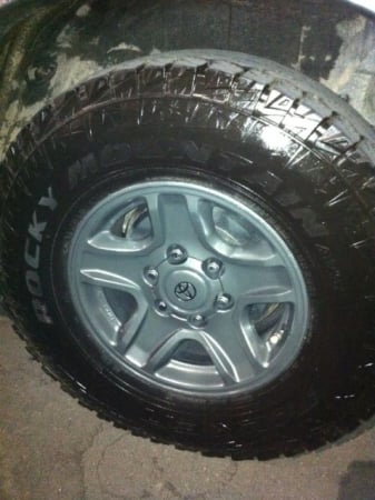

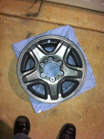

The next mod I did was to paint my rims. I got some graphite rim paint from one of the auto places, and went to town on my other set of rims.
This is what they looked like before.
The paint was coming off the center cap, and there were a lot of blemishes.
So, I took some 280 grit, an went to town.
Here they are painted.
And here they are mounted.

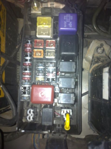

The next mod was the full time power out let mod. All I did was took some 11 ga wire, two male clips, and jumped the power outlet relay. Just be careful when you do this. If you leave something plugged in too long, you will kill your battery.
The yellow wire is the jumped relay.

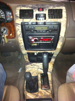

The next was to get rid of the stock double din, and get a better radio and speakers.
I choose to go with Rockford Fosgate 6.5" in the front, and 4.5" Clarions in the rear. I will soon be swapping out the rears for some 6.5", and will update as I do that and mount them.
For the head unit, I went with a JVC Arsenal, with BlueTooth and a rear iPod cable. I choose to go with the rear cable to keep the cab a little less cluttered.
Here's the radio. I also wrapped the wood trim in some RealTree AP fabric.

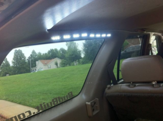

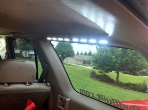

Next I did some lighting in the rear.
I went to Walmart, and got two packages of those little LED strips for 20 bucks. Not bad, considering they light up the rear like day light.
The first pic is how I wired them. I twisted like wires together, and then added a little solder to make sure they didn't move. I wanted to keep the on/off/door function, and this is what I came up with. The others are just the lights.

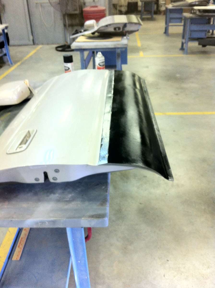

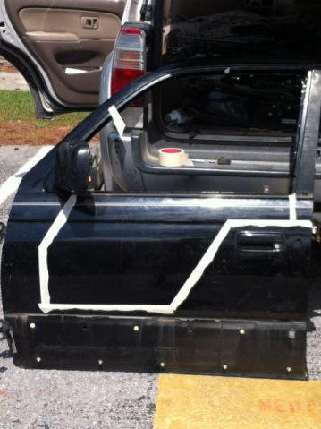

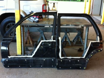

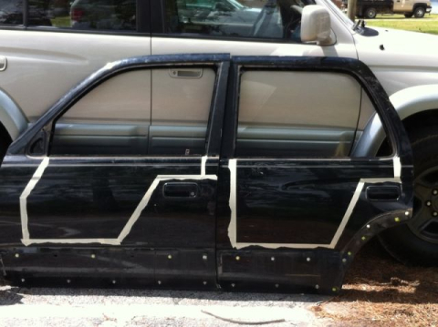

I've always wanted half doors, or no doors. But, since they don't make mirror relocation brackets for Toyota, I went with the half doors.
Obviously, and hopefully this goes with out saying, you need to gut the doors. If you decide to do this with the stuff in there, you're dumb.
And, for the love of whatever you believe in, don't do this on your stock doors. These doors came off my donor truck when I did my 4WD swap.
First, I measured where I wanted to remove metal, then I taped it off.
Next, I cut them out.
I added some metal, smoothed them out a bit, and here's how they sit now.

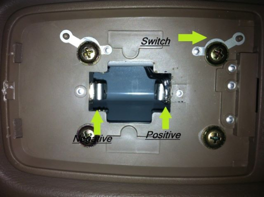

I like what you did with the rear LED's, how did you wire the positive and negatives of the led strip to the fixture though?
The switch is toward the right.
If you take that switch off, you'll see there are two metal tabs that hold the light bulb in.
I twisted like wires together, then put the positive where I have marked, and the negative where I have marked. I just wrapped them around the metal tabs, then soldered them together so they wouldn't come loose.
I have the wires from the LEDs tucked up there. Those lights came with 10 feet of wire, so you can cut them, or just tuck them away. I can try to get more pics if you need them. Just gotta let Sandy do her thing first.....
oh, i see what you mean, you wrapped the positive and negative from the led strips to the leads in the fixture.. and it provides an appropriate amount of power huh, very nice! i have a 48 5050 led panel in there now, but i feel like your light distribution is pretty good

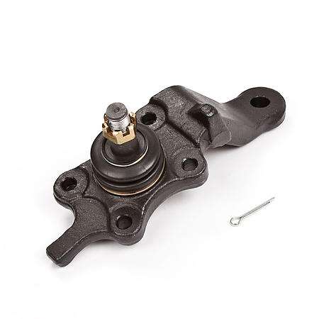

The next step is up to you. I went with the LBJ, but you can do the upper. I’ll go with my method, because, well, it’s what I did. :P
To remove the LBJ, remove the carter pin and castle nut securing the LBJ to the Lower Control Arm(LCA). Next, loosen the 4 bolts that hold the LBJ assembly to the spindle. The spindle will be loose, hanging by the UBJ. You should be able to either press the LBJ with a BJ press(available at Advance or AutoZone), or use a BFH to hit that b!tch out of there. Just be careful hitting it. The LCA WILL bounce. Again, ask me how I know…… :/ (I was hanging around Marines for FAR too long when I did all this. It’s always a bigger is better thing with them…..)
Next, take the “lock nut” from the OTR and loosen it. Mark where the OTR is, and then take it off. There is your LBJ assembly.
Take the carter pin and Castle nut off of the UBJ. Use a press or a BFO to knock that b!tch loose.

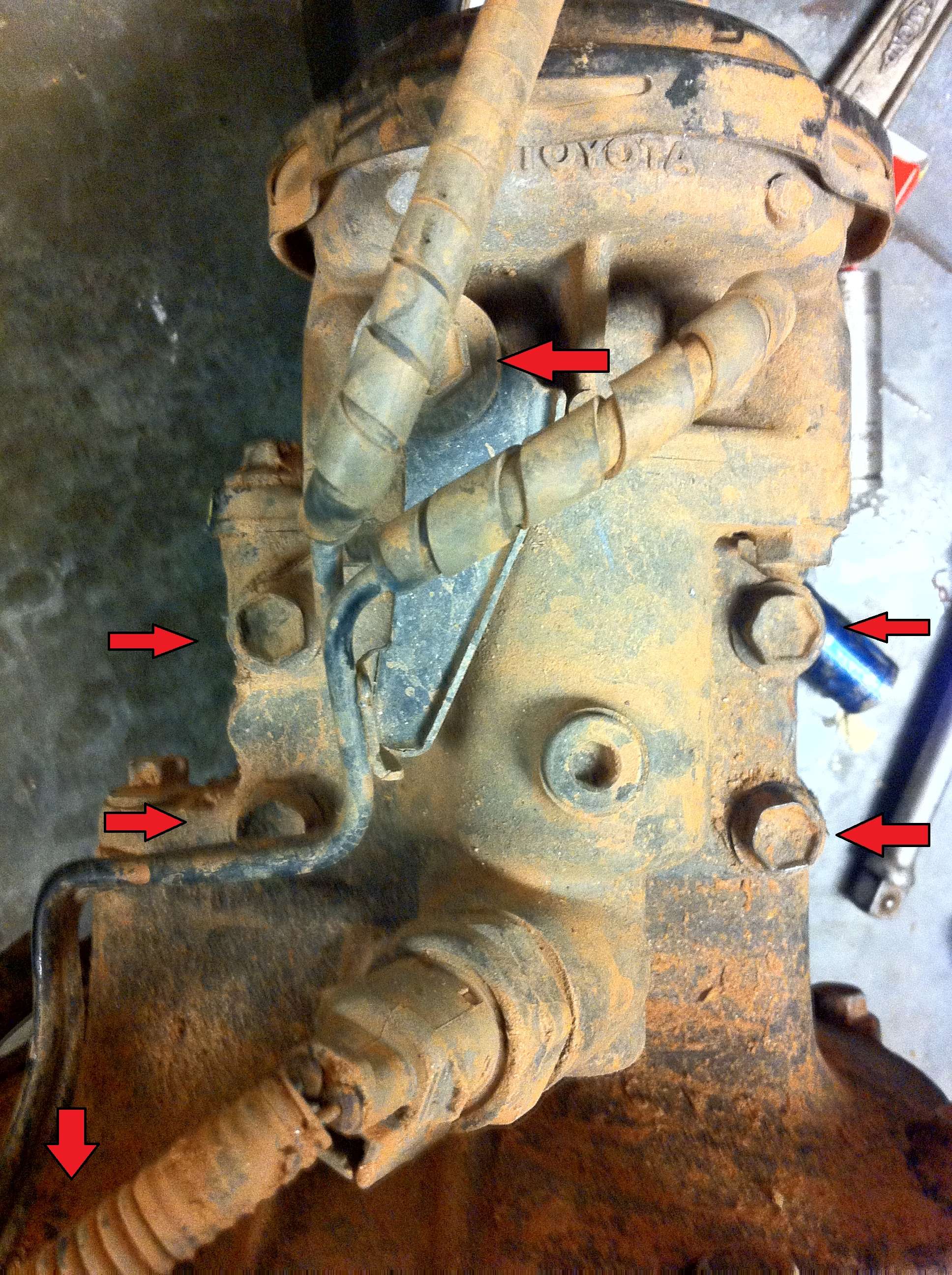

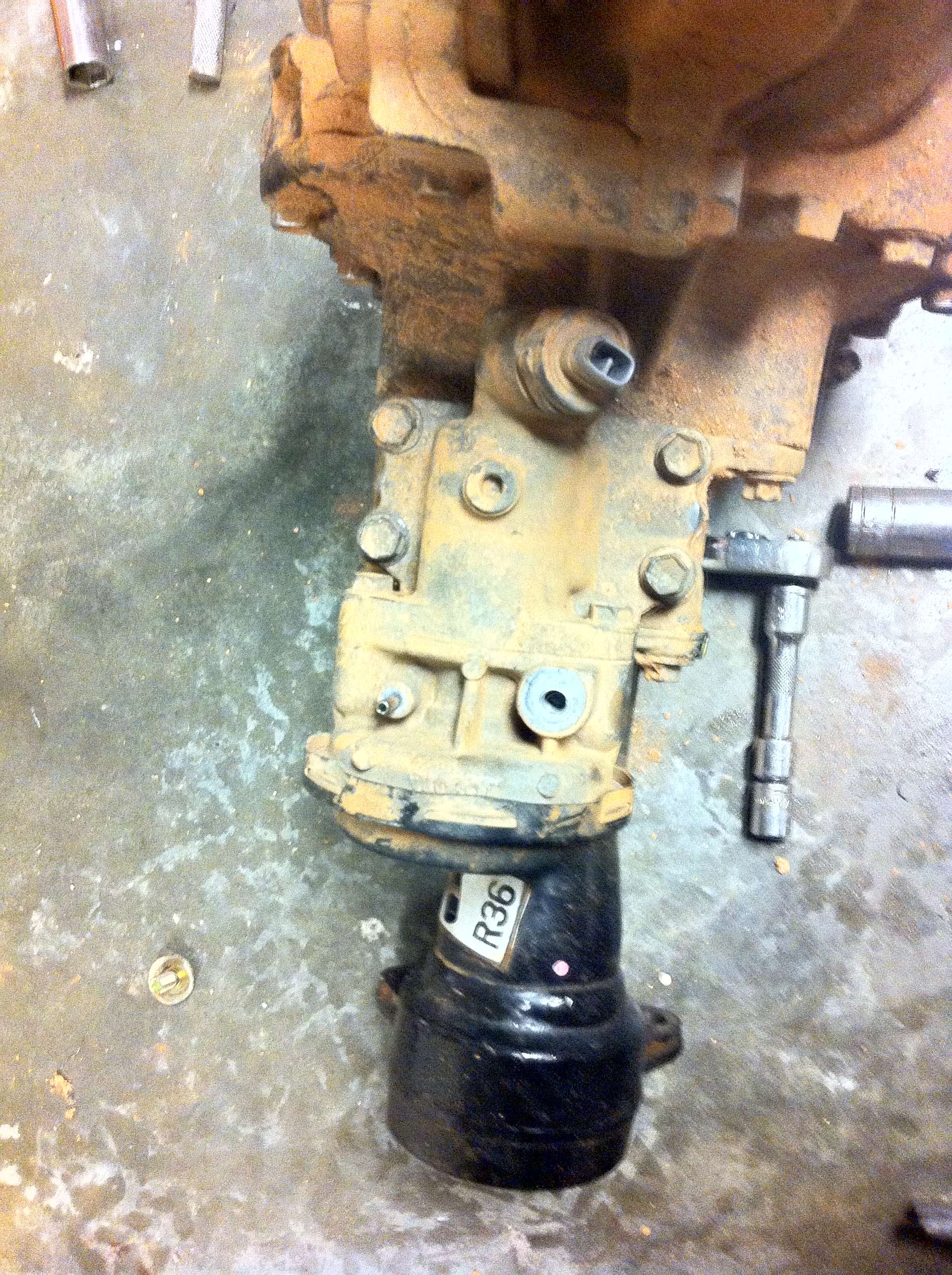

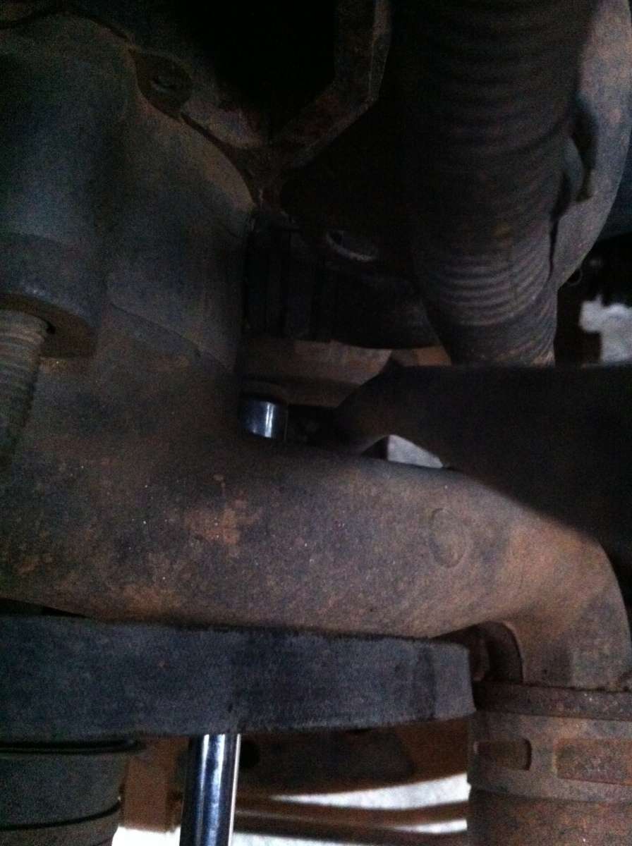

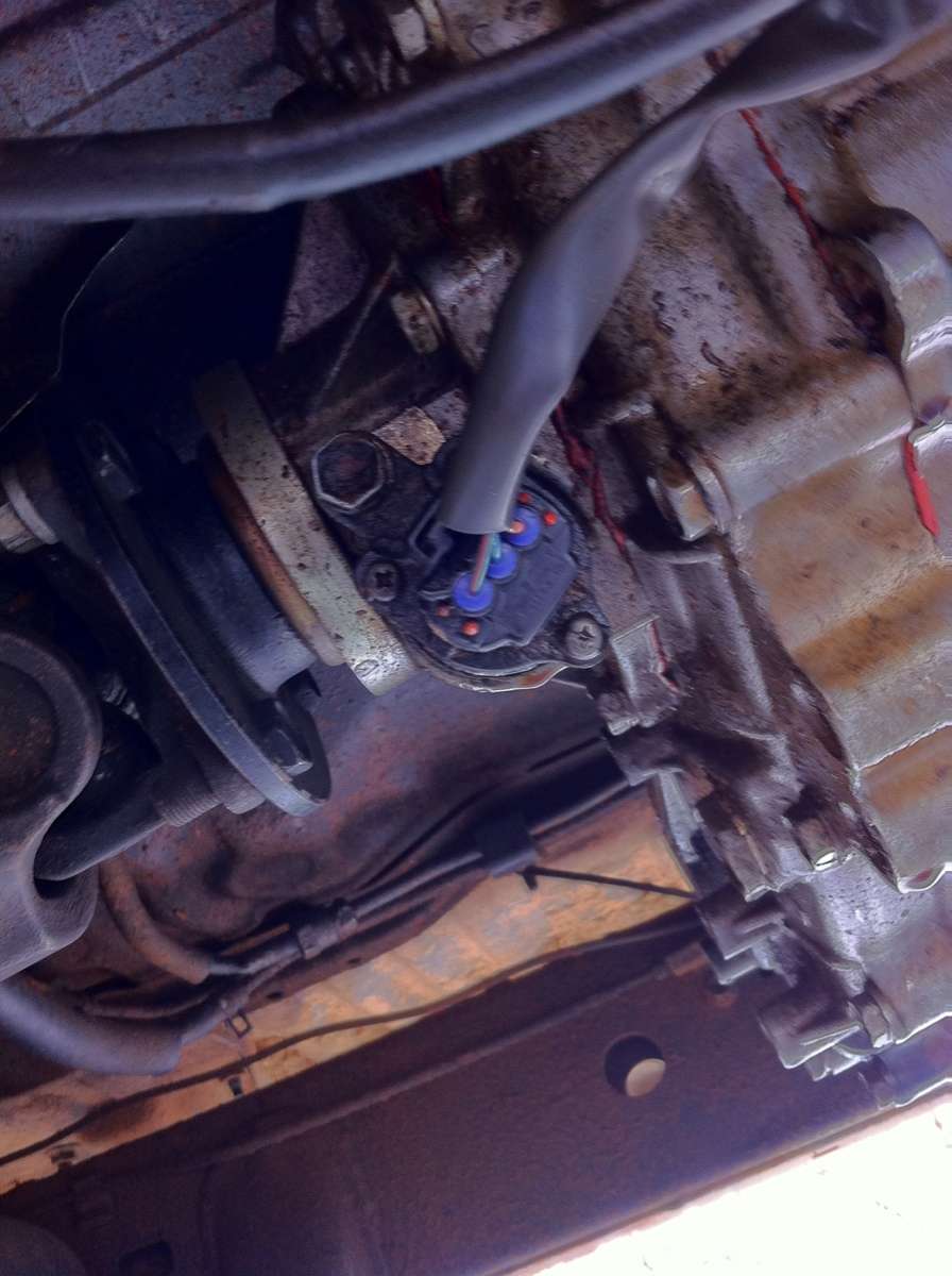

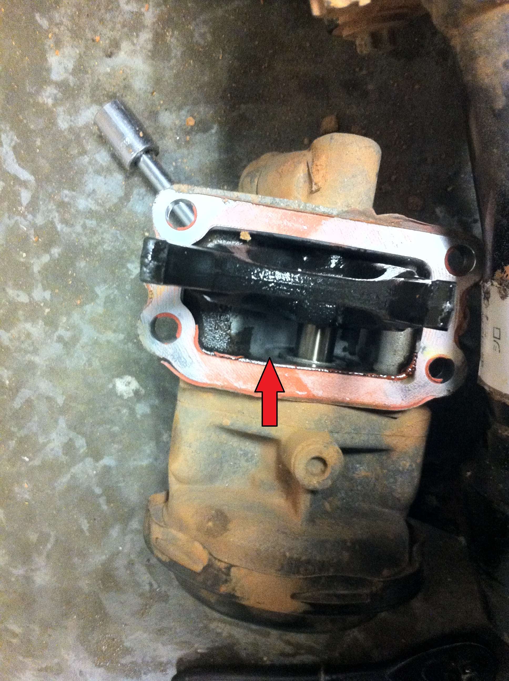

Now, even though your manual hubs are on, you still have the ADD. The ADD works by way of a fork moved by the actuator, which moves a sleeve to make the passenger side wheel spin at the same time as the driver side wheel. Basically, your truck is 3WD, until you engage the ADD. The driver CV always spins, and so does the front shaft. When you hit the 4WD button on the t-case shifter, that engages the center locking differential, as well as sliding that fork over to make the passenger wheel spin.

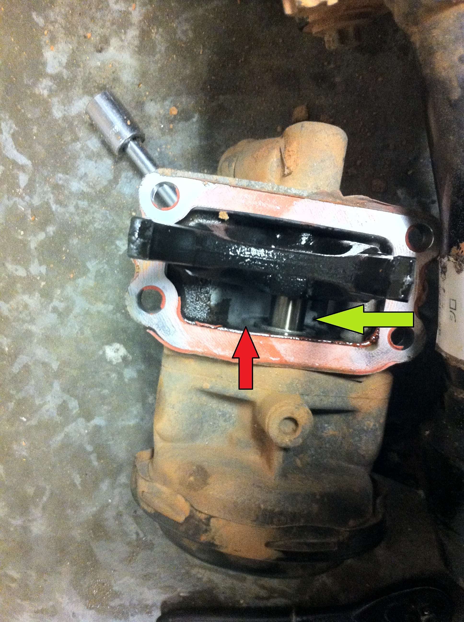

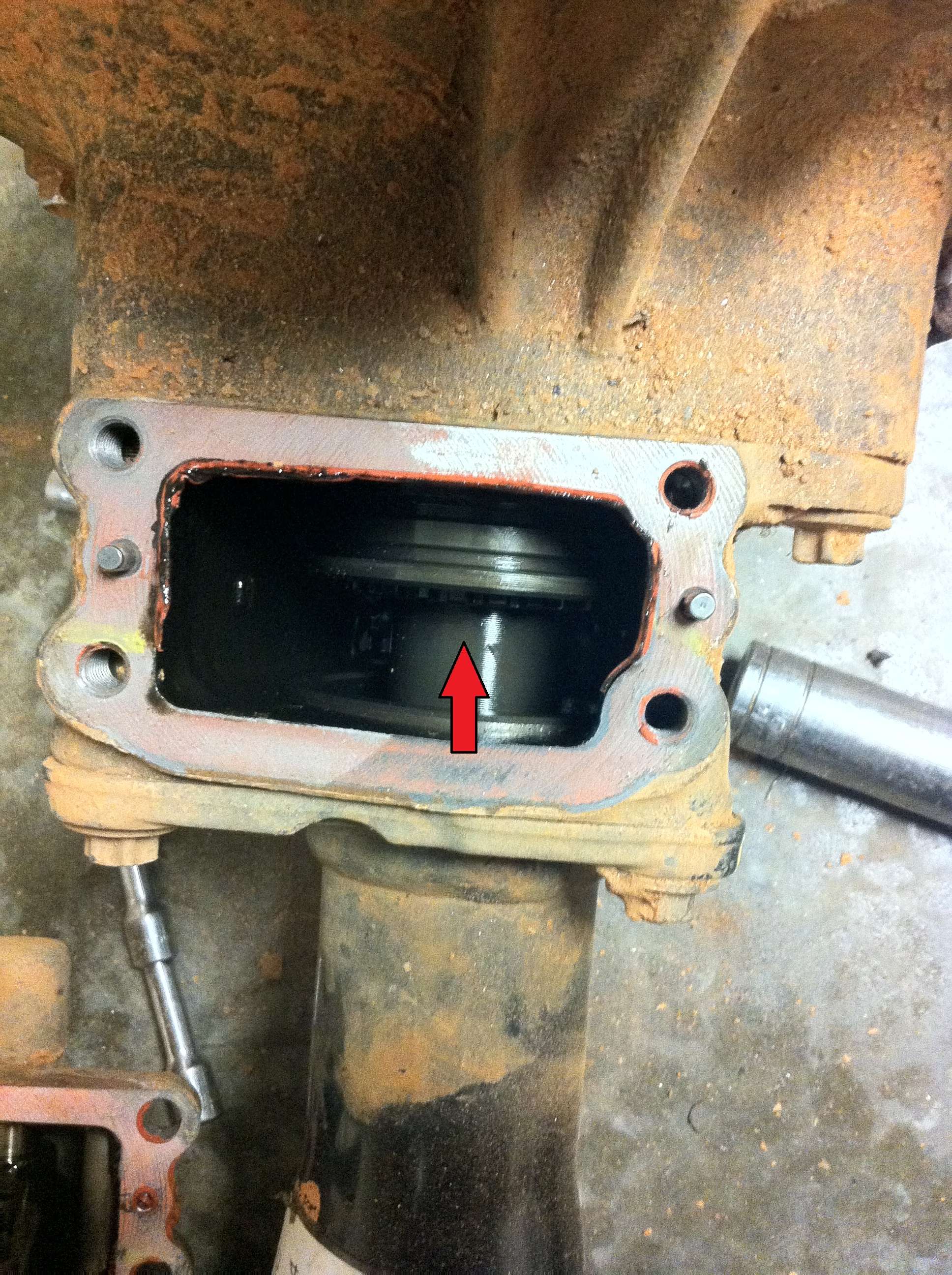

I found a simple way to make the ADD diff the same as a manual diff, using nothing more than a hose clamp. It’s your call if you want to do this, but, like I said, it’s one less thing to go wrong on the trail. You’re going to want to do this when the front diff is empty, so right after you get the hubs set up would be a good time.
Take the actuator, and all hoses and electrical connectors off of the passenger side tube on the diff. There are 6 bolts that need to be removed to take all the crap off.
With the ADD DISENGAGED, notice where the fork is. Slide it around to make sure it’s not binding up anywhere, and it’s not stuck.

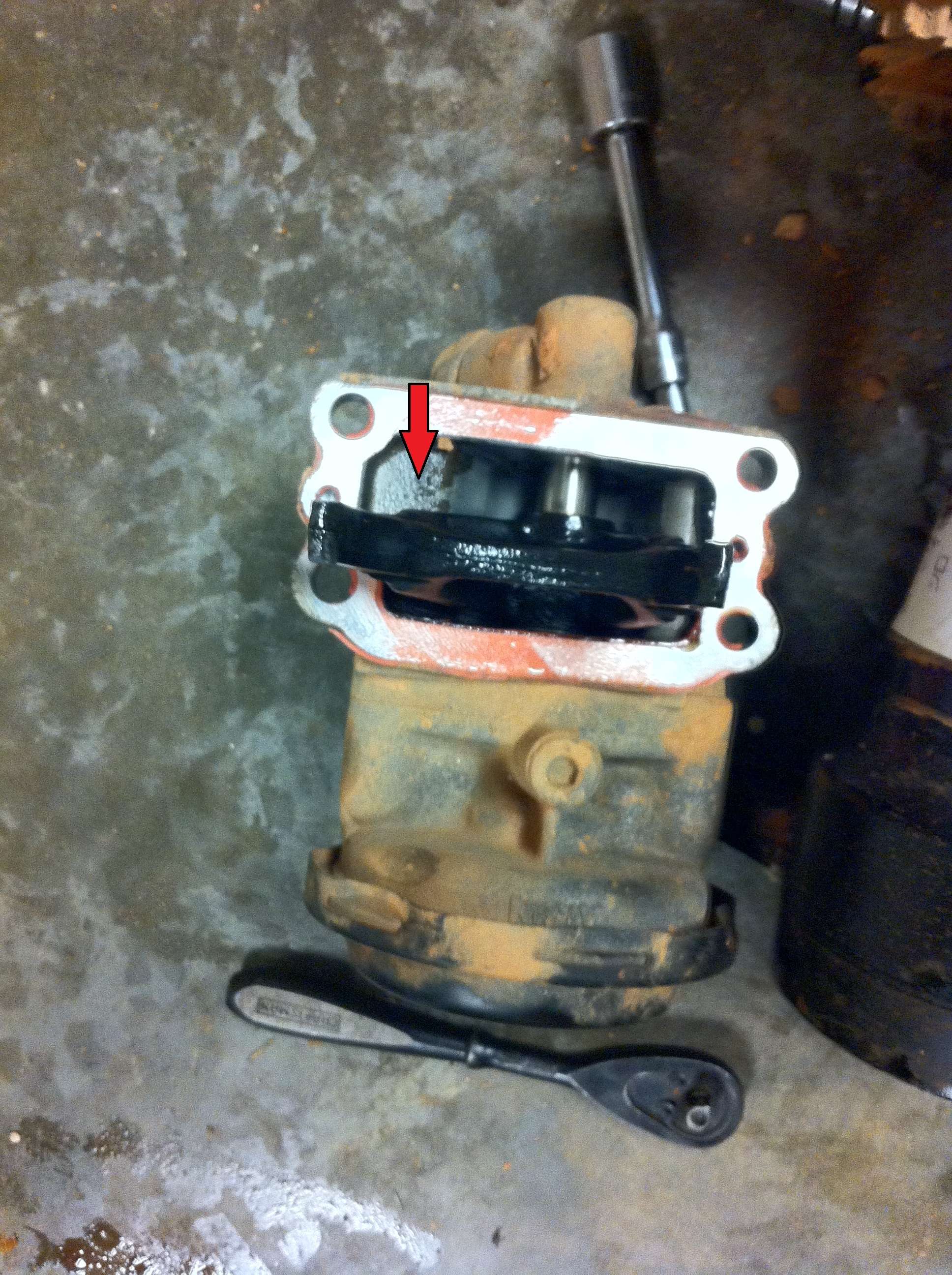

Move the fork over to the “engaged” position.
Put the hose clamp on the shaft, to make sure it doesn’t slide back into the “disengaged” position. The green arrow is where the hose clamp should go.
Slide the sleeve in the tube over to so the fork is in the proper position.
Use some gasket maker, and go around the actuator.
Bolt the actuator back to the tube, and torque the bolts to, I believe, 50 ft LBS.
Obviously, you'll want to cover those two air lines, as well as the electrical connector. The air lines, obviously so water doesn't get in there when you're wheeling, but the electrical, just incase you want to change it back to ADD. Why you'd want to do that, I have no idea....
You not have a manual front differential. :D

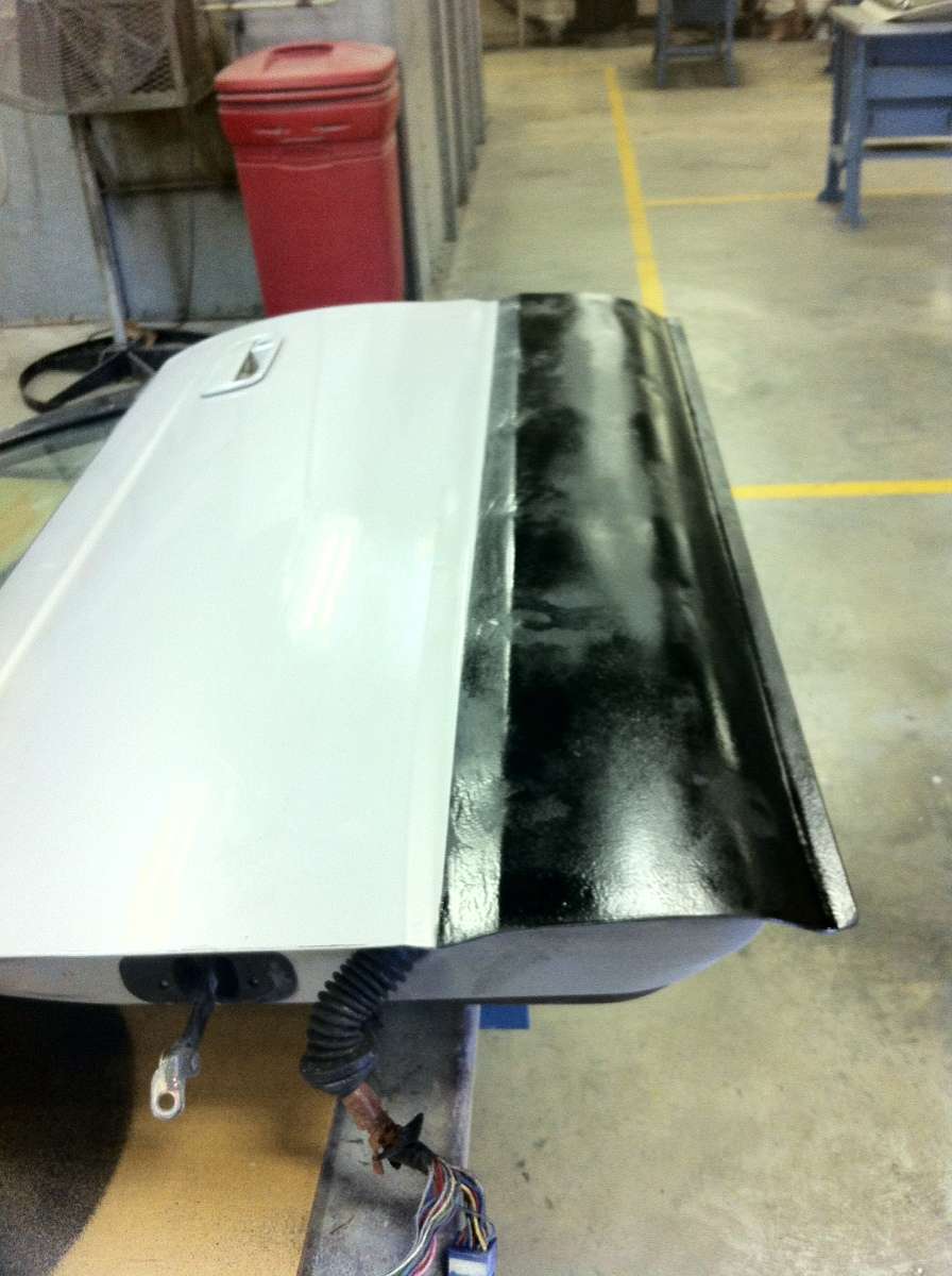

I choose to go with the Rustoleum Undercoat. Seems to be working pretty well. Again, the choice is yours as to how you want to finish this.
I wanted to do this a long time ago, when I first took the flares off, but time wouldn't let me. So, what I did was paint the are where the flares were so I'd have the outline. Actually, I left the flares on there, and taped off the area around them before I removed them, so I would have the out line.
Here's what I had then the flares were removed and the tape was off:

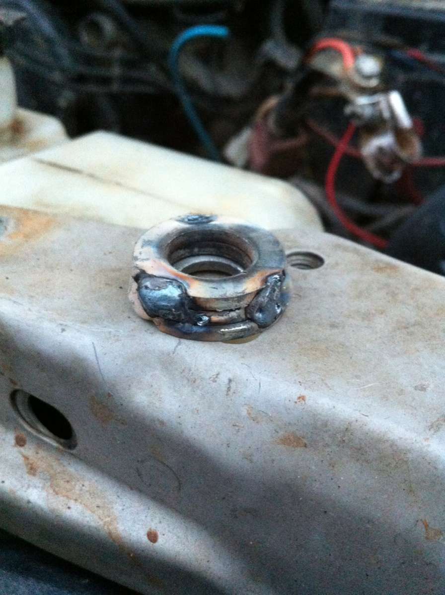

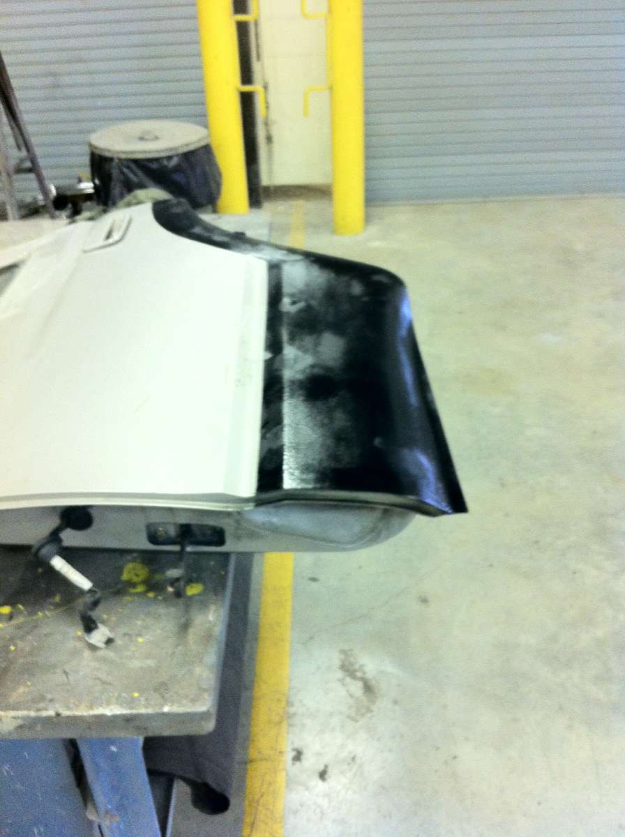

See all those holes along the doors, fenders, and rockers? Yeah, those are all from the Limited panels and flares.
How did I fill those in you ask?
I welded them all shut.
That was FUN!!

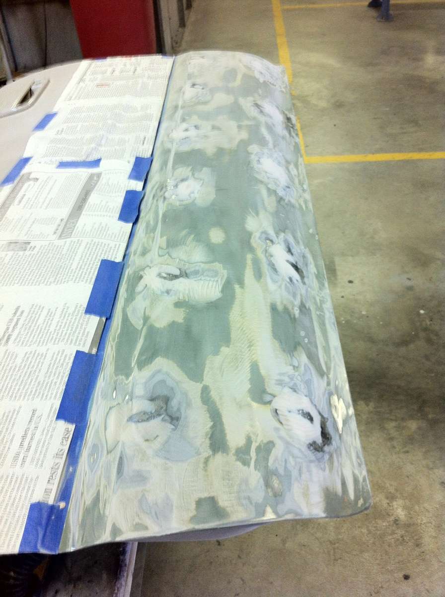

After that, I took a grinder and smoothed them out. Didn't take a Pic of that, but I'm sure you can imagine what it looked like.

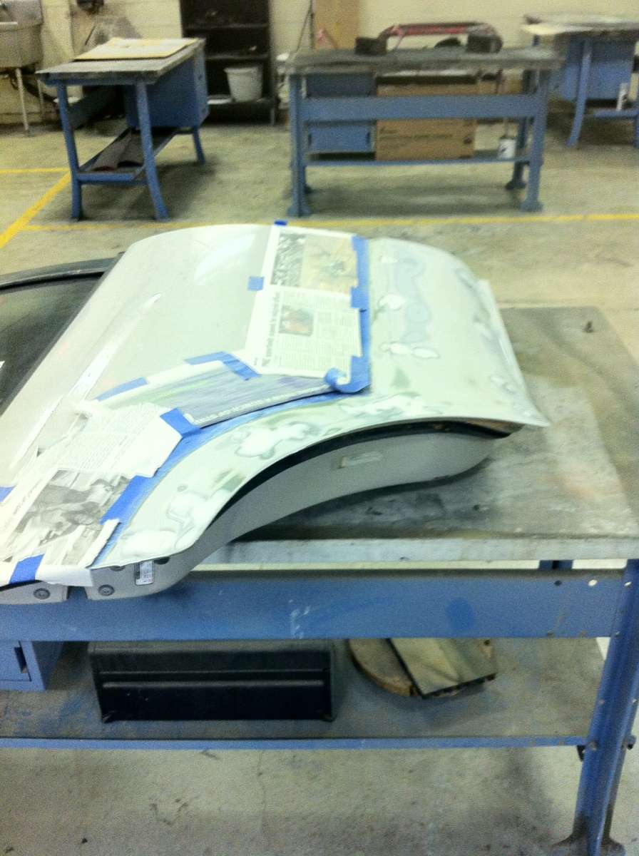

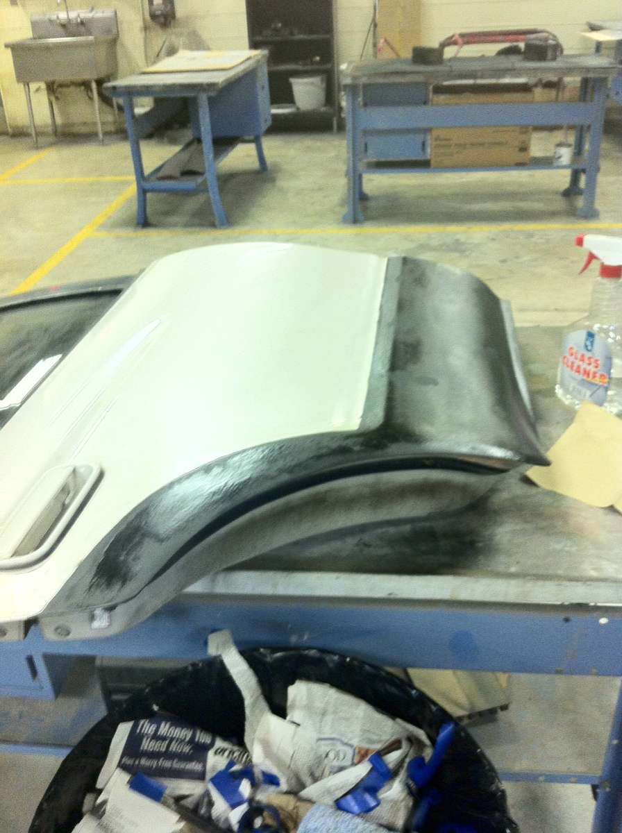

Then, I taped off the area again, and added news paper to the rest of the body to prevent overspray from getting on there. Next was to Bondo, or mud, up all the areas that were grinded off, to give the body a nice, smooth look:
Then LOTS of sanding:
I still had some high and low spots, but I could live with them.
Then, I sprayed it with the Undercoat, and took off the tape before it cured.
And the final result:

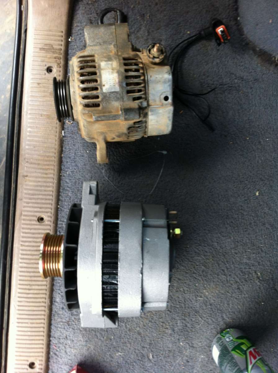

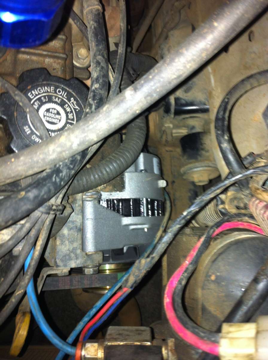

Took the truck out today, and wouldn't ya know it, the damn alternator shat the bed. Well, IDK if it really did, I probably could just clean it up, but what the hell. Didn't want to risk it going out again with the girl and baby in the car.(Read PERFECT time to do an upgrade.)
So. I upgraded. (girlfriend stole the laptop, just so I can add that he should of typed, "perfect time to con the GIRLFRIEND into paying for an upgrade!" :P)

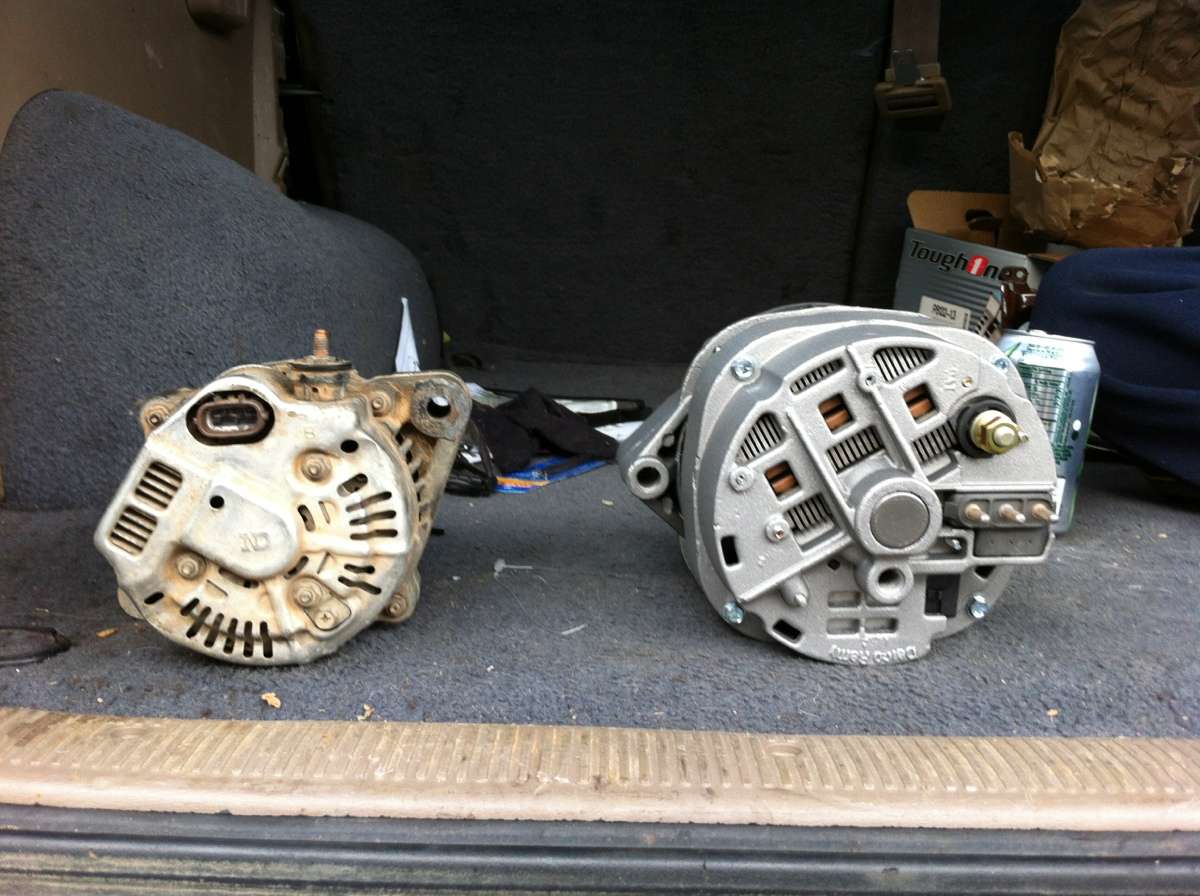

Went to Advanced Auto and got a CS-144 from a 1995 Cadillac Deville with the heated windshield. Also bought the harness for the alternator.
The stock alternator will put out 85 Amps. The Cadillac one will put out 140.

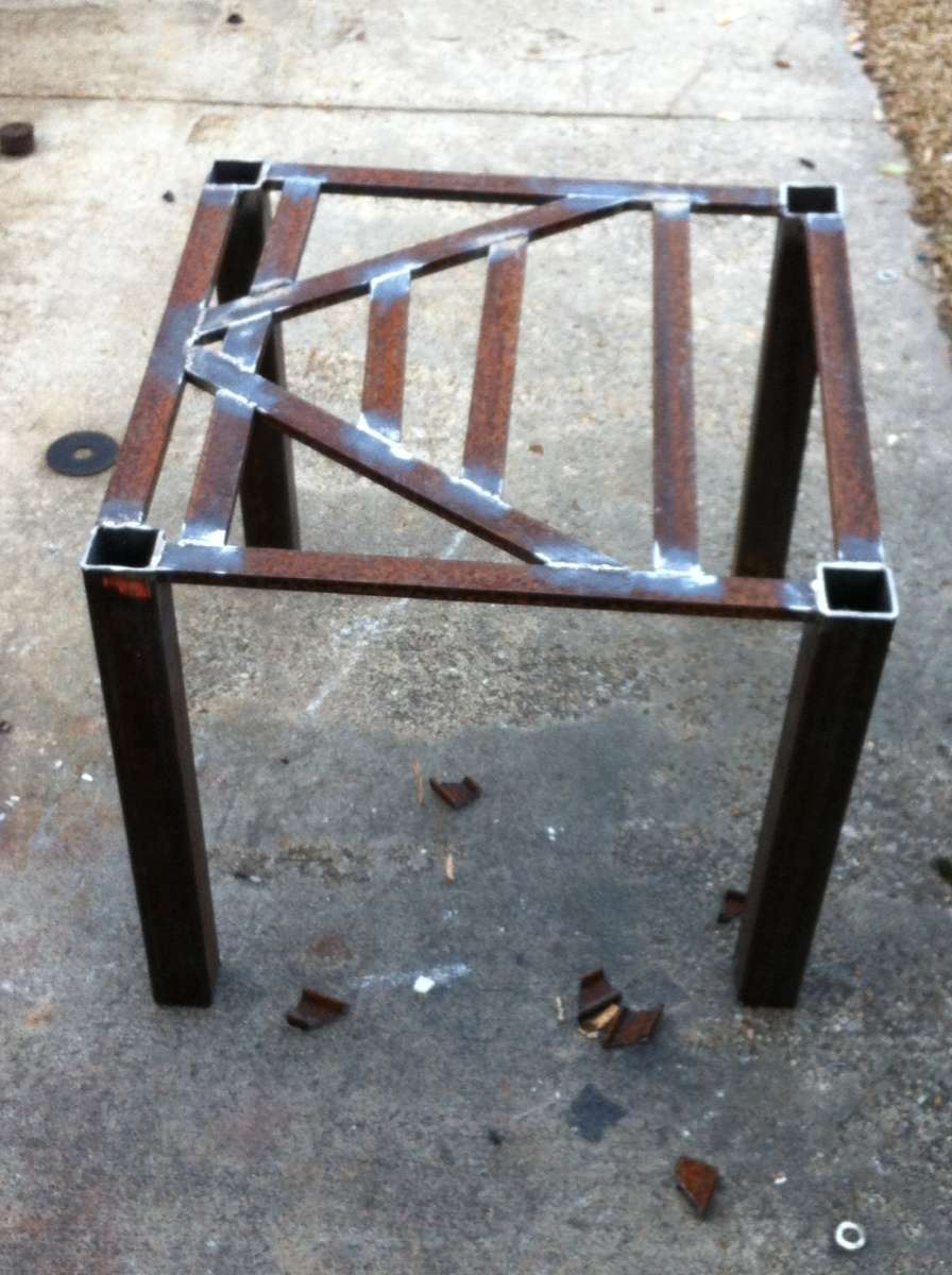

First thing to do was to build me a little stool. My short ass can't get into my engine bay all the way, so I had to come up with something. 30 minutes of cutting and welding later and I had this:
Step 1 is to remove the stock alternator. Here's a shot of the two next to each other.
There is a nice size difference in the two.

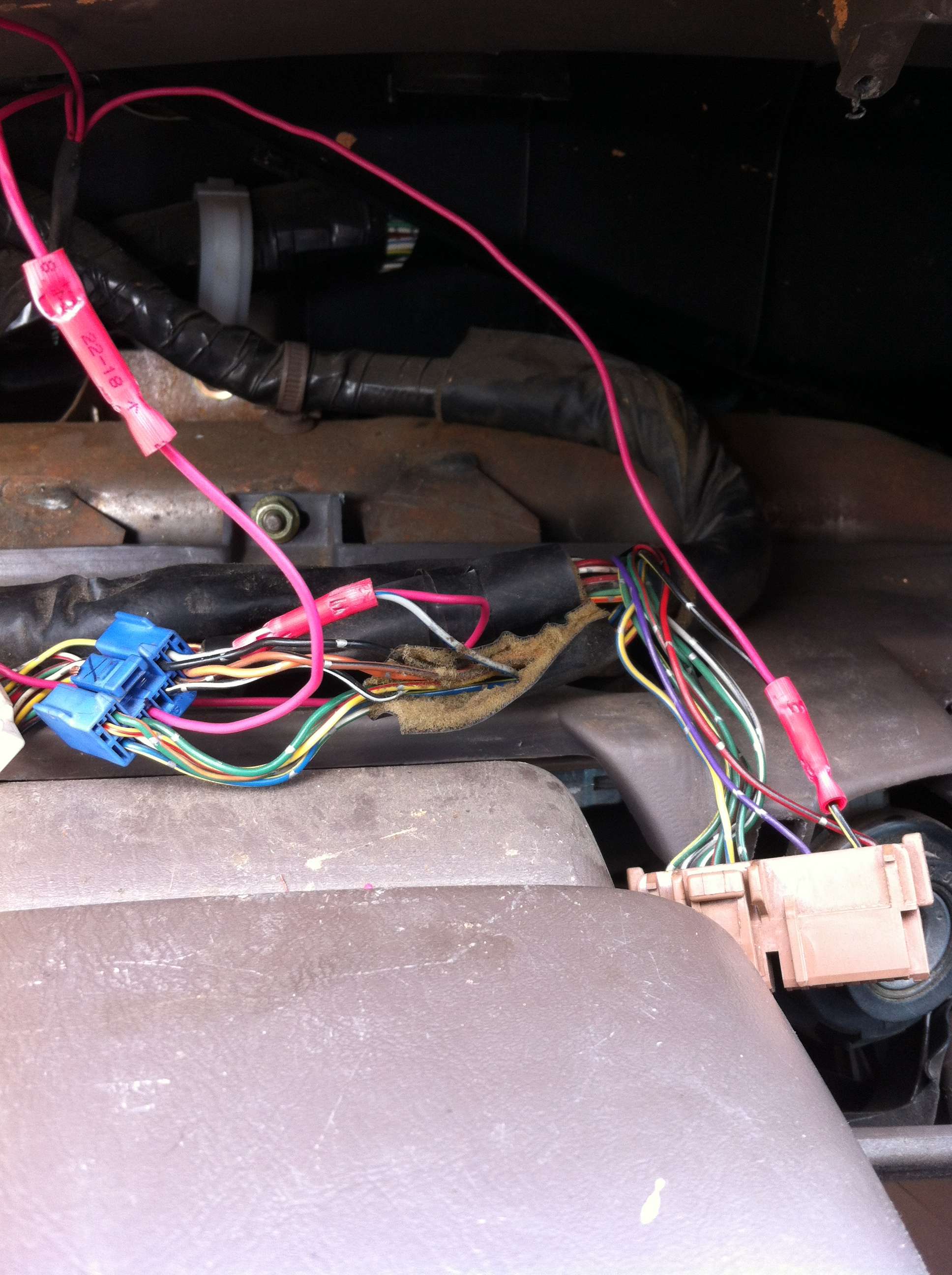

Here was the tricky part.

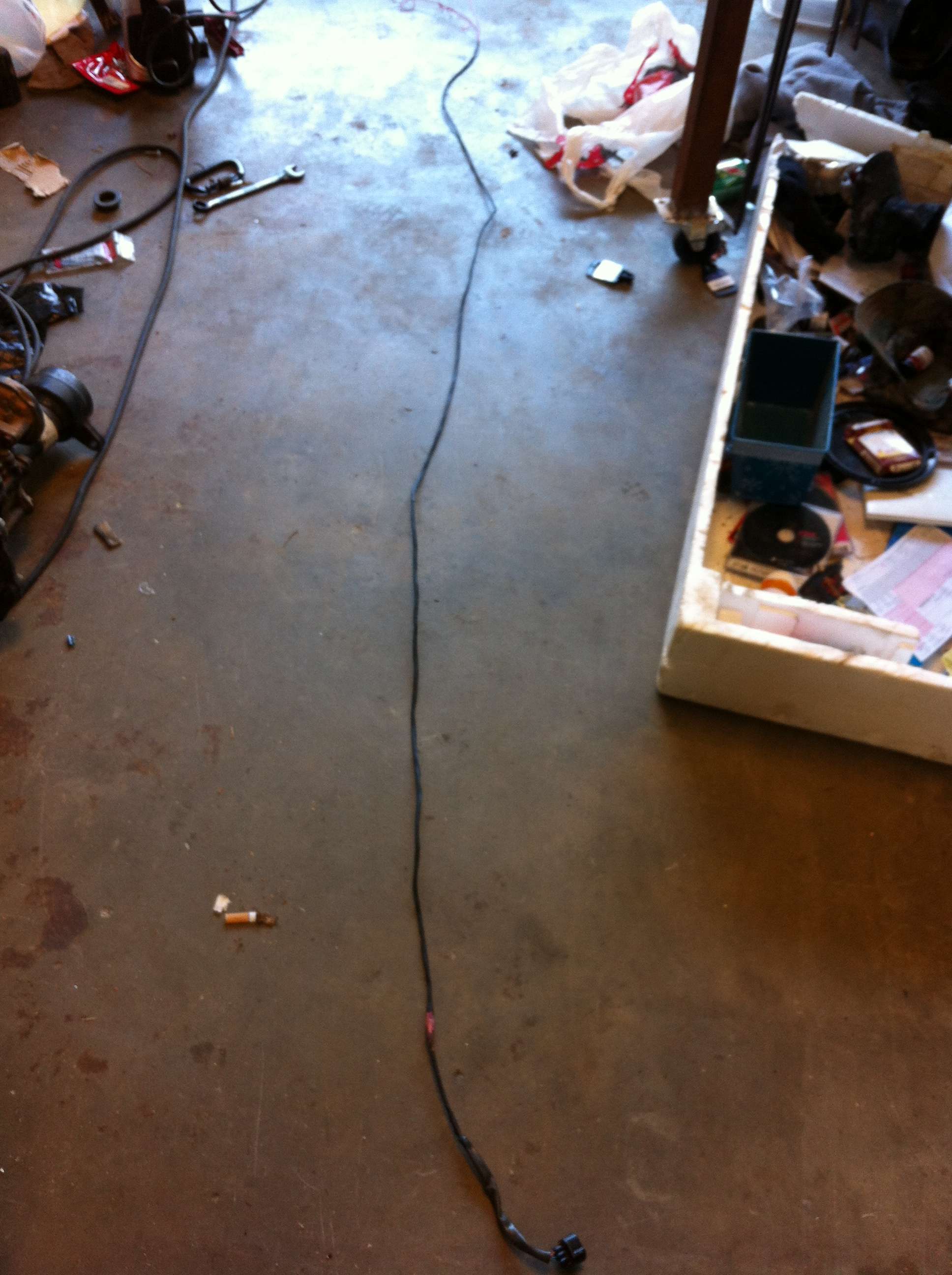

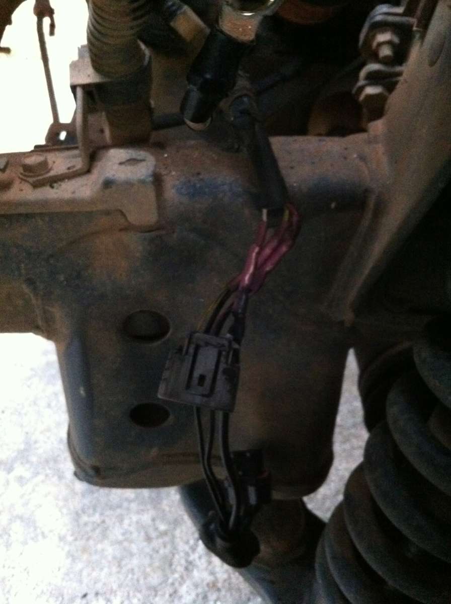

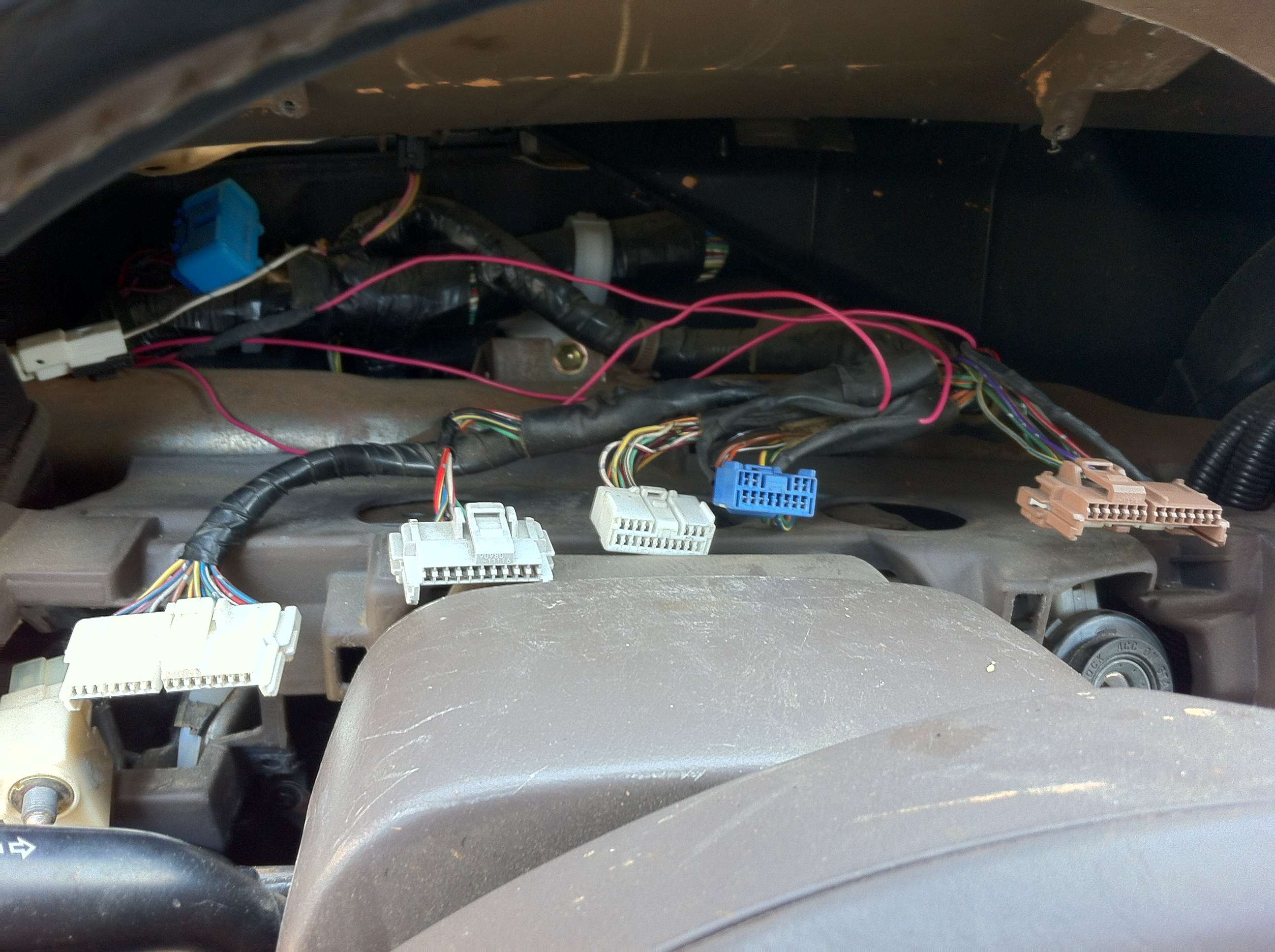

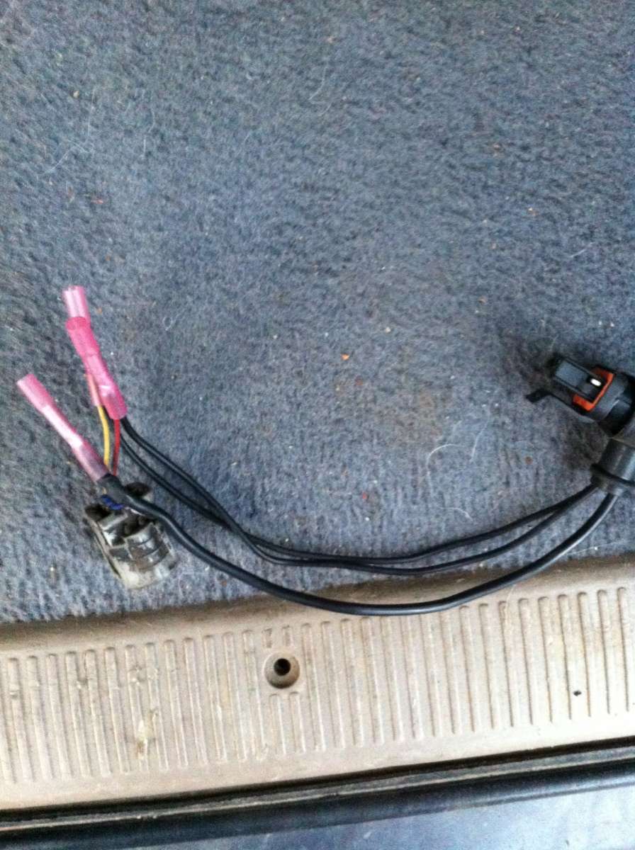

The harness I got from the store was one color. All black. The wires, plug, it all was black.
With a little research, I figured it out.

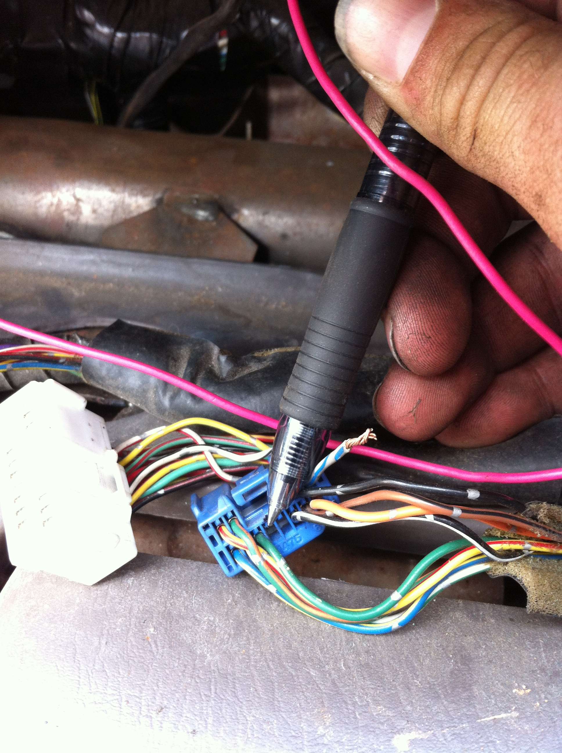

If you look on the plug, there is an S, F, L, and a P.
S is the Sense wire. This is also the thickest wire. This wire goes to the white wire on the Toyota harness.
The F wire is the field/ignition wire. This will go to the red wire on the Toyota harness.
The L wire is the lamp wire. This will go to the yellow wire on the Toyota harness.
P is the stator wire, though there isn't one. It's used to run older style tachs.
There are 4 prongs, but only three wires. Don't ask me why.
Now, you can do two different things here.
You can work in the small area I the engine compartment and try to splice the wires together.
OR, you can do what I did.
I cut the Toyota connector of the harness. :o

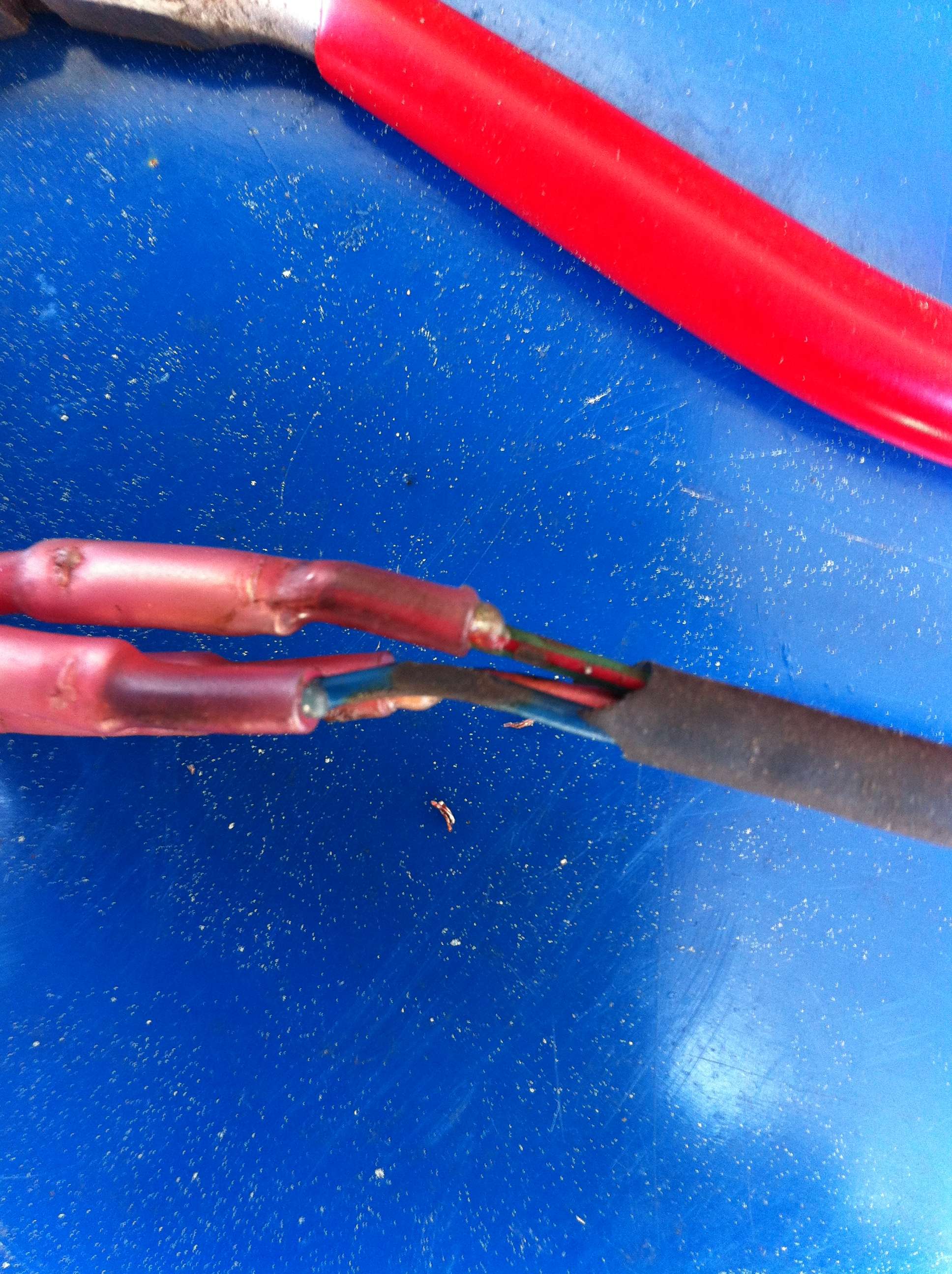

Then, I stripped all the wires. I mean ALL the wires. All 9.
Then, I took the CS144 harness, and attached it to the Toyota connector. I stripped the white wire further than the rest, because I had to solder the white wire on to the thick wire of the CS144 harness. Didn't take a pic of this part.
With the other two wires, I just twisted them together.

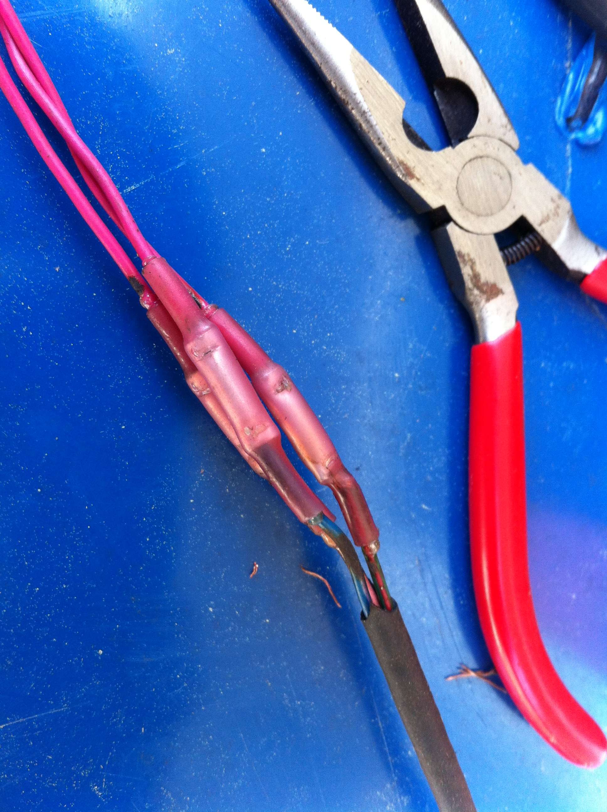

Then, I bought some weather proof butt connectors, and put them on the end of the CS144 harness. Here's what I had:
Then, I brought that over to the front, and put the harness on the other side and crimped it down.
The only wire you NEED to connect is the yellow wire to the L wire. I just went ahead and did all three.

Now, when you put the alternator in, you're going to run into a space problem. Simply solution for this.
Loosen the bottom bracket bolt from the block. Here's a pic. It's a 14mm bolt. The bolt is in the socket, the big silver thing. ;)
Now that that's out of the way, the alternator will slide in easy.
Now, you need a spacer. I used three washers, and tacked them together. A pic:
You need to do one of two things with the post connector. You can either drill it out and bend the tabs, or cut it off and put a different connector on there.
I chose to drill and bend.
After that, put the bolts in, put the tensioner back, plug it in, and you've got a upgraded alternator. More pics.
The CS144 has a 6 rib pulley on it.
The Toyota has a 4 rib pulley.
You can see if you can replace the pulley; you'll need a pulley with a 17mm hole, the size of the bolt on the CS144.
She's gonna hate me for this, but I'm gonna throw these in there too. Best woman I could ask for. Beth.

Now, first thing you want to do is to take your gauge cluster out. If you don't know how to do that, then I'm sorry. I didn't take Pics of taking all the crap off.
Once your Gauge cluster is out, you'll have your plugs resting on the steering wheel. You can see here how I already had this done, just a craptastic job, so I re-did it.
The wires you're going to need from the gauge cluster are going to be on the small blue connector, and the brown connector. They are the Blue and Grey wire on the Blue Connector, and the Black and Yellow Wire on the Brown connector. These need to be cut so you can splice your Speedo Sensor into them.
On your speedo sensor, there should be a Green wire with a Red stripe, a Blue wire, and a Pink wire. On mine, the Pink wire is the Position One wire, the Blue wire is the Position Two wire, and the Green w/ Red stripe is the Position Three Wire.
These wires are going to be extended, and then spliced into the gauge cluster.
The Position One wire(Pink, in my case), goes into the Black and yellow wire.
The Position Two wire(Blue) goes into a blank space in the Blue connector.
The Position Three wire(Green w/ Red Stripe) goes into the Grey wire with a Blue stripe.
I used some "weather Proof" butt connectors from the speedo sensor to my extension wire. These things are pretty nifty. They're basically butt connectors, that are convered in shrink wrap, with a glue in them to seal the wires off.
A closer shot of the glue in there.
Then, to keep the wires all together, I shrink wrapped them all together. This was a PITA. I basically had to cut a section of shrink wrap about 18-24" long, and feed the wires through it one by one. Now, I had only one color wire at the house, and really didn't feel like going to the store to get more, so I just tied knots on the end of them, to remember which one was where. One knot for the Green w/red, two knots for the blue, and three for the pink. Here's a Pic:
The shrink wrap wouldn't go over all three butt connectors, but, like I said, they're weather proof, so I'm not too worried about it.
The Speedo sensor needs to go on the transfer case, at the back. ON the 4Runner, there is a plug where it needs to go. A Pic for reference. That one bolt is all that holds it onto the t-case.
I plugged mine in, and ran the wires over the transmission along the wiring harness to keep them out of the way. Then I ran them into the grommet where the body ECU somes out at the fire wall. Then up behing the dash, just by feeding them up, and pulled them through where the gauge cluster sits.
Now, remember how I said the Blue wire needs to get put into an empty slot in the blue connector? Yeah. It's this one. It's right next to a solid green wire. You can also see the grey wire with a blue stripe that I cut.
Now, all that's left, is to splice the wires together. I took my extension wires, and twisted them to the wires that were NOT on the connector. Then, I put a normal butt connector on them, and crimped it down.
For the Blue wire in the empty space, I just stripped it, fed it through the slot, and bent the wires up so they wouldn't fall out.
Here's a Pic of all the wires connected. You can see what I did with the butt connectors.
After that, All you have to do is plug it in, and you're all set.
