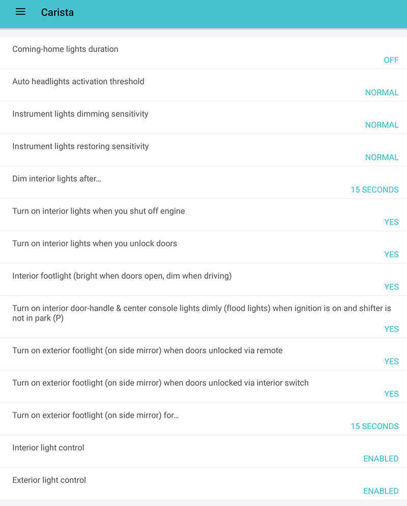

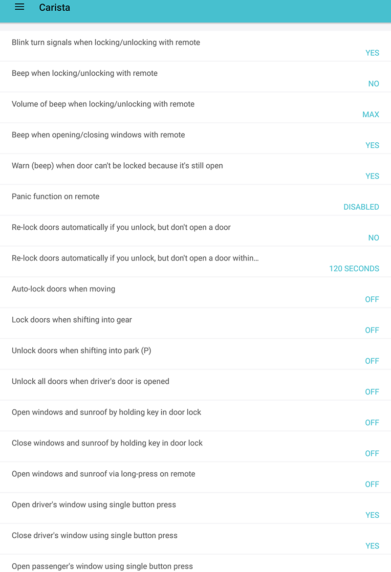

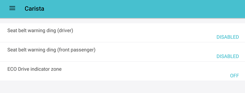

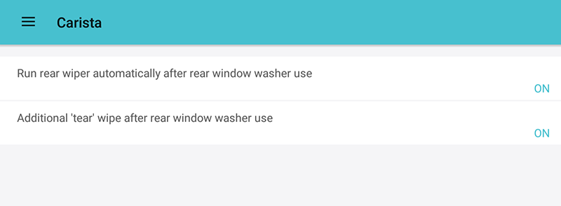

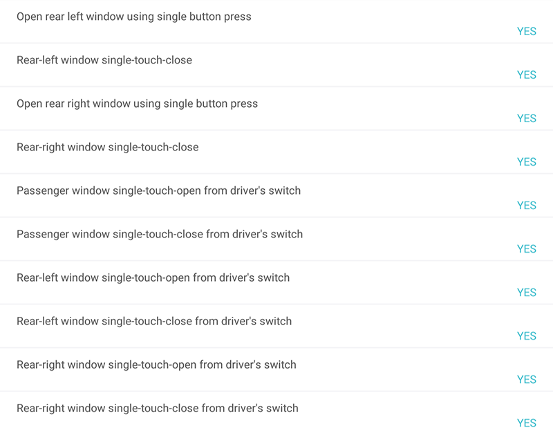

I used Carista on my 2017 and I can verify the following work:
Seatbelt warning ding Disable
Beep when unlocking and locking with remote NO
Lock doors when shifting into gear OFF
Unlock doors when shifting into park OFF
ECO Drive indicator zone OFF
Panic function on remote DISABLED
I used the Carista OBD2 adapter with an old iPhone I had laying around. That had no issues connecting. I tried it with my Nexus 5X and had connection problems, but I think that was due to so many apps using the Bluetooth at the same time because my Android tablet worked perfect.
