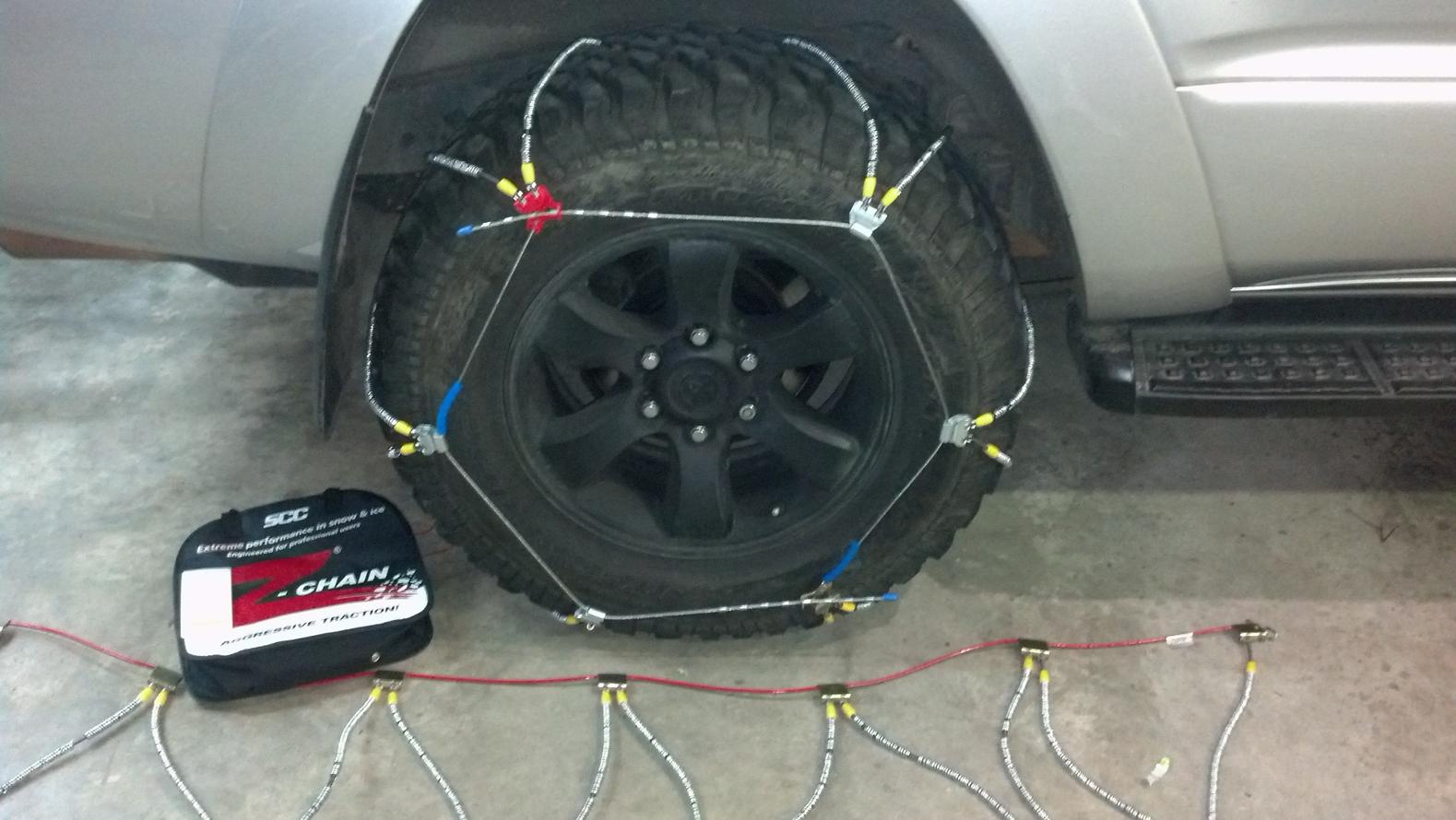

LOL... i am from Alabama.... nuff said.... hahaha..
but truthfully i just wanted to try it and see what happened. now i know.
Plus i bought chains later that week (after the ice storm) just so it will never ice here in Alabama ever again...
