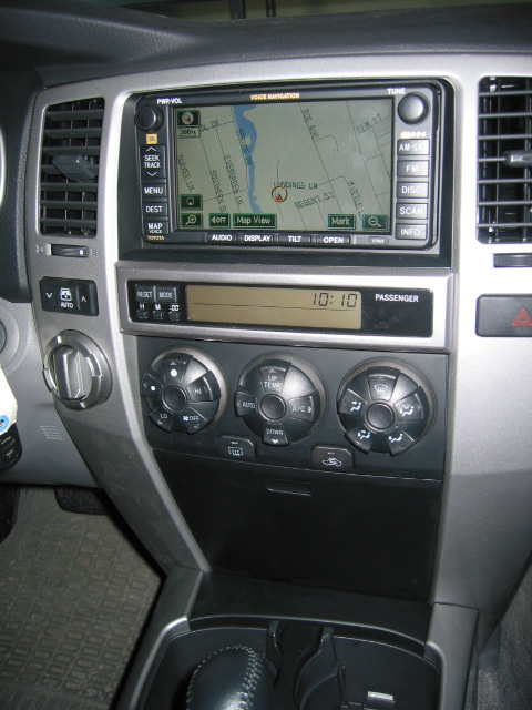

I have the Solara NAV installed on my system and there is no space.. it is exactly the size of the Toyota radio that came with my 4Runner. (and I changed the leds to match the orange... now it is a perfect match.
Gregtay
How in the hell??? Can you post a picture so I can see? Did a frame come with it because I purchased mine from OEM and all I got was the HU and 2 wires.

Here is a photo that shows the NAV unit installed without gaps. (I just stole this from the old thread.. didn;t have time to get my camera out last night... but my install is the same.
I think you guys are having the following issue: The NAV uses a different radio surround piece. those of us with early 2003 (and maybe others) happen to get a radio that also required the same surround.. so we can add nav with a perfect fit. If you have the "flush" radio (which I think is the only option today) then you would need to look up the parts# for a 4Runner with NAV. I think you need a new radio/dash surround (the big piece of plastic with vents) and a new clock/trip computer/ac control panel. There should be two part numbers for each.. one for 4Runners with NAC and one for 4runners w/out NAV. (I was lucky... my 4runner had the NAV panels from the factory because my radio has the same face panel size as the NAV.)

Did you have the JBL 6-disc unit before you installed the NAV? If so, the reason you have the space is because the 6-disc unit is bigger and has a different trim piece around it. The single-disc units are the same size as the NAV units and have the right trim piece. So just buy the trim piece for the single-disc players and that'll get rid of the gaps.
Re: Re: BUY THE 2006 NAV
Exactly.. i had the single CD +TAPE JBL.
BINGO!!
THANK YOU!!!!! You just nailed it on the head. I did have the 6 disk in dash JBL. How come when I asked the guys at Toyota about a certain trim piece I might need, they looked at me like a deer in head lights. THANK YOU, THANK YOU!!!
