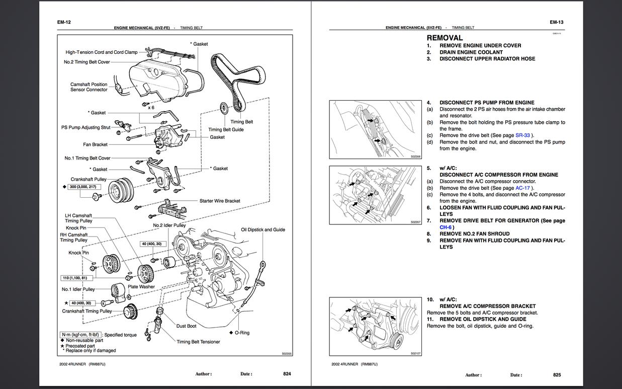

Hey guys! I'm almost finished rebuilding my engine!!! One of the last things I need is to put a nut on this bolt. It is right next to the fan pulley. I looked at the OEM diagrams at the dealership, but we couldn't seem to find the right part #. Does anybody mind crawling into their engine bay to see if this bolt has a nut on it or if it is just left as is. Thanks!
