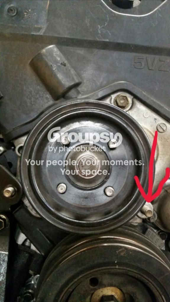

Hey guys! I'm almost finished rebuilding my engine!!! One of the last things I need is to put a nut on this bolt. It is right next to the fan pulley. I looked at the OEM diagrams at the dealership, but we couldn't seem to find the right part #. Does anybody mind crawling into their engine bay to see if this bolt has a nut on it or if it is just left as is. Thanks!

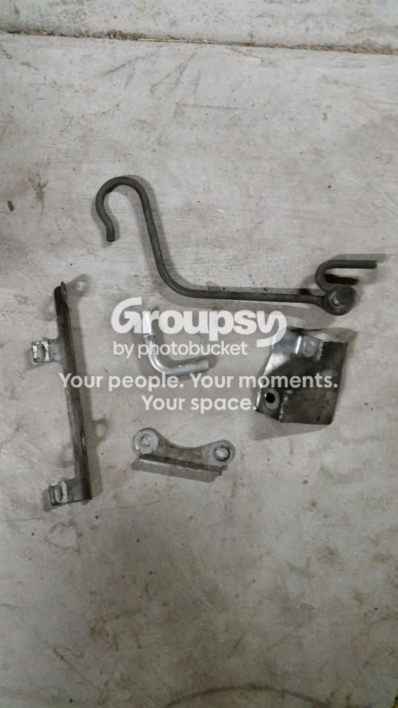

Since my friend and I didn't take the engine apart (at least not the passenger head), we don't know where these pieces go. They are obviously not critical, but I would like to get them back into place. I was going to look for them when I went to the Pick-n-Pull, but they don't have any 3rd gens available to look at.
Does anybody have any idea where these go? I'd really appreciate it!!!
The long skinny piece goes along the front of the motor where the oil pan and the block meet. It holds the cable to the starter, which is within a plastic piece that clips into the slots on either side of the piece.
The squarish piece mounts on top of the alternator, right above the alternator to battery wire. Some sort of cover or shroud. might even protect from the heat of the exhaust manifold as it partially mounts right next to it behind the alternator.
The long hook thing looks like something like an exhaust hanger. Not quite sure though.
The other 2 pieces look familiar. The one piece of piping looks like a piece to the rear heater tubing. Not sure on that one either. Does it look like it's been cut off?
