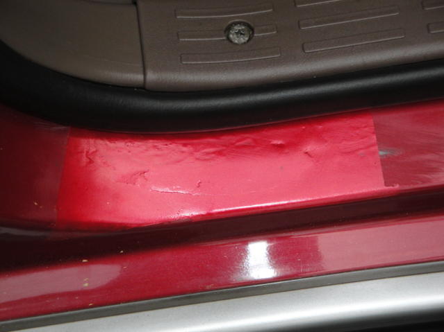

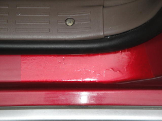

Here are the pictures to these weird rust that is under the driver side door and passenger side. Got any ideas how I can repair this?
EDIT: Got it all fixed up. This isn't the best and it's my first time doing it, but there was one problem I ran into was the paint that didn't match the car color... :wow2:
Driver side: DSC00231.jpg
Passenger side: DSC00230.jpg
Passenger side: View attachment 44134

Since its in the door sill, and not really visible. I would sand down and remove all the rust myself and then put some touch up paint on it and call it done. It may not look perfect, but it will be protected and no one will probably even notice given its location.

If you took the 4 screws and the molding off and then lifted the rubber door seal off the body, you probably will find the start of the rust. Which probably is the 3 or 4 pieces of sheet metal welded "Pinch Weld" together from the factory. Sand, salt, dirt etc love pinch welds.

I've had issues in the same area. I simply did what cfrank1 advised, and took the rubber seal off after removing the molding. I then took a wire wheel with my angle grinder, and cleaned it up down to the metal. Some rust paint, then scuffed, with some Duplicolor paint, and a coat of clear....and good to go man! Just make sure you either mask off the surounding carpets, or use a cardboard to block off while you're painting. I use the cardboard method....works like a charm!

Yeah, I'm probably going to do the same thing that you did with a angle grinder to clean it up and use Duplicolor paint for it.

Ok, I'll take a look by taking 4 screws, the molding off and then lift thee rubber door seel to see where the rust is starting. :thanks:
Whatever you do, do it soon!
I've seen that same rust issue on several runner's.....and if you don't deal with it, it will rust completely through. Then you're really screwed....because water goes INTO the rocker and starts rusting your entire rocker panel from the inside out. Eventually the whole bottom edge of your truck underneath the doors with be cancer.
Fix it right away, and hopefully it's still on the surface. If it's already made a hole.....try to get the rocker cleaned out with some suction and then load it with some kind of water displacer.

I know I got to do something before it rusts through the rocker panel :wow2:
You could also drill a hole into the rocker.....and spray inside with some lubricant....I shoot oil in mine every fall. I also oil spray the entire undercarriage, inside the fenders, doors, and rear hatch.....saves the sheet metal man....it's messy...but will keep your truck looking good on the outside for years to come!
