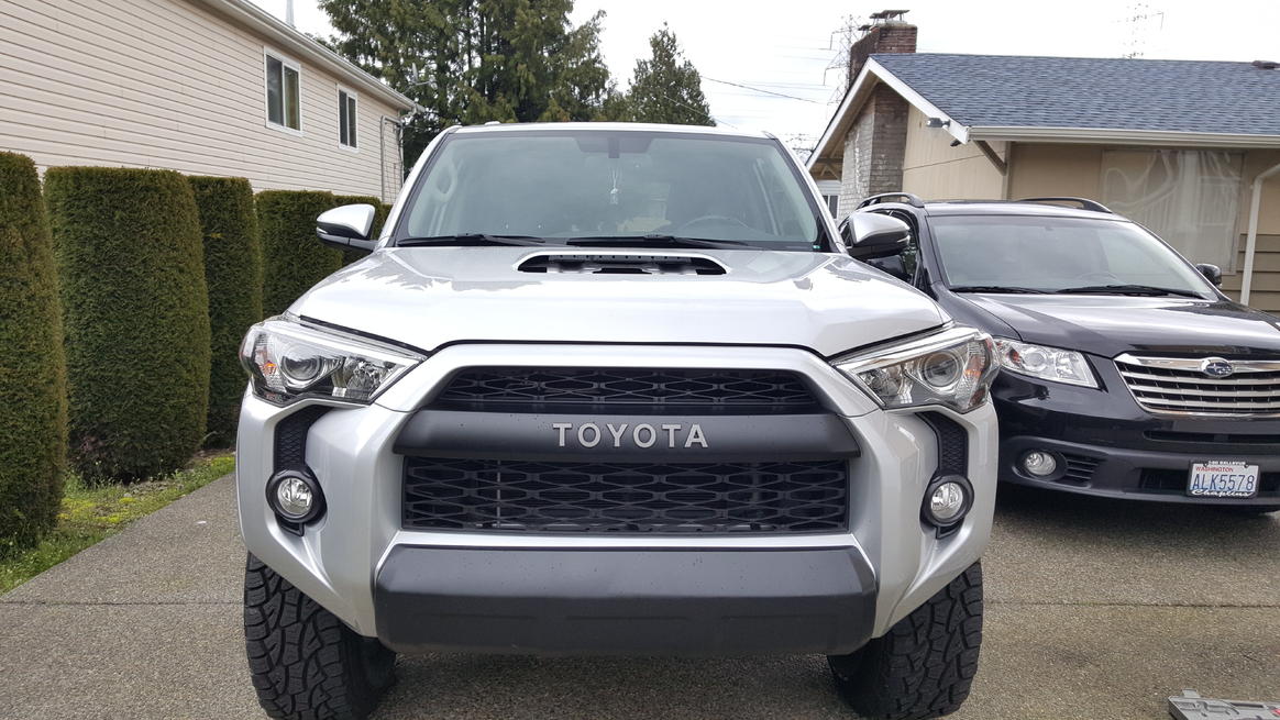

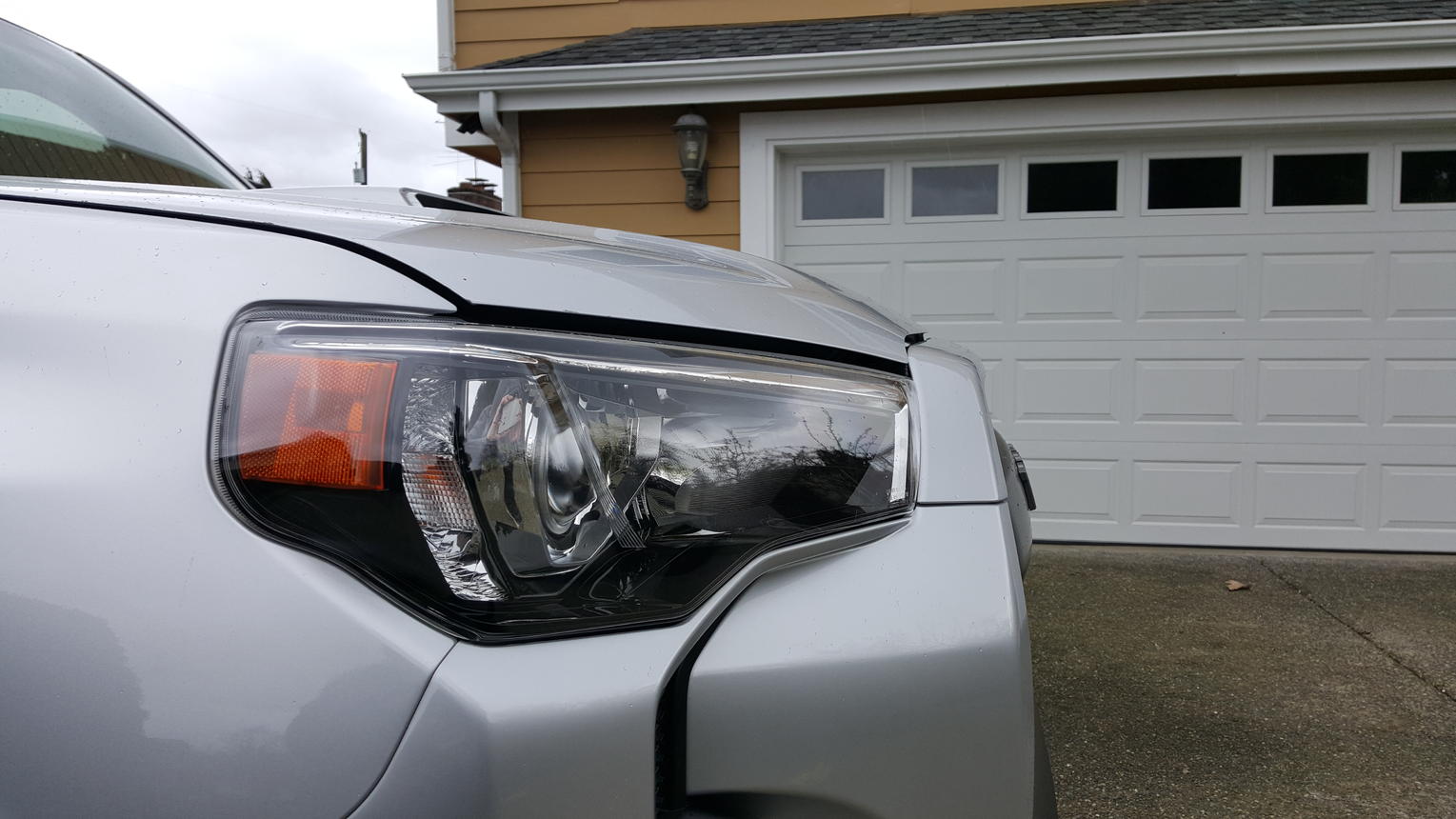

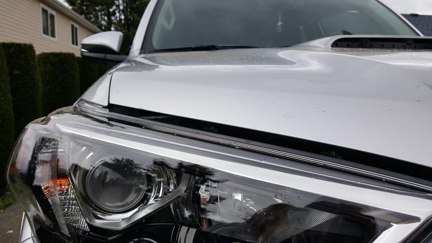

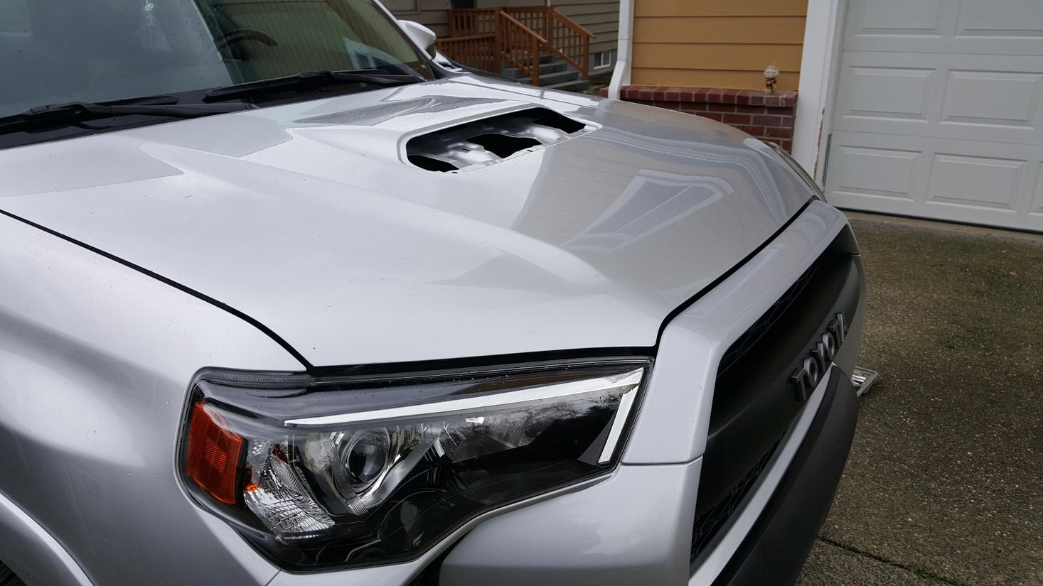

Does this TE hood look repairable?
Seattle206
Senior Member
Installed it and it looks like its twisted. My auto body guy says he can try to tweak it back to 90-95% and get rid of the gap in the front. Paint plus labor, $350.
Thoughts?
Looks like it could be adjusted by the hood catch or even shifting the hood on the hood hinges. I would also check the rubber stops underneath.
Take the rubber stops out and slowly close it. See where it sits. If it drops, the stops are the issue. May need to trim them. Hood looks to line up okay side to side so don't think it's twisted.
I'm pretty sure there was a fella on here with the same concern. He posted a DIY on how to close the gap. It's worth a search rather than fork out $350.

TE hood scoop
Congratulations! You have one of the few TE hoods with a truly functional scoop. Wish I had one like that. :clap2:
Good luck squaring the gap.

Picked up this oem TE hood for $200. Installed it and it looks like its twisted. My auto body guy says he can try to tweak it back to 90-95% and get rid of the gap in the front. Paint plus labor, $350.
Thoughts?
What looks like happened to me is the hood was off and stored incorrectly they had it on some sawhorses or something and then piled things on top of it and it slowly deformed the hood. I've seen this many times in classic muscle car collectors who do not know how to store a hood properly they'll usually bend up the ears from stacking it on the end. I would almost be willing to bet anything that it was improper storage.
Ps I don't think it'll ever be correct again
What are the chances of a reputable shop getting it close to correct again? I messed around with the hood/radiator bumper and it did close the gap a tad bit. My autobody guy looked at and is confident he can get it straight, if not, no charge.
The hood closes, latches and locks as it is now.
Sounds like it might be worth a shot, good luck.
