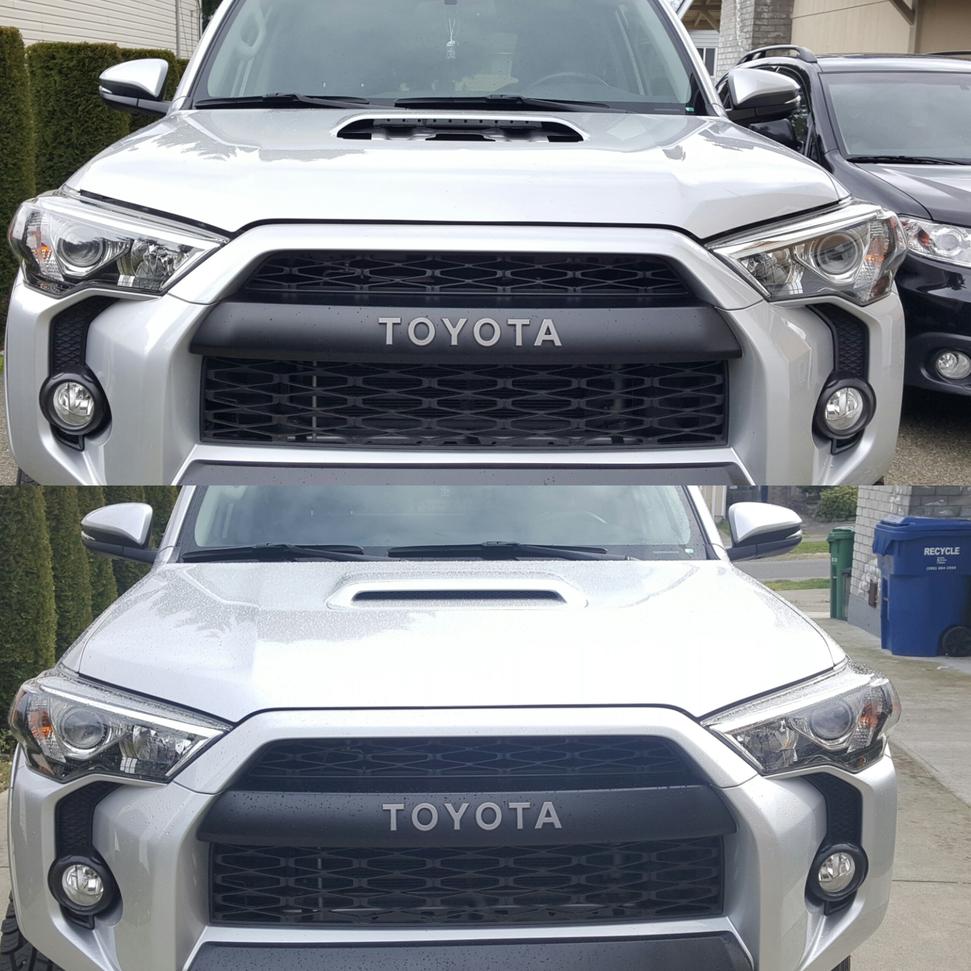

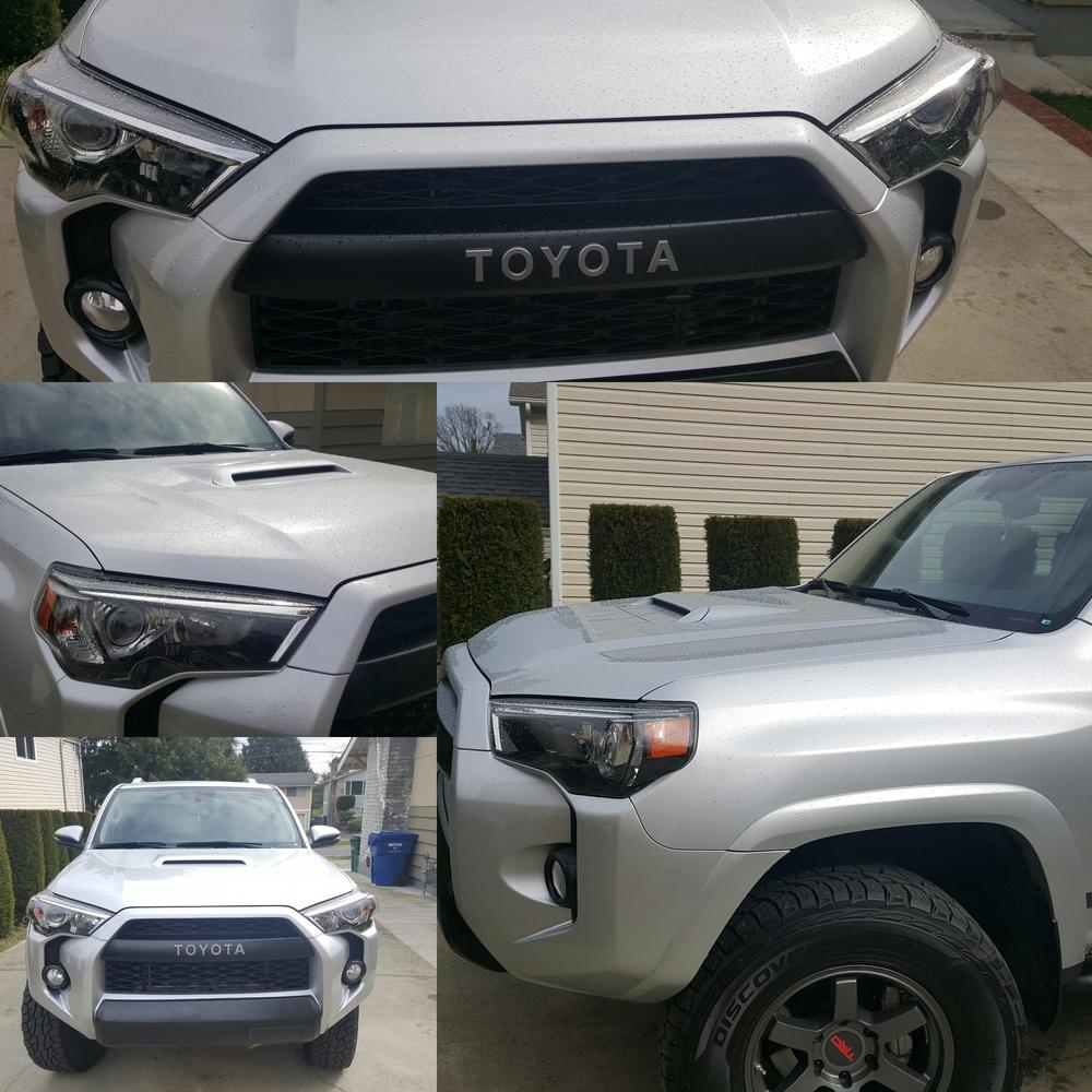

Does this TE hood look repairable?
Props to body shop. They were able to straighten the hood and did an excellent paint job. Sorta made a come up on this deal.

We get hoods like that to align by placing a 2x4 on the latch so the hood doesnt close and two people one on each side place pressure on the front of the hood and on the side that needs to be lower the person would easily apply more pressure to bend the hood down and align the gap. Its simply just bending the hood. People never notice and their always happy with the results wondering how it was done.
Pretty much what they did, 2x4 and two guys on each side lol. Then they massaged out any ripples in the hood, sanded, primer and paint. They did an excellent job. Talked them down to just $300 for labor and paint.
