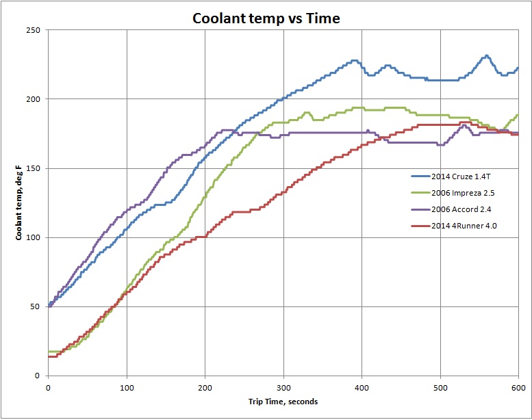

This is the closest I had on-hand.
Main issue is I missed a merge in the 4Runner at 200 seconds. So, instead of accelerating to 65 and staying there, I missed the merge lane and hit a light (~250s) and got on at the next merge at 330 seconds. I'll have to try again soon since all of the other vehicles have the exact same route/speed.
