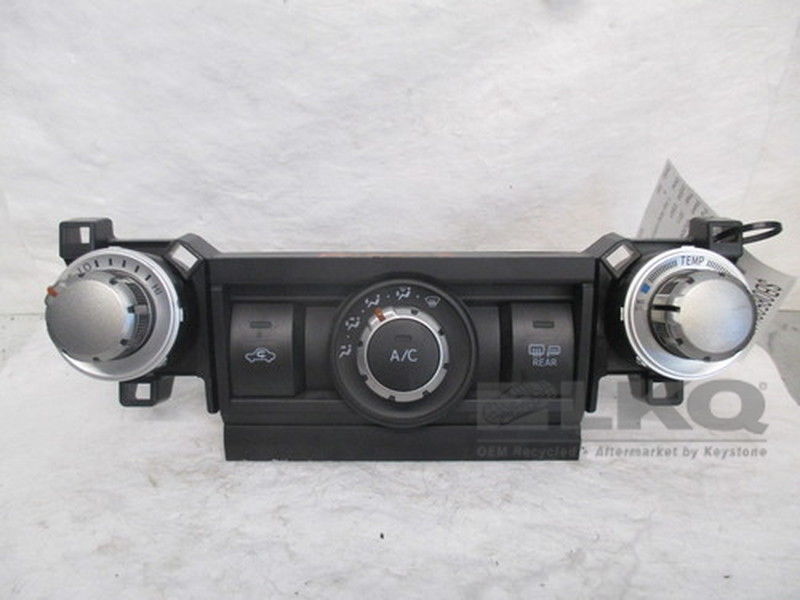

Yes living in CT I think the heater in the 5th Gen sucks. This is how I deal with it. I have a remote start on my truck so I adjust the center control knob to defrost in the morning just in case my windshield has frost. Once I get in the truck, I switch the knob to the top & lower vent setting and it definitely warms the truck up faster.
I make sure I start my truck 15 minutes before I leave as well. I leave it in the top & lower vent mode the rest of the day.
