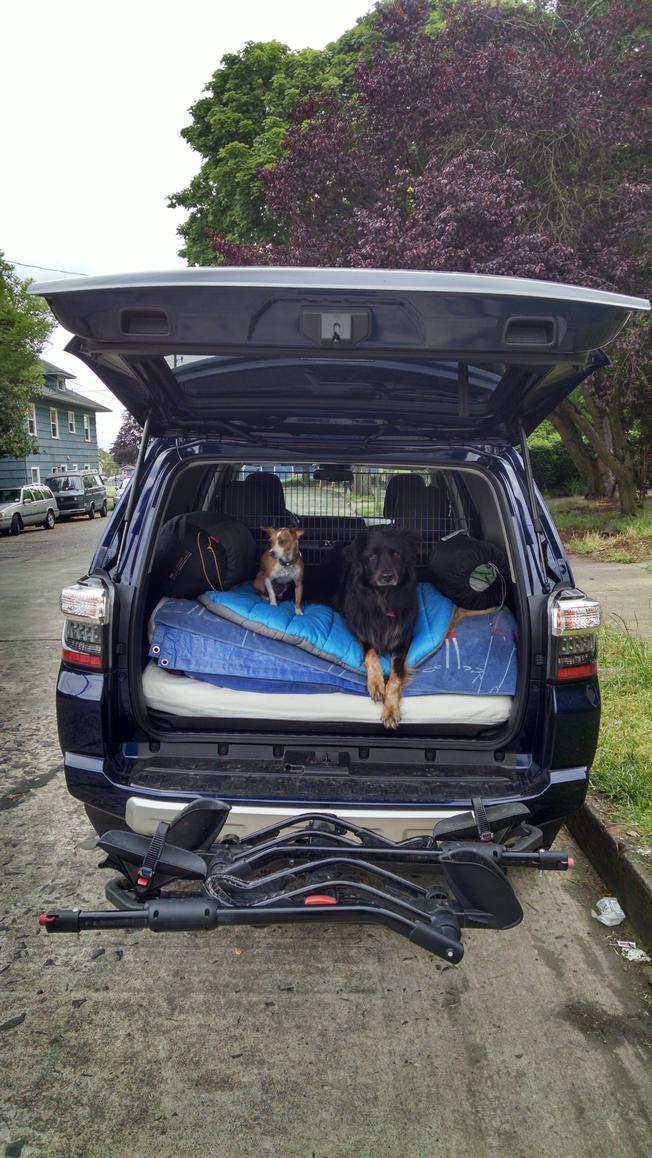

Here is our setup-
This was a trip to Ohio shortly after we got the new TE. Plenty of room for our dogs in their crates, as well as our luggage and stuff. The crates are also for their safety.

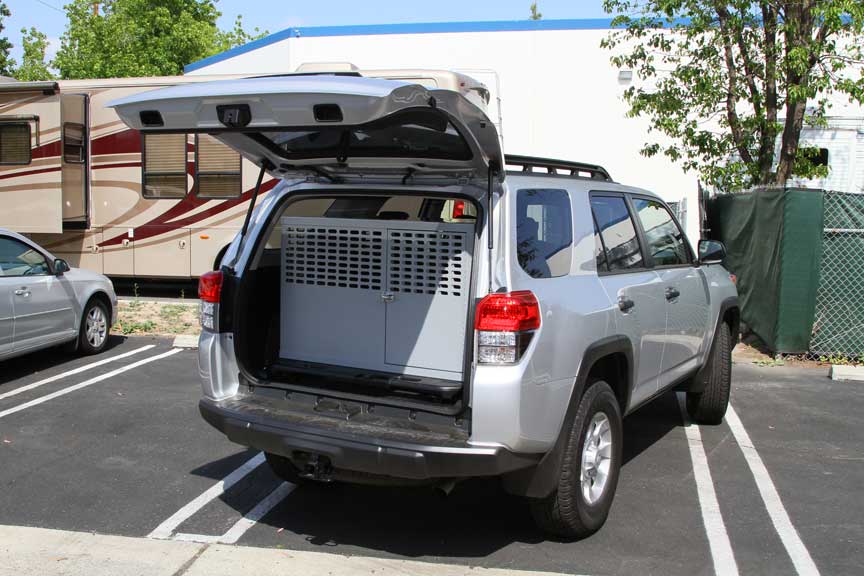

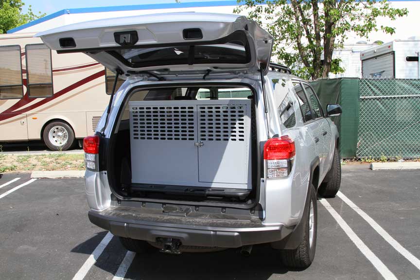

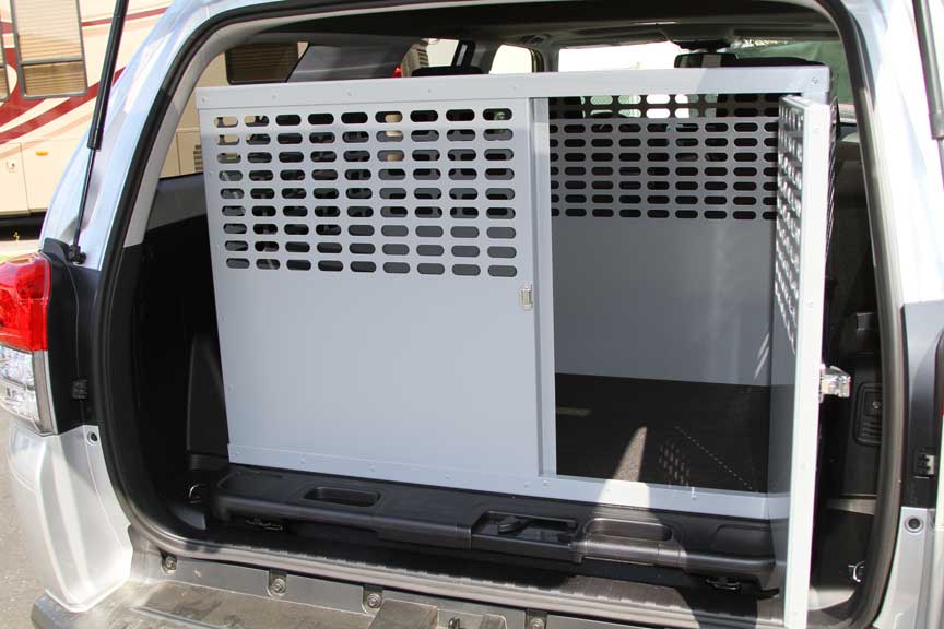

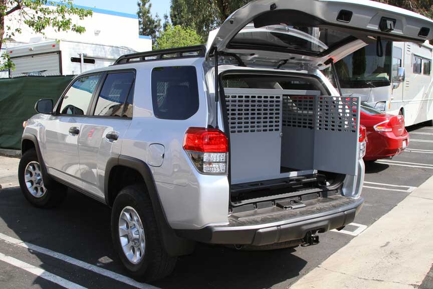

Hey all... I just finished my custom dog crate designed for the cargo area of the 2010-2013 trail 4runner with the sliding cargo tray! I think it looks great. What's your opinion?
Specs...
.063 THK 6061-T6 Aluminum Aly
42 wide x 28 deep x 32 high
Rivet construction
Slam latch

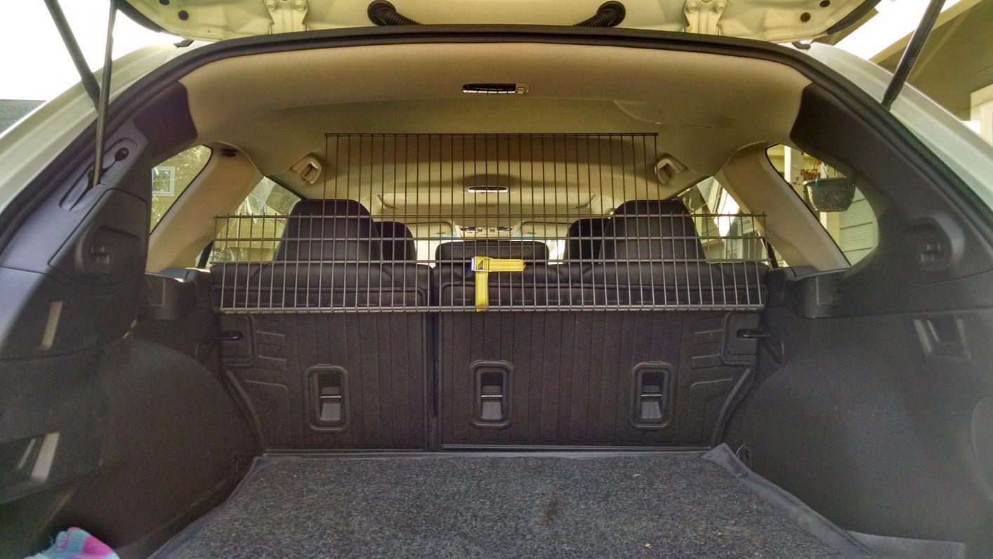

I know this is a little late, but I've struggled over a good barrier option as well. I've ordered and tried the one from Amazon that only connects to the headrest and didn't like it because it rattled. I have not tried the floor to ceiling kind because if there was to be an accident, that seems kind of dangerous. I've tried to connect elastic netting but there aren't very many places that will spread it properly to actually block our dogs.
My solution - get a heavy duty grey wire shelf. I got mine from Fred Myer but I'm sure Home Depot or Lowes sell the exact same ones. I don't know the exact length of it but I'm guessing it's 36" wide by about 18" tall, mine cost $14! Put it as far into the car as possible and with a marker, mark where you need to trim so it can be custom fit to the curves of the car (you'll see what I mean from my pictures). I used a bolt cutter and a metal file to cut and take off the sharp metal edges. Then, connect it with a cam strap to the center headrest. No rattling, very secure, super cheap, and easy to put in and take out.
