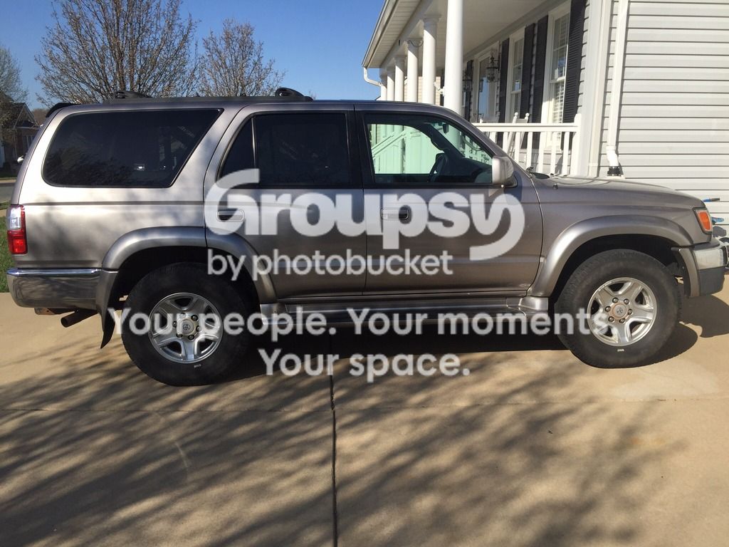

Here she is as is. 2001 SR5 4wd with 104k. Nothing special really, just an average stock runner in need of a few mods. My goals aren't extreme off roading, more so a well maintenanced, capable of occasional off road adventures that would stop every average f150 driver out there.

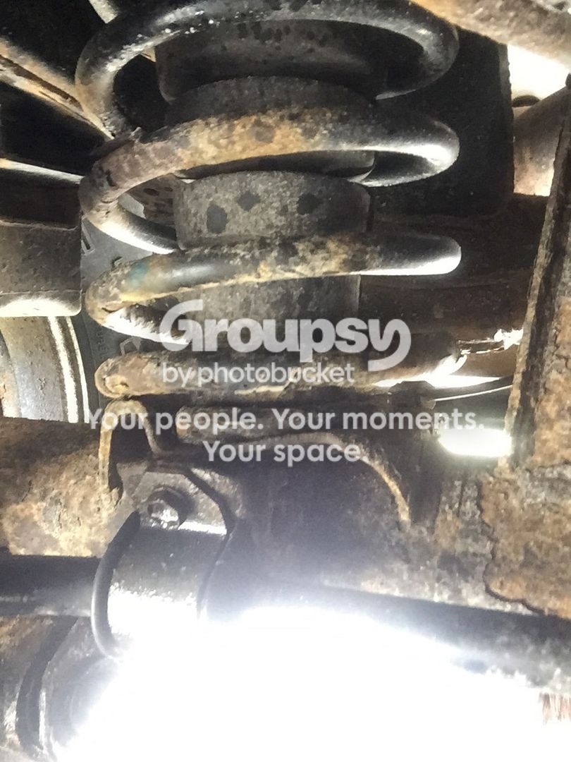

After buying it I took an in depth look at the rear end and one side is actually sitting on the bump stop! This will be my first suspension job and the rear rust is the only thing standing in the way…well, that and the parts. Here goes!

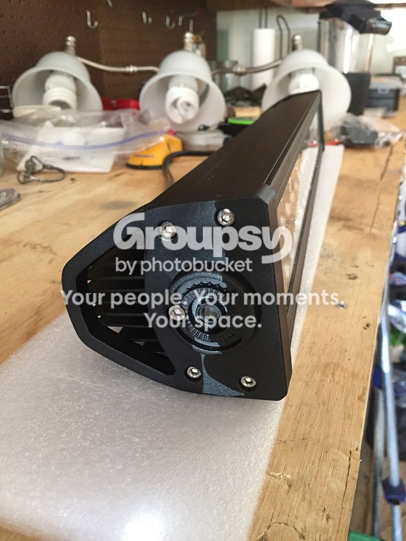

If you wouldn't mind posting some pictures or a write up when you take the light bar apart to reseal it that would be great. I have researched this, but I couldn't find anything with pictures. I'm also to afraid to rip a brand new light apart without any sort of guidance haha.

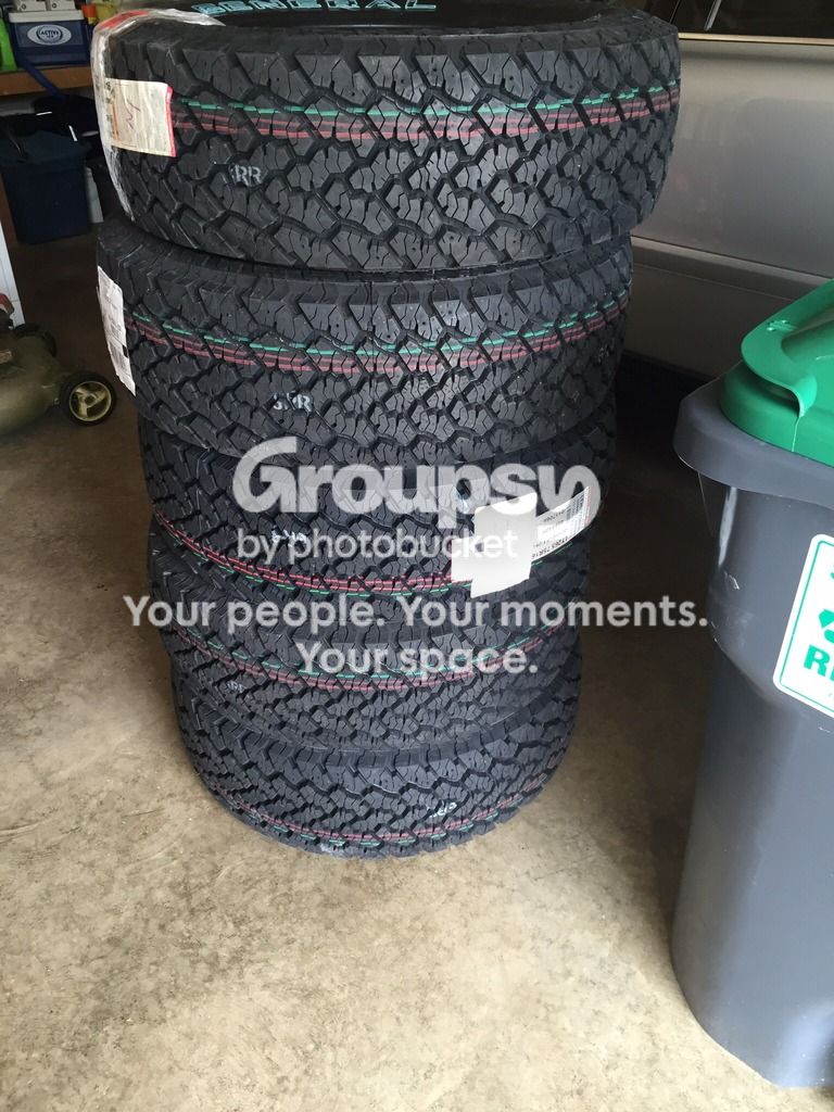

Pricing 5x tires hurts my soul a little. Any recs on what 5 shoes I can do at the $1000 mark?
A lot of decent brands and options, it really depends on what you want to get out of them. Maybe some Dueler Revo 2s? As tempting as it is to get the gnarliest looking tires, for a daily driver that only sees occasional forays offroad, something that maintains stock MPG and is quiet on the highway is high on my priority list. Cooper ATPs have a good reputation here and elsewhere it seems, for being very versatile and livable tires priced competitively.

Shop around on tirerack.com. That'll at least give you an idea of what you can get in your price range. A good all terrain would be the ticket with what you say you'll be using your vehicle for.

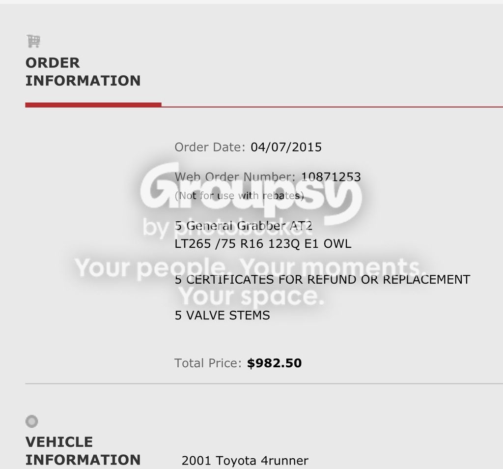

General grabber at2. That's what I like. It's decently light and a good traction tire. 5 I believe is close to the 1k mark but not over it.
Tires
All the reading I've done and I was still pretty stuck in the 285/75/16 mindset. The 265/75/16 drops the price right into my range. Tire rack doesn't offer any road hazard for the tires mentioned above, but discounttiredirect.com does so I think that's where I'm going for the General grabber AT2 for $984ish with the $70 rebate, "free" shipping, and what they call the "certificates of refund or replacement" which I can use to replace a tire I shred apparently.

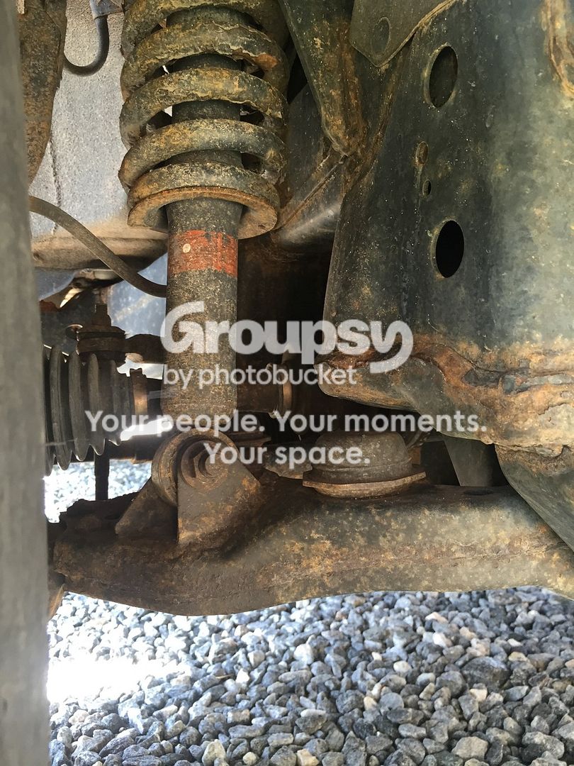

Front bump stop gap with nothing in the truck. Other side looks the same. Stock gear Damn near quit by this point.
Rear. Yeah, that's touching.

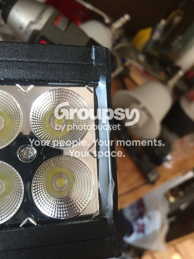

Light sealing

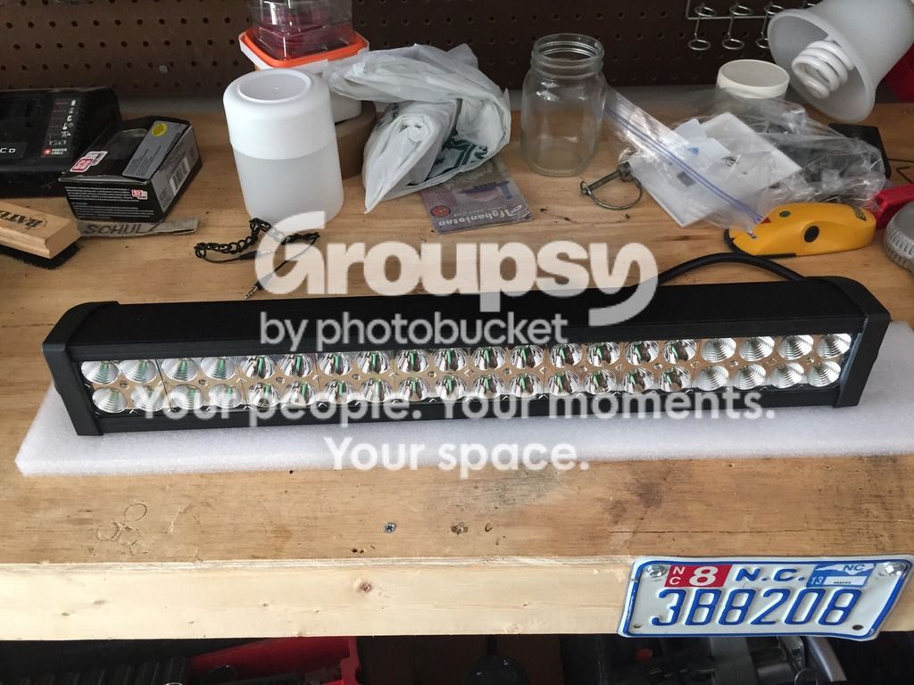

So here's the 24" light I got for the front bumper.
Side view.
side removed.
Long story short, it was already sealed. Not sure how to improve on it. Couldn't disasemble it any further without pulling what the manufacturer put in. Easy mod!

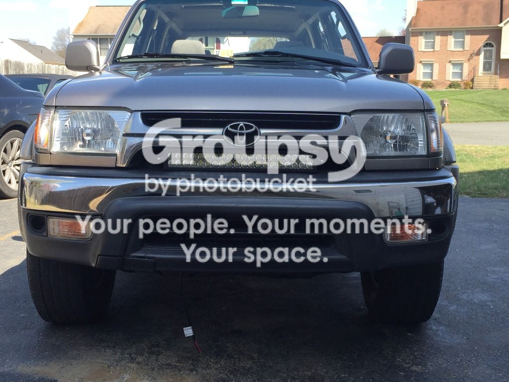

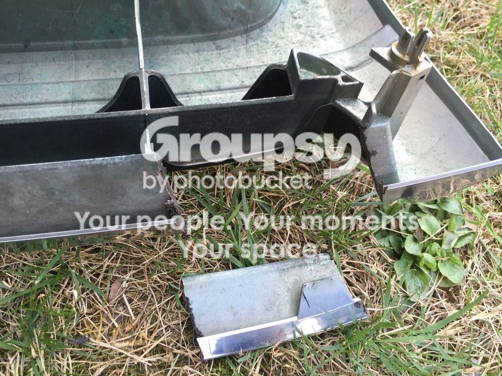

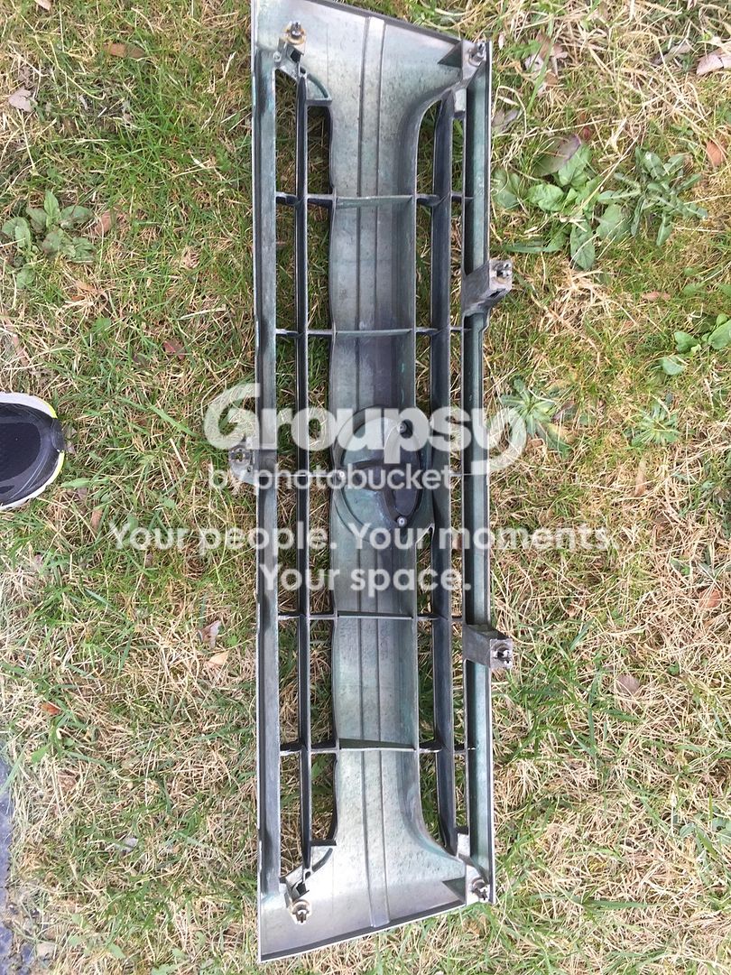

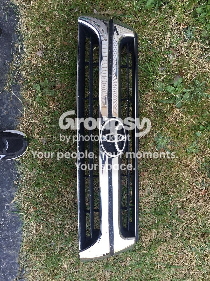

Where to put the light

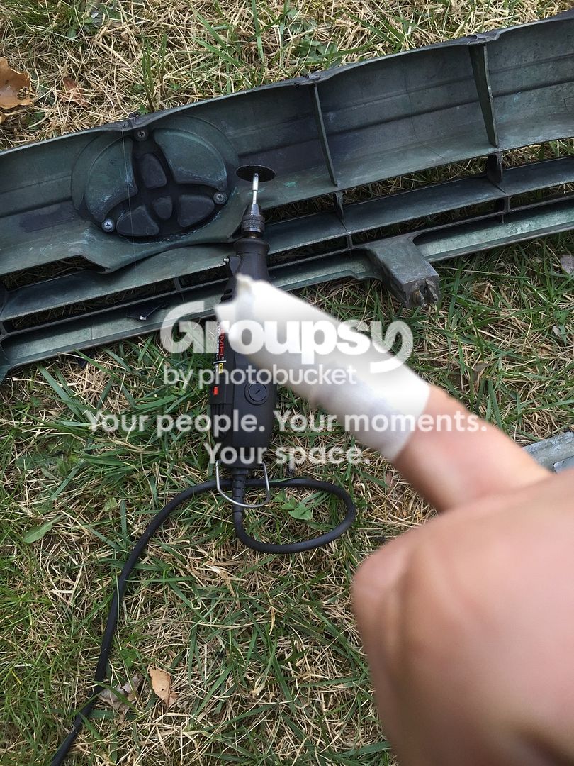

Planned on putting it in the lower half of the front grill. Pics below of the Dremel work. Handy little tool.
Front
Rear
Cut tabs out to gain access to other angles. Used a small cut off disc.
The "wear gloves" pic. This thing will dig into you faster than you can figure it out.
Cutout finished and lightbar put in for spacing and mounting options.

Tires
Bought these.

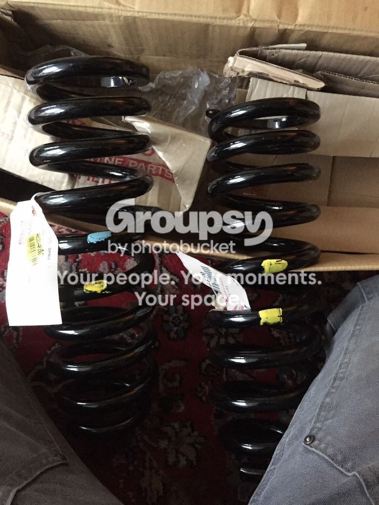

Pumped. Everything should be here next week. Now I'm reconsidering the 2" lift and wondering if 3" would be better. Means I need a diff drop and what else? Speedy's lift doesn't require one at 2" but what perch setting for the front 5100s and how will I match the rear? Spacers?
