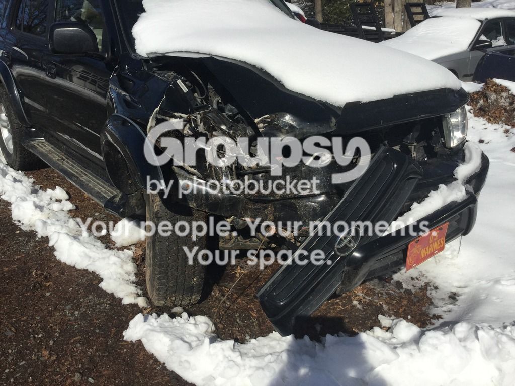

This is what I did to her last month, hence the need to build a new one.
And at the junkyard

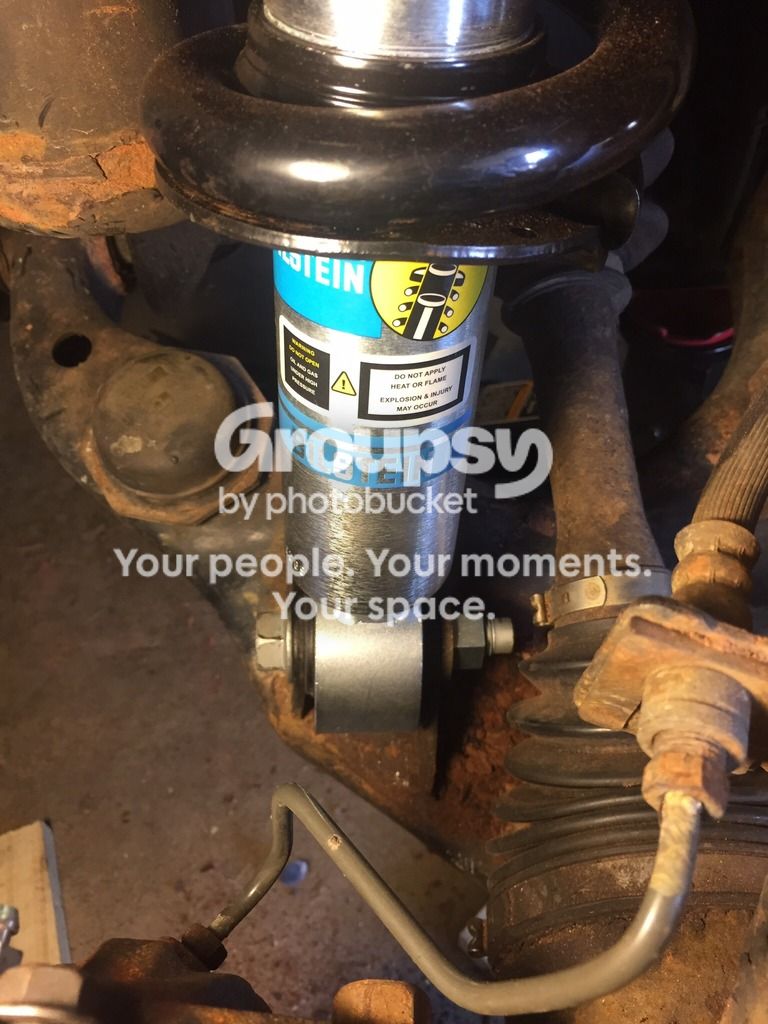

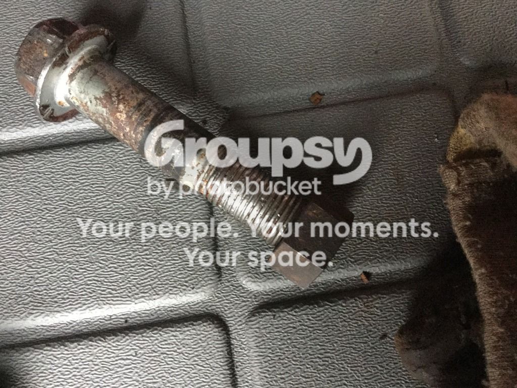

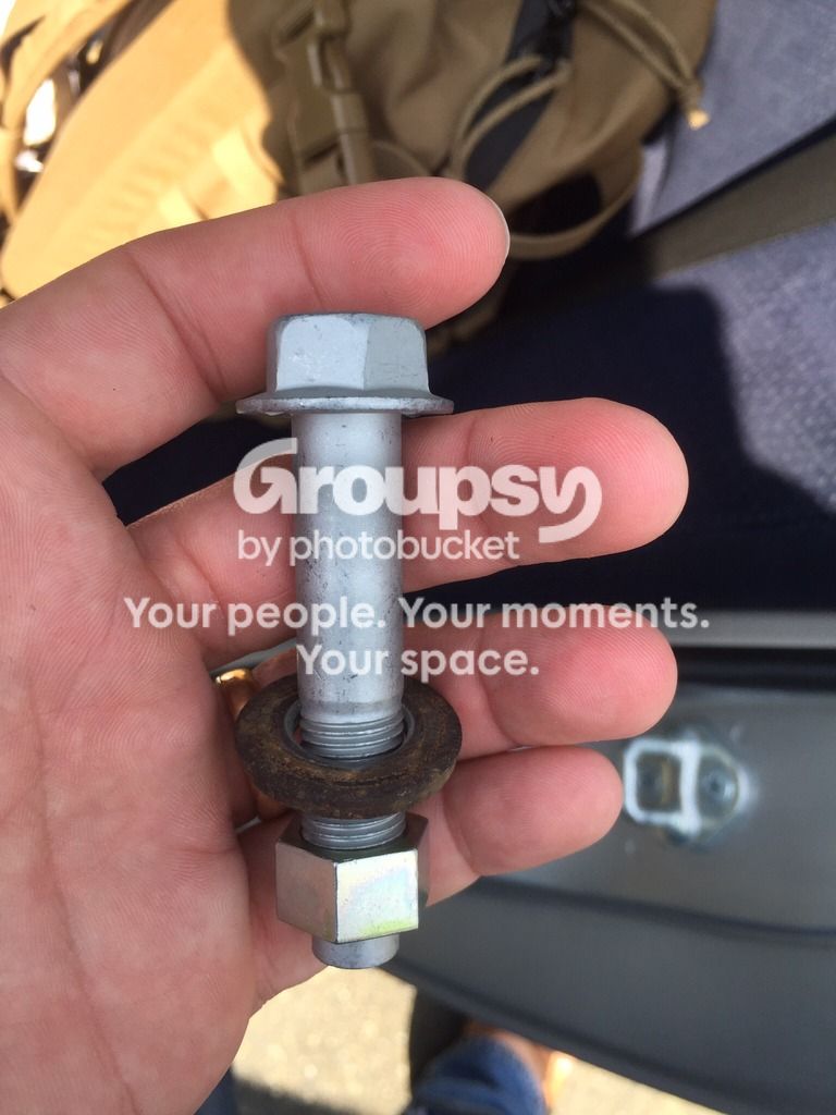

Lift arrived and I started yesterday. More work than I thought it would be with my rust situation. Stripped the first front lower strut bolt to come out so that got ordered today from Toyota. Couldn't find one at any lowes or advance auto type place. Working the front sway bar bushings in as I go too. Pretty easy for that stuff.

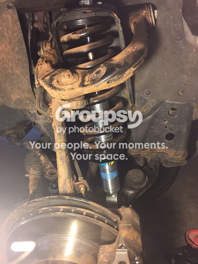

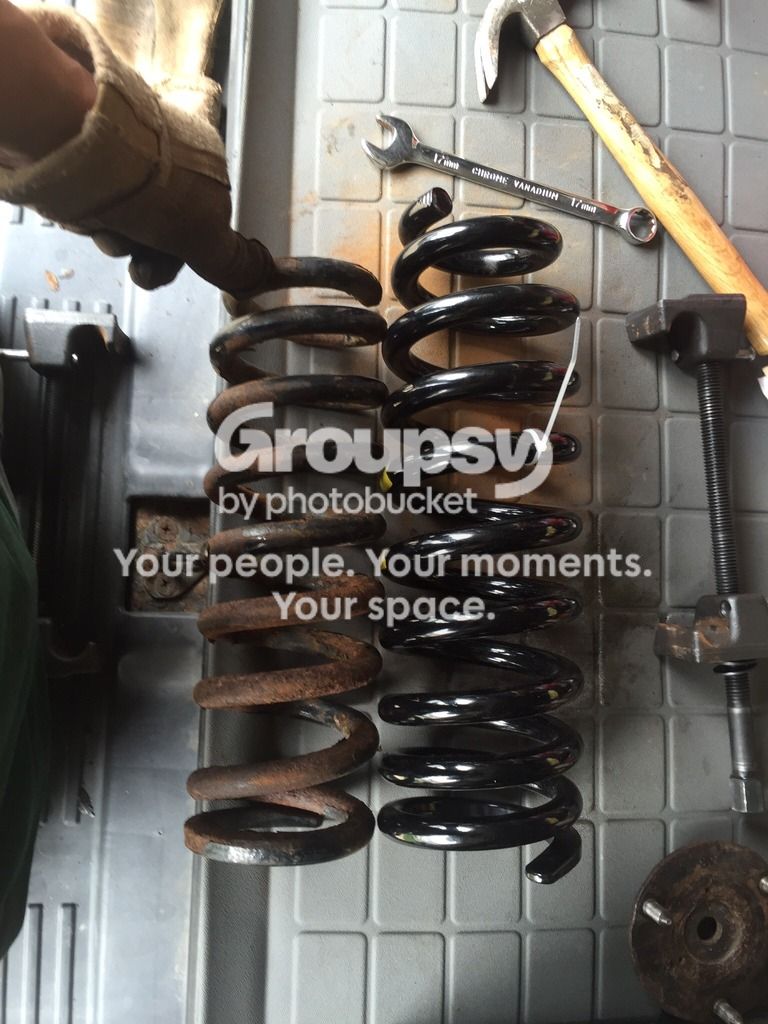

Front driver spring comparison.
Didn't get the front right out without some stripping.
New bolt from local Toyota two days later
And then I was able to finish. That's just one corner.

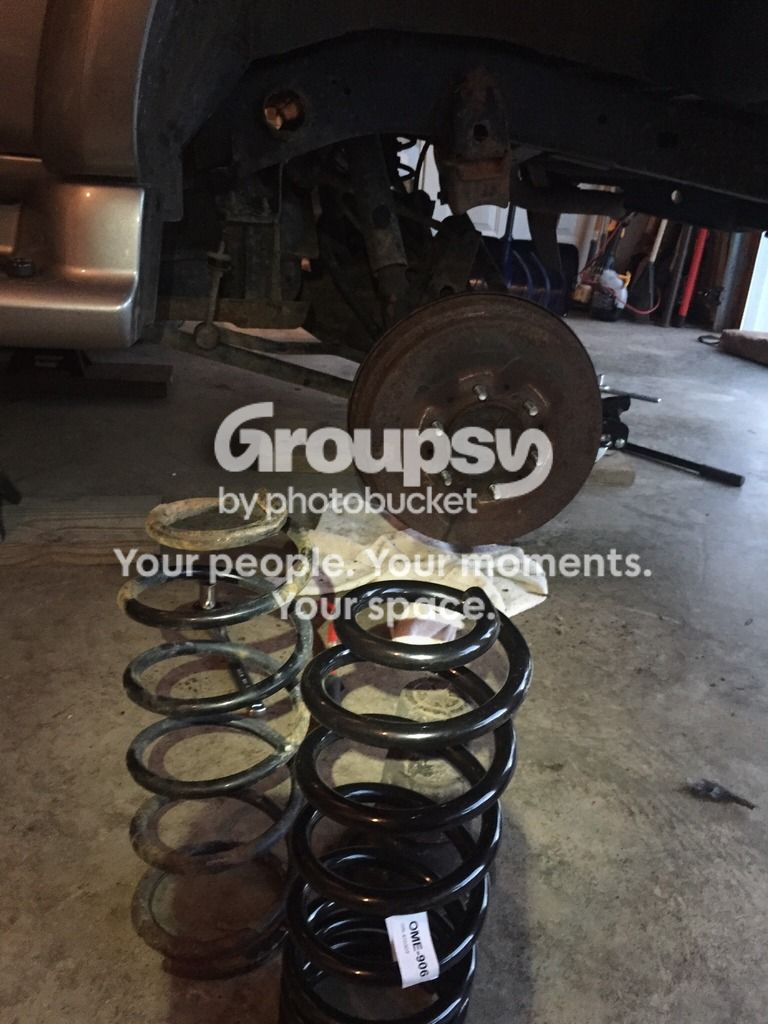

Sort of rear spring comparison. There really wasn't a lot of difference between stock height and OME 906s.
The rest of the rear was a beast. Took much more time than planned with rust and tight spaces. Speedy's lift install make it look much easier than it is. Be ready for this to take more time than you think if you're looking at your first lift or a heavy rust situation.
I ended up sawzalling both rear struts off at the top bushing mount that I could access from lack of ability to turn the top nuts. No amount of strap wrench or vice grips helped. Getting the new ones in required a wench and Allen wench combo in the very confined space where Toyota hid the top nut mount. I'll just say that those without patience need to just save your money and let someone else be frustrated by this!

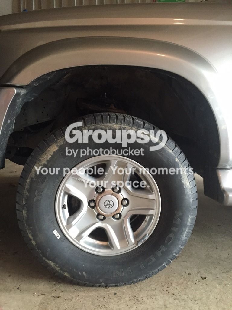

Ok so the front right didn't take me as long as the other stuff with some lessons learned. Below is a picture of the setup post install prior to tire.
Lift complete!
So it took nearly a week between broken stuff and waiting on parts. Really, all I broke was a sway bar end link top end when attempting to remove the top nut and then there was a stripped front strut lower mounting bolt.

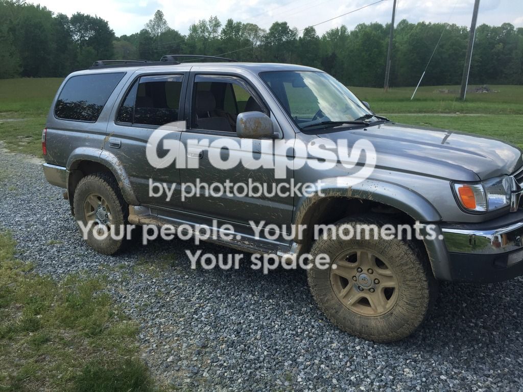

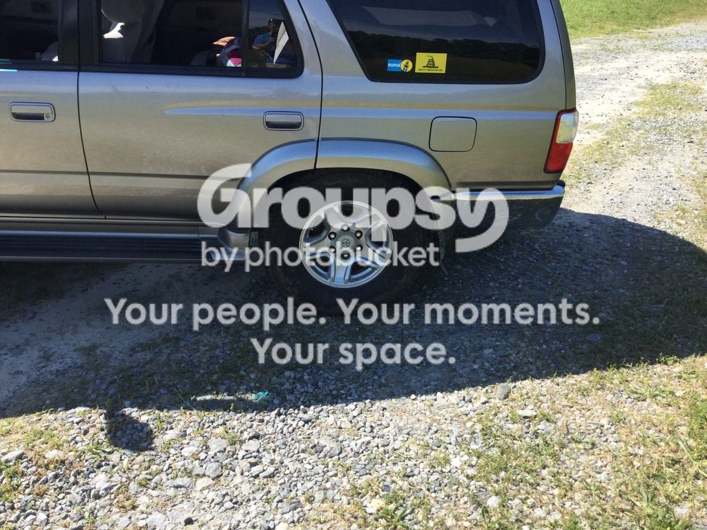

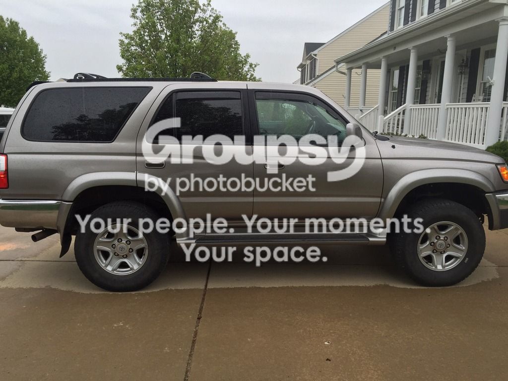

Below are before and after profile pictures.
Before
After

Not sure what the deal is with the drivers side rear. There's no significant weight other than a full gas tank, which might make sense. I made sure to use the taller OME 906 that came from wheelers on that side but is it possible to install those backwards? There was no reference in the purchase process and nothing in the package, I just compared the. Out of the box and made a decision.
The ride is markedly different and comfortable. Recovery from potholes and speed bumps is much more controlled feeling and much less harsh on the passenger area, as well as audible noise. It is clearly taller from the perspective of a driver and I guess I'd recommend it to others updating from a stock setup though it certainly isn't the cheapest. The good news is that it can be done, with a bit of flexibility in man hours and patience. I'm a fan thus far, and ready to get her off road and put it through its paces.
Stilllllll can't decide that I want the running boards off. I think it looks just fine but know that it helps with clearance, just not sure that I really need it at the end of the day. With about 15" of clearance I just can't see a non-dedicated off road vehicle needing an extra 4-6". That's just me, but I'm happy to hear what others think.
Yeah I'd say remove them as well. If they are in good condition and you are patient, you can get $$ for them too. If I remember correctly, I got $100 for mine after a few months of them sitting on craigslist!
I vote to remove. Adds another couple inches "lift" visually.

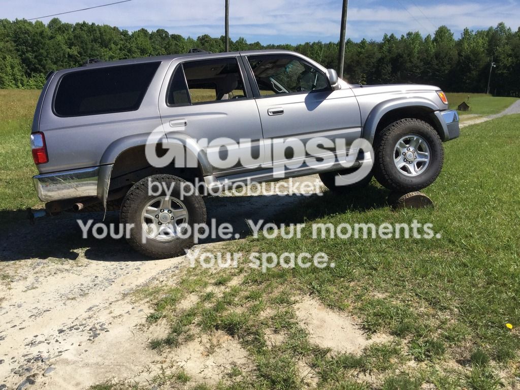

Sunday flex. I know a lot of guys on here do much more with theirs, but I'm easing into accepting risk....which is ironic for me. Anyway, here's a little runner porn for ya.
No rub
