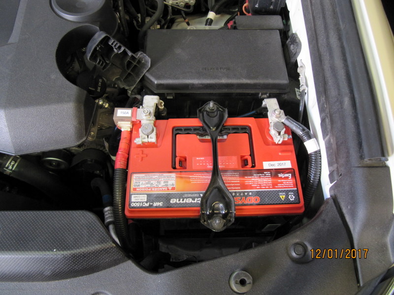

OP you could upgrade the battery to the Odyssey 34R PC1500
Order the spacer and this bolts in in 10 minutes. No cable mods needed.
Yes its spendy, but its no fuss.
Ignore the extra cables attached to the battery post in the photo they are for a dual battery system.
You will not need this mod for your requirements.
NOTE: if you order this battery make sure its the Reversed post "R"

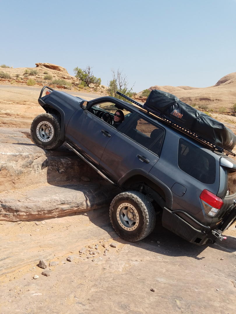

I thought about the dual battery thing for my friends 5th gen, it turned out that she wanted to use the fridge when camped for up to a week and have the battery charged without running the engine and also power a laptop during the day while still not draining the battery in 110 degree weather. It turned out that the only thing I could think of was to for us to make a custom roof rack that held her tent and a 100w rigid solar panel with a PWM charge regulator that is constantly connected to the battery and provides enough charge to recharge the battery and run the fridge and computer simultaneously. Here is a pic of how it looks, its all steel made with unistrut and mild steel. The solar panel is mounted flush with the front of the rack in front of the tent.
