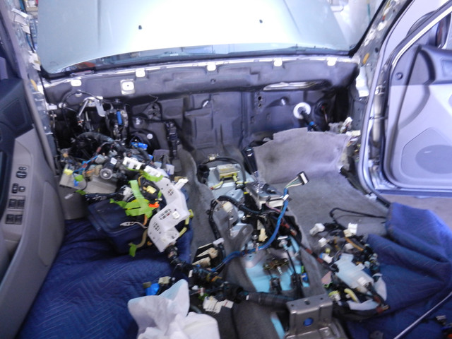

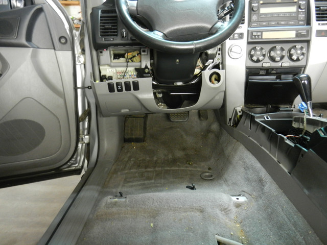

I have just done the unthinkable, a complete A/C Evaporator teardown and replacement. OMG is right! Complete with pictures :trophy:
Total Time: 18 hours!
Total People: 2
# of :censored: Too many to count :dammit:
# of :beer: Got a kegorator - didn't keep count
Climate Control: 4 Ton A/C on Wheels piped into the rear of 4Runner (check the pics!)
How did we do it? :rtfm:
How many parts left over? NONE! :party:
SEE ALL THE PICS
