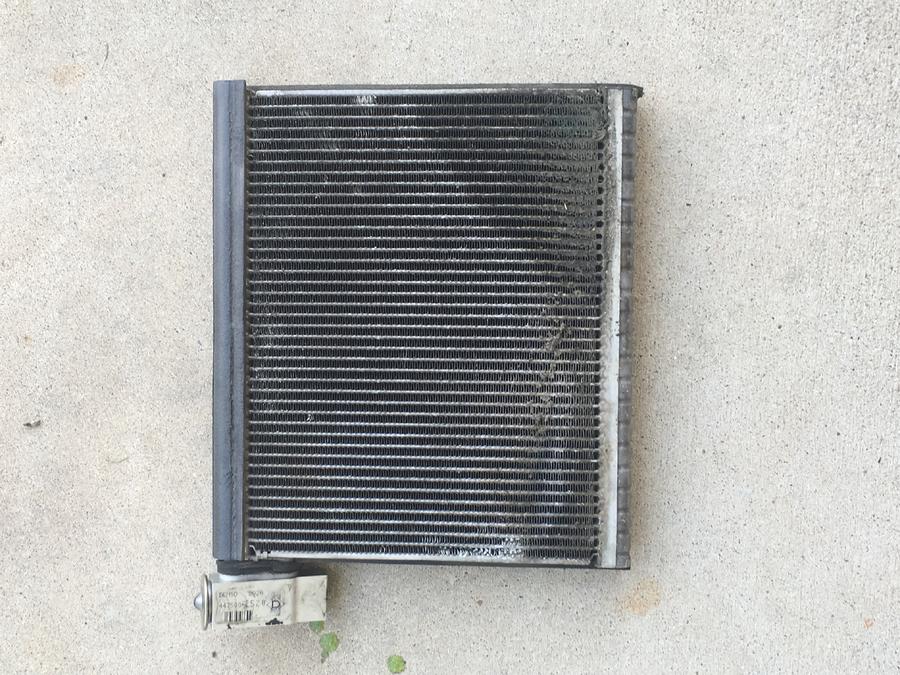

Well, I'm off on this fun adventure finally. Not sure if we are working too fast, but we have the HVAC box removed in 4hrs. Evaporator and expansion valve are back in the housing and we are going to begin reassembly tomorrow.
Not sure how you could do that with the upper tabs from the bar going into the box and the 2 arms coming down blocking it from being pulled straight out?
We were able to remove the HVAC box without completely removing the crossbar. It was super tight getting those tabs free that slide through the box from the bar, but by just loosening the bar it did work.
Finished up today. Took about 7 hrs for reassembly, along with condenser replacement, vacuum, and charge. Definitely glad that project is over, but it wasn't as bad as I thought it would be. Things we did that vary from the FSM (at least I think because we didn't use the FSM) include loosening the crossbar but not removing, and we didn't remove the front seats. Not sure how much time that saved, but total labor hrs probably were somewhere around 9-10 for just the evaporator.
