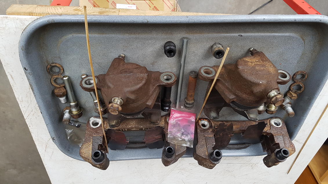

Photos of prepared rear components
View attachment Rear brake service_Photos.pdf
Attachment has photos of the serviced components.
Note the small package of pink grease that is used for rubber bushings, piston seal and metal bushings.
After removing the original rubber bushing, two in the center of the photos, the pictures show before applying the pink grease and after application of grease (rust on the bush) to the exterior. An original bush was used to clean and lubricate the interior of the channel guide housing by installing and then removing the bush. To install the longer bush a handle from a spark plug wrench was used to move the rubber through the channel. Very sturdy material! It would be possible to reuse these components.
Even though piston was cleaned the external area remains slightly corroded. Will not impair function.
Used wooden sticks to apply grease and clean the grooves of the housing receiving the piston seal.
Used a metal polish to clean the cylinder slide pins and lubed them with the Toyota PINK grease as it is compatible to rubber components.
Pleased with the OEM material! Cleaned up well enough for service.
