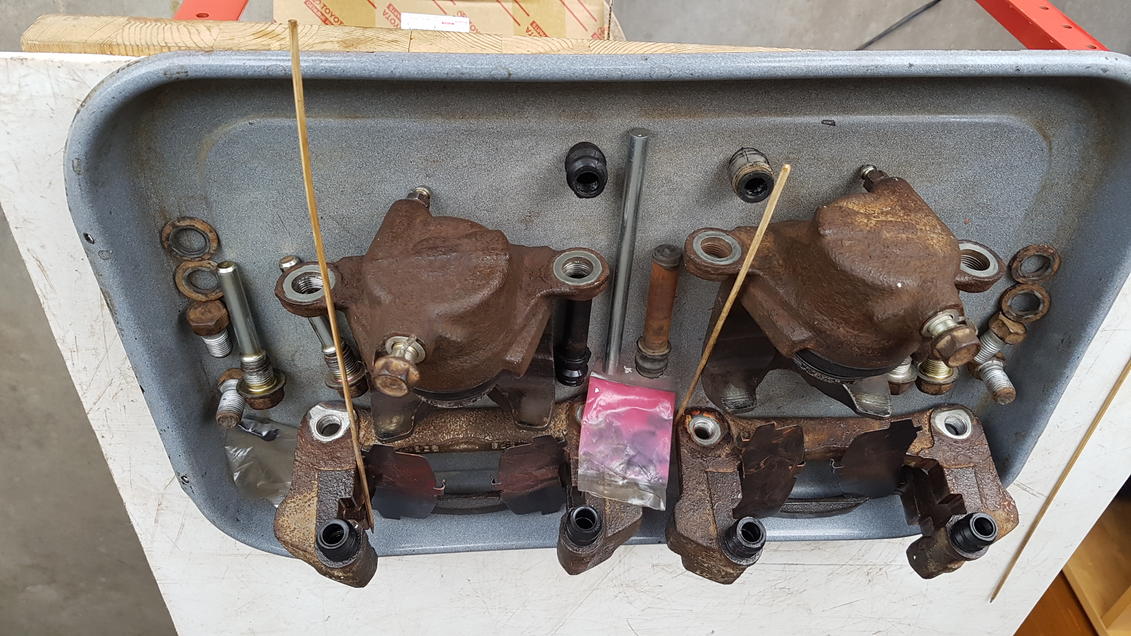

Just some insight that I want to put out there. On all the brake rebuilds/replacements I've performed, the key problem is allowing rust to form under the piston boots. Once rust forms inside, those rust particles cause the piston to seize/freeze. The grease I've used is what Toyota sells. It's that pink grease. I've since switched over to 3M's Silicon paste. I also paint my calipers everywhere including where the boots sit. That way there's no chance for rust to start anywhere or creep up under the boots. Silicon also handles heat and lasts longer. Most other greases aside from Castrol's Red grease is going to give you headaches. Permatex grease regardless if its green, pink, etc are all crap. They dry up and cause piston's to seize.
The main culprit is rusting of the caliper.
Powdercoated or painted calipers are the best as that will slow rust down. It won't eliminate it completely because there are parts of the caliper that will have exposed metal (pin holes, mounting bolts, where the pads rub).
Unfortunately cast iron calipers suck compares to cast aluminum calipers.
Replaced my front right caliper today. My 4Runner is a 2007 that I've owned since 2009.
My first replacement was in April, 2014 with lifetime warranty calipers from O'Reilly Auto Parts. Both of the original calipers had both inner pistons totally seized. They were bad enough that I had to beat the pins out with a hammer and punch to get them off.
One of those 2 calipers installed in 2014 is still working fine. But the right front failed for the second time in October 2017 (3.5 years, ~35-40k miles later). It just failed on me for the 3rd time (11 months, 7k miles later). The second and third failures were both one of the inner pistons.
This is just ridiculous. I used to live in the northeast - which probably helps to explain the first failure of both calipers. But I'm now in the pacific northwest and there really isn't a salt issue here. I just don't get how Toyota can make such garbage calipers. These things have to be the worst design possible.
Best advice I can give anyone reading this is to buy calipers locally and with a lifetime warranty. I can change these things blindfolded now.
By the way, I regularly remove and re-lube the pins in these things in an attempt to keep the pads moving properly. This makes almost no difference, from what I can tell. If they are rusted solid, the pistons will freeze for sure. But it turns out that even if the pins are coated in caliper grease, the pistons will freeze...
