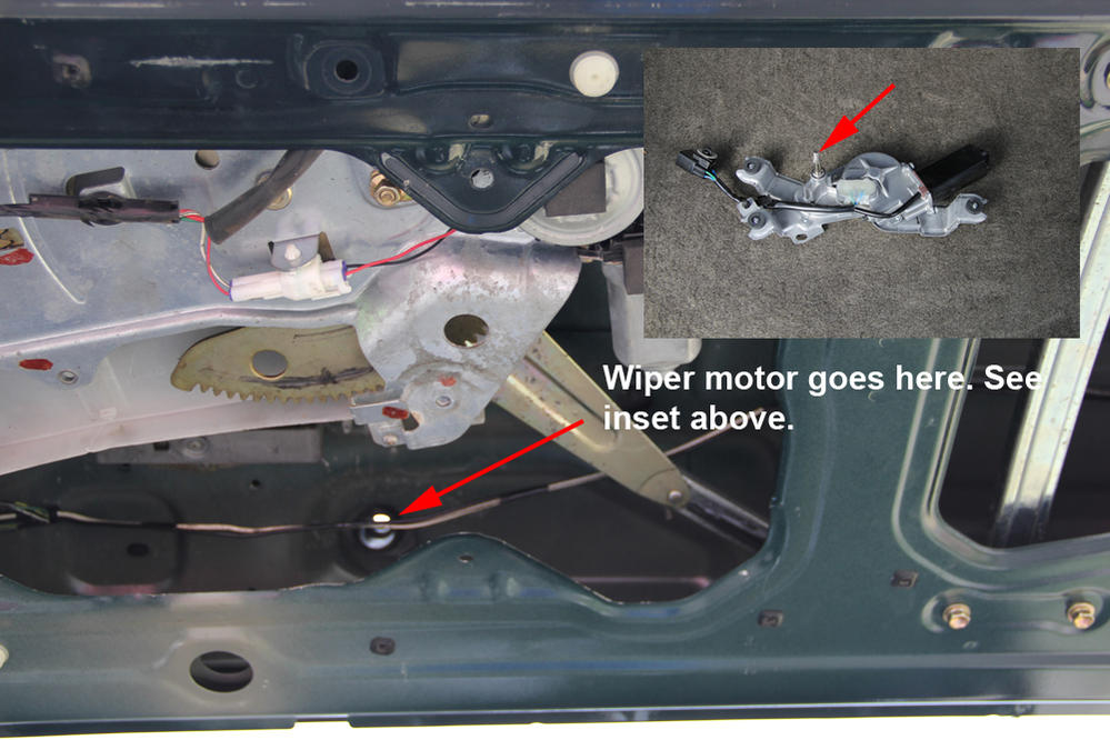

I can't help you on the other items, but the wiper stud you're referring to is the actual wiper motor exiting the rear lift gate. The stud goes through a rubber grommet. I can assure you, wiper motors are NOT fun to replace. It's attached with three shock-mounted bolts. Here'a pic.
EDIT: If you remove your interior panel from your lift gate, you may be able to see how the spray nozzle and wiper rest are attached. I think there's just one bolt where the strap is and the rest are the white push in style interior molding fasteners. Once disconnected, it slides UP away from the window track.
