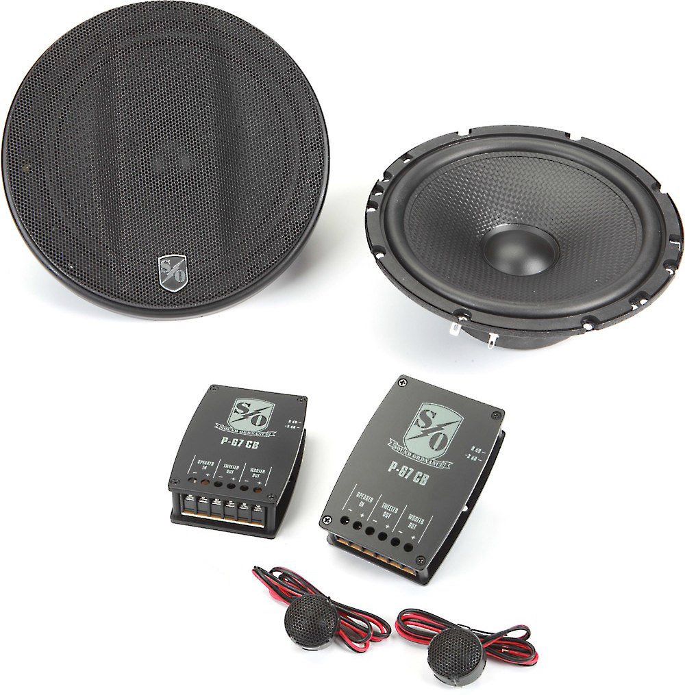

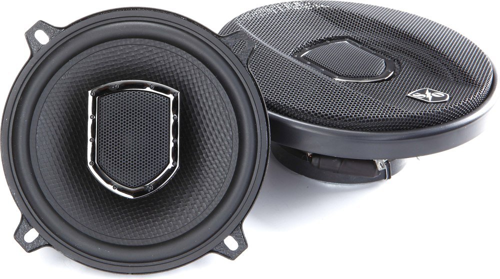

Y'all think these will fit and sound decent?
If your gonna buy Sound Ord just get it from Crutchfield directly. They'll match Amazons price and give you free install gear and guides. The link for the amp isn't working for me but I looked up the specs and it's plenty to drive the speakers your looking at.
Odly, Crutchfield is the Amazon seller. Same price as on their site direct.
EDIT: fixed the amp link
