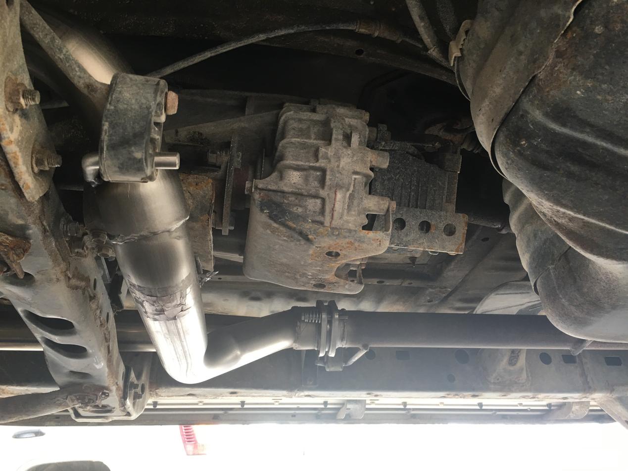

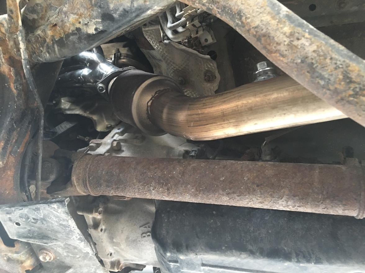

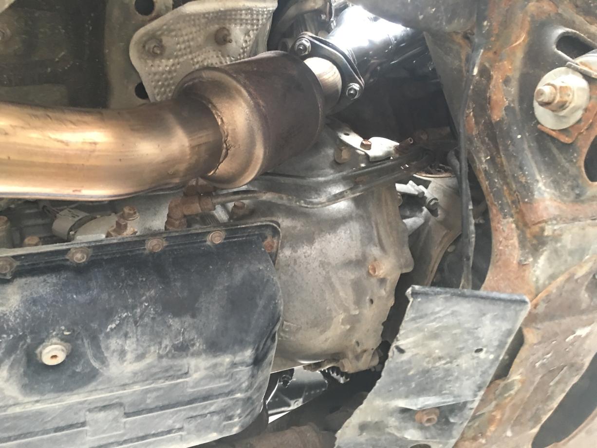

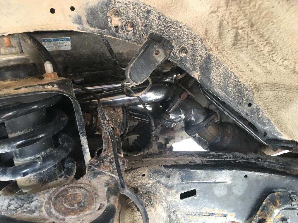

I have added two rear O2 spacers to get rid of the CEL and it has passed emissions test twice with this setup.
Here you go
These are great pics. There should be two O2 sensors - the one before the Cat but on the headers (can't see them) are AFR sensors used by the ECU for fuel management. The second O2 sensor after the Cat is the O2 sensor for tripping P0420 and P0430. It's interesting that you aren't getting either of these two codes w/o sims. That's a head scratcher.
I'd like to look into the MAF calibrator. Is this an URD thing or from some other vendor?
Not really, he's got cats welded in before the rear O2 sensors so they are still reading close enough to not trip a fault.
Mine with no cats before the rear O2's will log a 420 and 430 everytime until I put 3 spacers on each O2 sensor.
Thanks for the input. However, one of my point is that the front O2 sensor (aka AFR sensors) need to see the exhaust stream in it's "raw" state for adjusting the air/fuel mixture. So, I'm curious, if putting the AFR after the first set of cats is detrimental for the ECU. Again, just trying to learn not arguing/debating. This is good stuff.
Front O2/AFR sensor bungs are in the DT headers so they WILL be ahead of the cats in the raw stream whether you add cats on or not after that is up to you. The rear O2's are only for "header catalyst" efficiency checks and have no impact on performance. It's the rear O2 that the URD emulator plugs into so that you don't get faults for reassembling without upstream cats, or just space them out of the stream. There is also on my 4r two more catalysts behind the rear O2's (I think this was a 50 state emissions version) there is nothing to monitor their performance or presence.
