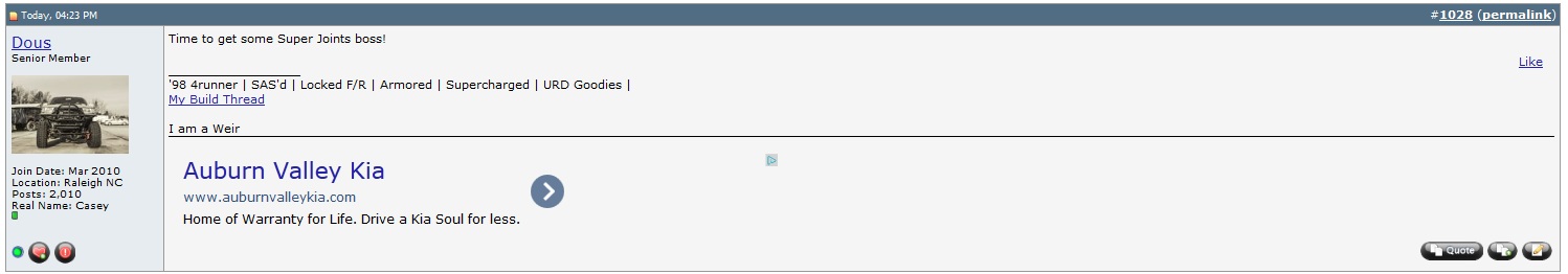

Apparently Dous is now a rep for KIA's, ha
Even better, a hamster driving KIA SOUL!
