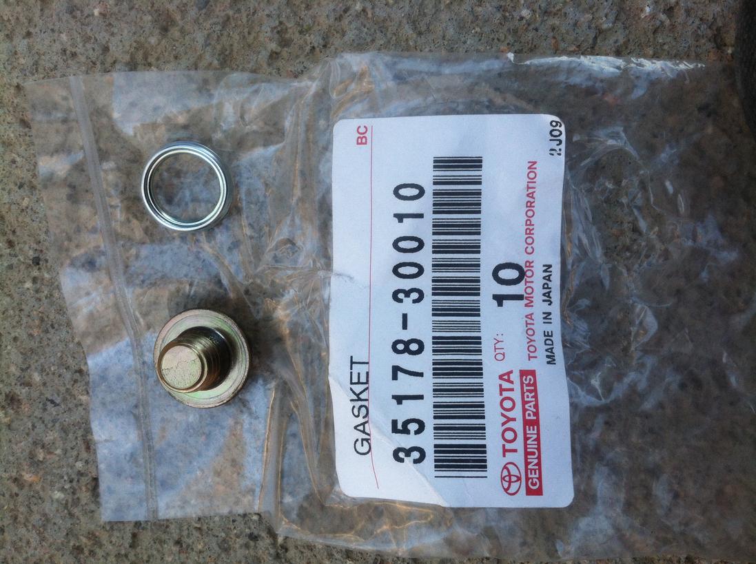

I just finished draining my trans about 2qts came out but before I put the plug the sales man told me put this gasket is this correct?

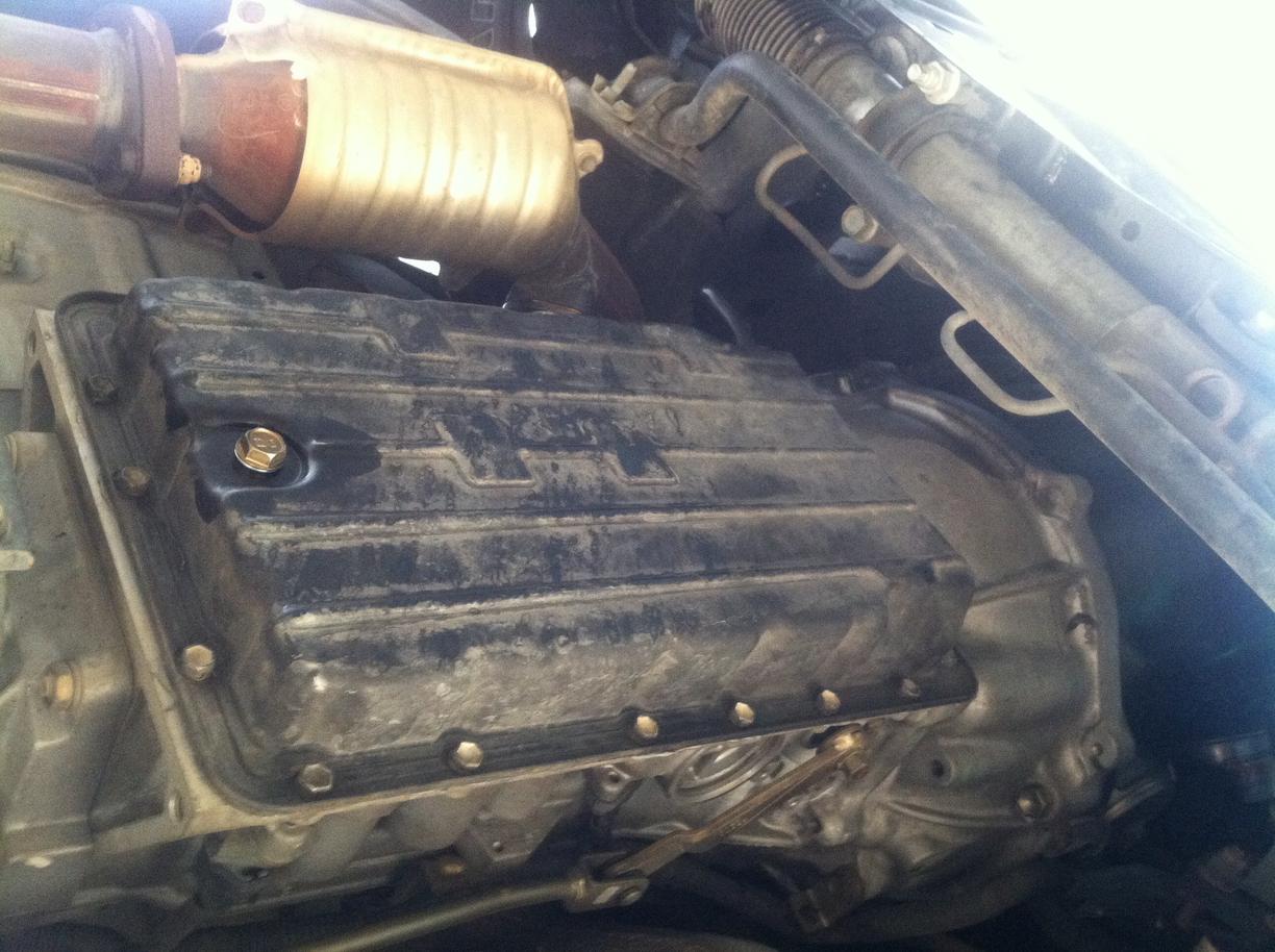

normally 4 qts will drain from the drain pan. there about 8 quarts inside the transmission, but you can only change those with a transmission flush. there are several threads about it in the FAQ

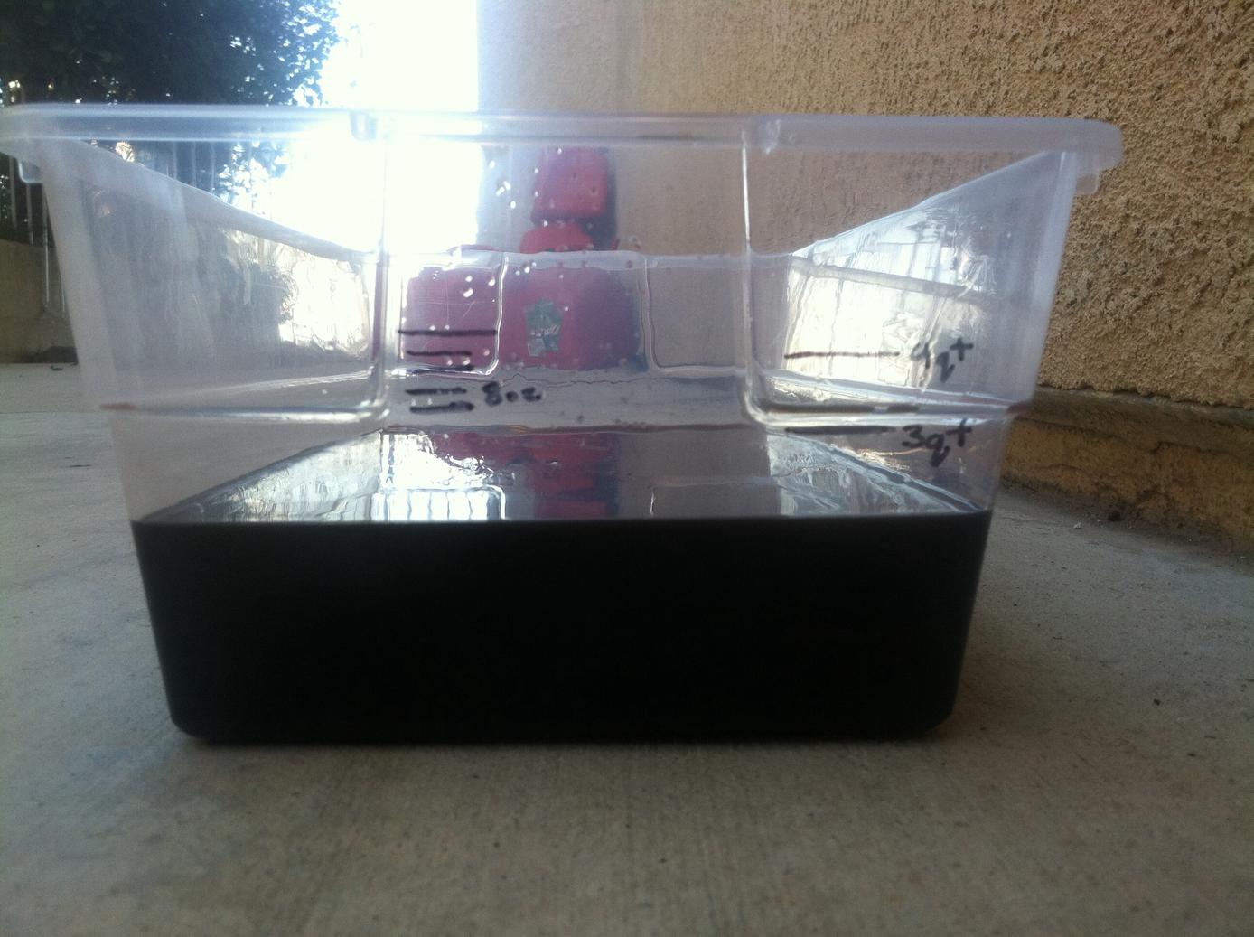

Well unless I measured wrong this is only what came out just a little over 2qt
So I only put 2qt back in. Yeah cause I've read on here that whatever you take out thats what you put back.
