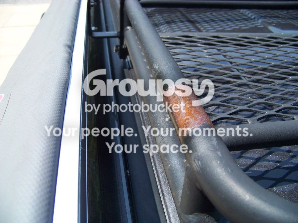

Well, my CB blew up.
Totally my fault though! From putting the antenna up and down so much, the cable frayed and grounded itself out. Water had been getting into the cable too because when I cut it everything inside was corroded to hell.
I decided to fix it, and then I remembered that I had a No-Ground Plane antenna (NGP). You cannot alter the cable length, not even 1/2". Then I noticed the rust on the rack.:scared:
