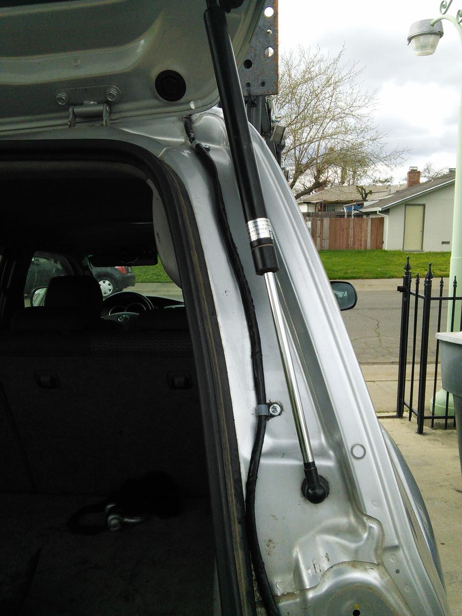

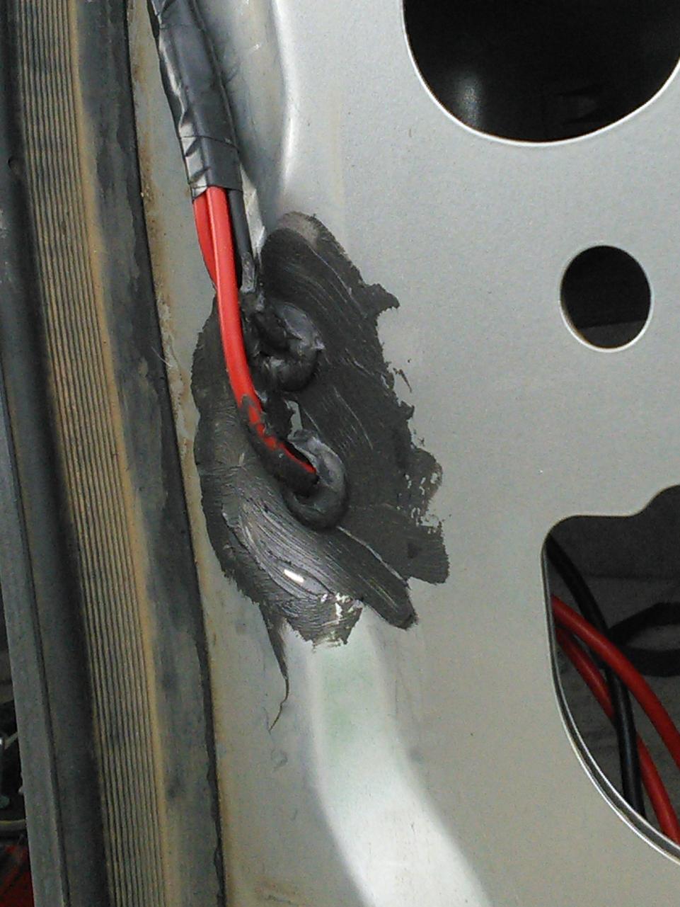

Edit... This was the latest hole punching. Wires coming in through both tail light walls, and self tappers to secure the wires from movement and rubbing.
  • 146858d1424572693-what-did-you-do-your-4runner-today-img_20150221_164658~3.jpg
  • 146856d1424572661-what-did-you-do-your-4runner-today-img_20150221_164624~2.jpg

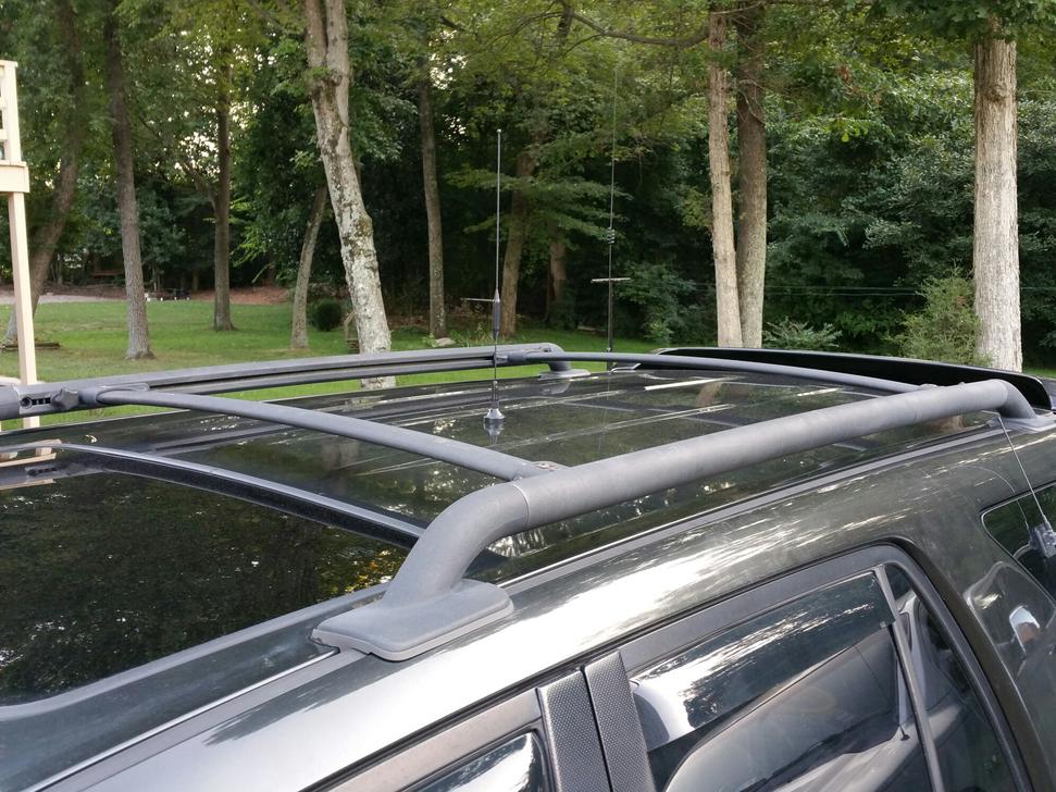

Finally got around to doing one through-roof NMO mount. Sorry I didn't get a chance to grab any pics or do a write-up, but I plan on putting another one behind it soon, so hopefully I'll be able to take my time and get some pics. I'm using NMO mounts that actually only require a 3/8" hole instead of the standard 3/4" hole. Just used a standard step drill to punch the hole... went pretty well. It's all the extra work like taking off the interior panels and dropping the headliner that's a pain... plus with my truck having the sunroof, it kind of limits the space I can use to mount antennas.
