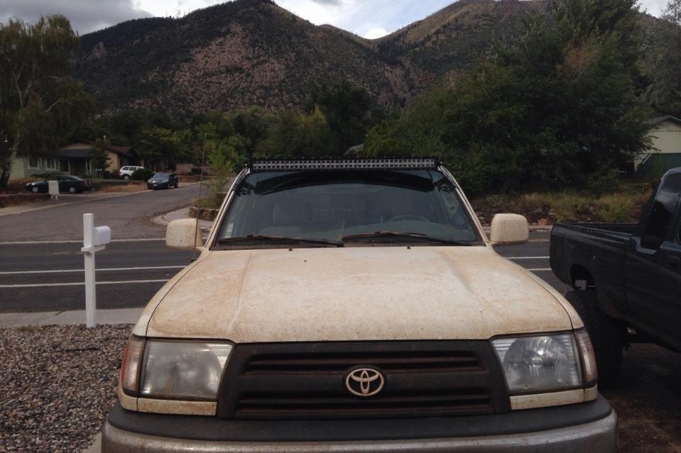

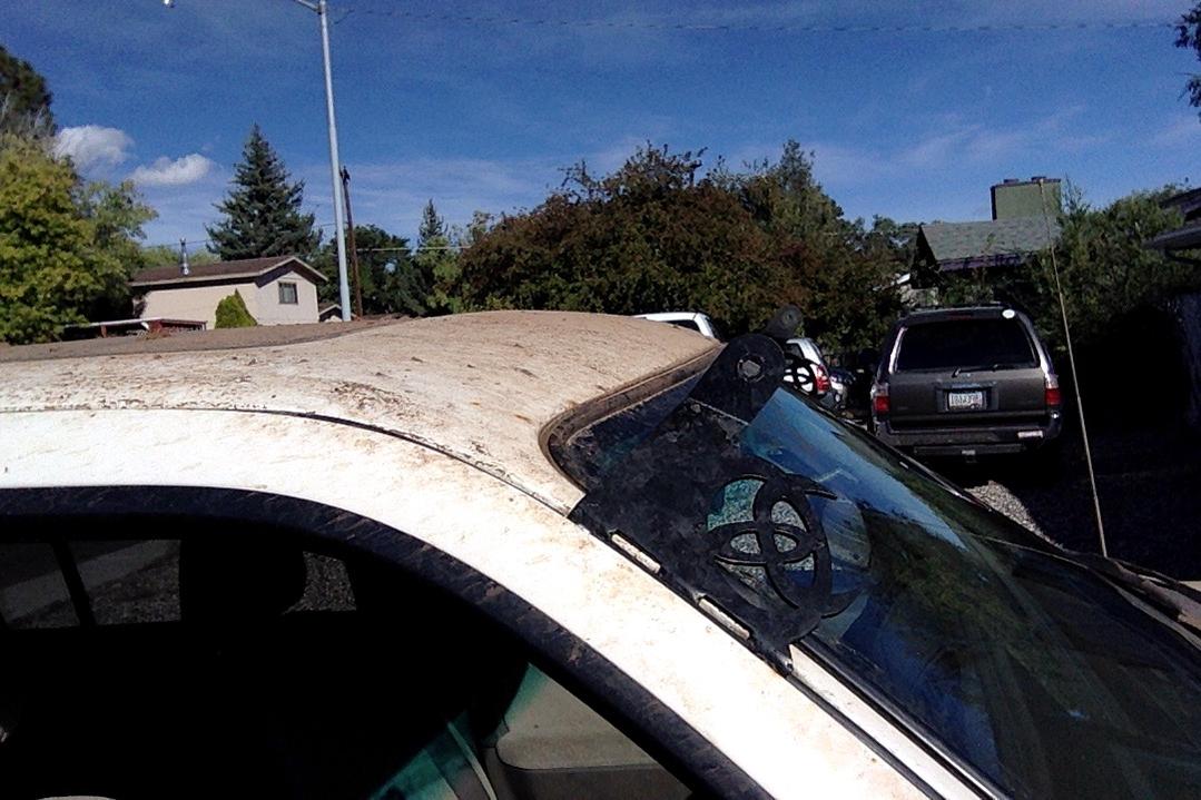

Sounds a good placement, got some pics?

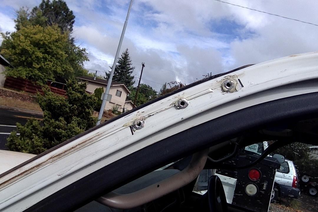

It's a pretty rough install but not bad for a kid with a drill while its pouring rain. I just used rivets but had to gorilla glue them to keep them from spinning, the holes on the drivers side are way too big so i'm gonna weld them in today.

What kind of rivets did you use? Did you not use the correct drill size for them?
You might have some trouble with tacking them in place depending on what those rivets are made from...

I used 1/4 inch aluminium rivets for the passenger side and had to use 5/16 inch rivets for the drivers side since the holes were too big. I was going to weld in steel rivets but i figured i'd give aluminium a try, it started to melt right through it cause it was too hot but i eventually was able to put in a few tacs.

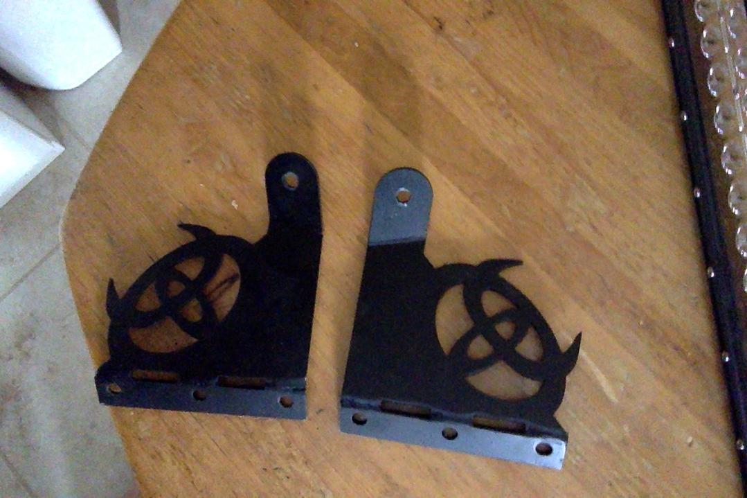

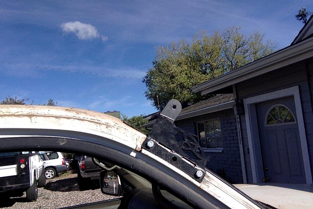

Looks good, a side close up of the mount would be nice.
And where did you get the custom mounts? They are bad ass!

Those tacks won't hold well... Aluminium to Steel doesn't weld very well at all.
Why not use RivNuts? I don't mean to sound rude, but that sounds like a very questionable installation for such a heavy item.

sorry, I usually just call rivnuts "rivets" out of laziness. I did actually use rivnuts, and the only reason i tacked it on was so that it would stop spinning and i could get it to collapse and catch, it's not solely being held on by the weld. I took it for a test drive the other night and the mounts are solid, when i try to wiggle them by hand the whole truck rocks.
I bought them from a friend a few days ago and i'm not sure where he got them, i found a page on instagram that makes nearly identical mounts for 150 a pair, although i forgot what it was called.

not the greatest quality but you get the idea
