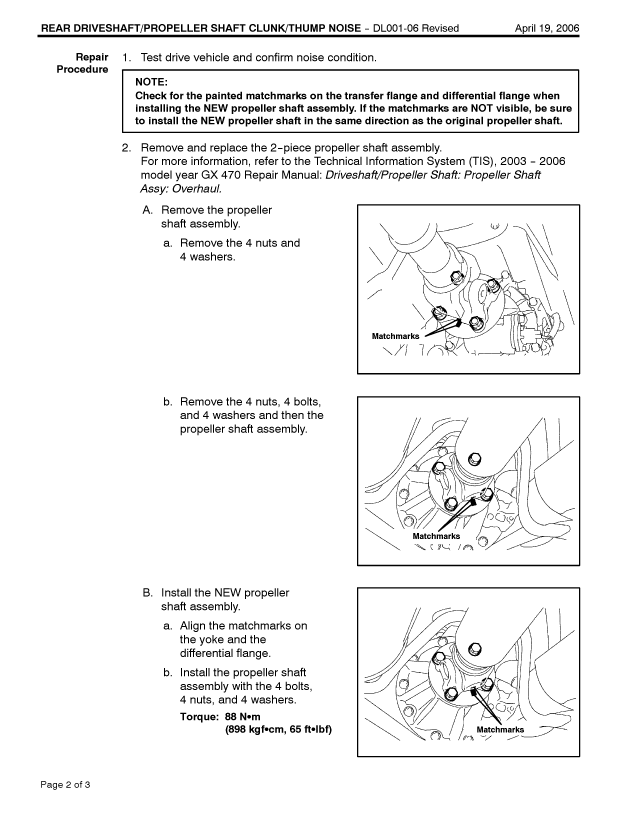

Hey all, I bought an '06 SE V8 this past May and after experiencing the "thunk" first hand I came across this thread. Thanks to all for an informative thread. It helped alot. As a result, I took my Runner in to my dealer (John Elway in Denver) to have them look at it. A few hours later they called me and said that they had reproduced the problem (imagine my shock when I heard that) and that they had ordered a new rear drive shaft and will be replacing it with no questions asked (almost had a heart attack after that). I mentioned to the service manager that there was a TSB for the GX470 and he said that those were the parts that he ordered. So, the new parts will be in and replaced next week. I'll keep you posted to let you know if the problem goes away.

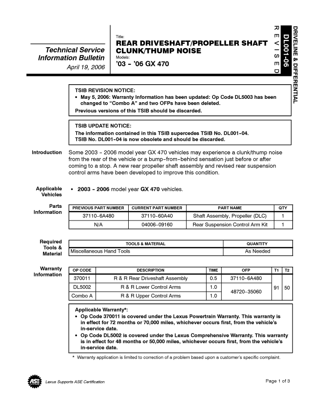

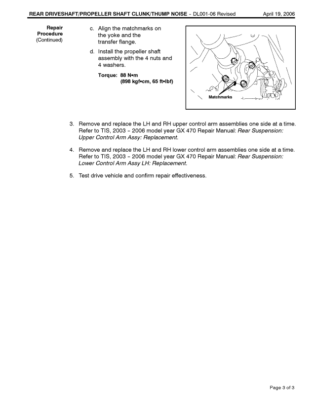

Just make sure they're going to do the FULL Lexus TSB, which includes replacement of the rear control arms. Other 4Runner owners have mentioned warranty replacements of their driveshafts, but it didn't fully solve this problem. Only the Lexus TSB (new driveshaft and new rear control arms) seems to be the definitive fix, so clarify with your dealer before you get only half of the repairs needed.

Agree...in addition, make sure that your dealer has the LATEST Lexus TSB...previous TSBs did NOT solve the problem.
Lexus TSB
Here's copies of the Lexus TSB for anyone who wants to print and take them to Toyota...
