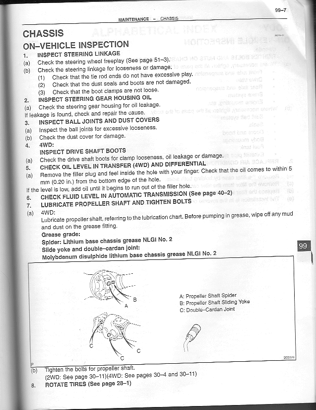

Gang,
I attached a pic of what my 03 repair manual says to do about servicing the driveshaft with grease. It also shows where and tells what to put in it. Evidently, you need two types of grease, a moly lithium grease and a regular lithium grease.
I ordered some moly grease and regular lithium grease as well as a grease gun online from aubuchon hardware and it should arrive this week. My dad also found the same stuff at Napa back in the States.
I hope this helps you all. I'll let you know how this goes.
Jon

I would like to lube the joints myself but I need to know what kind of grease gun should I buy to do the lube job to the 4runner and the kind of grease I should buy to get rid of the clunk.Are the joints close to the back? I understand there are two types grease, I don't want to use the wrong grease. I am so happy with this forum, I has given me so much information and enlighten me about my 4runner.
