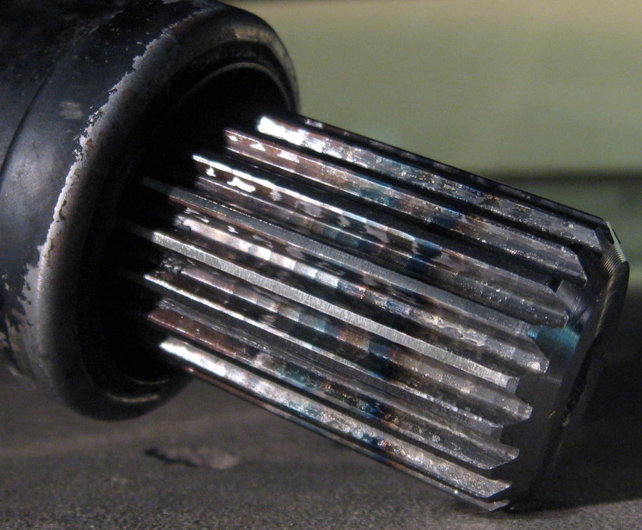

I took my driveshaft apart, cleaned it, greased it and reassembled. The clunk came back almost immediately, although it's not quite as harsh as it was before. I need to find a real fix.
These splines don't look so good...
