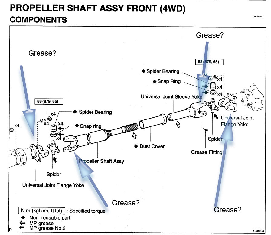

I marked the components that I should be greasing. How many grease fittings should I be looking for?
I marked the spots where you should lube with red dots. Remember to do both the front and rear shafts. Alo remember to use moly lithium grease for the slip joints and lithium grease for the u joints.
Here is a great write up on a 3rd Gen http://www.4runners.org/articles/zerk/
remember the 4th gen is the same apart from the fact that we dont have the double cardian joint. Also the tyopes of grease specified in the write up is the correct ones. If you can get synthetic grease, especially for the u-joints.
So basically there are three zerks or grease fittings I should be greasing according to your markings. The only thing that is confusing me is the kind of grease. I purchased two sticks of Valvoline DuraBlend DuraBlend which is a NGLI #2 Lithium grease but also fortified with Molydebnum Disulphide. Where can use this grease. I heard a guy at the Toyota tech forum using it for everything with no problems whatsoever. I think it would be better if I put the truck on stands so that I can move the drive shaft.
