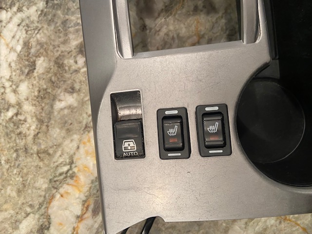

I know you got it fixed, but just so you know, there are other options than Toyota’s $120 switch:
Motosupply A Pair Rectangle Hi-Off-Low Seat Heater Switch Left and Right Heat Control Switch
Has anyone tried these? The rotary switches are annoyingly easy to turn on by accident and it might be worth the $20 to avoid the aggravation.
They came with my seat heater kit and they work great.
