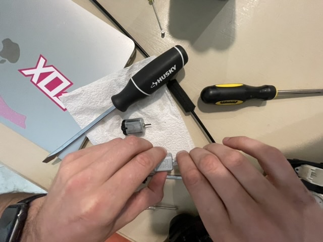

Well, I’m back to report as promised! Success! We replaced both front door lock actuator motors. Only took a couple hours to do both but I think I need to take the driver side out again. The key doesn’t work from the outside. When the actuator was taken apart, there seemed to be a piece that was out of place but we just left it but thinking back, I’m guessing that’s what is causing the key issue. Hmm...
Thank you so much for this write up and all the info. The links to the products and the videos were SO HELPFUL!
